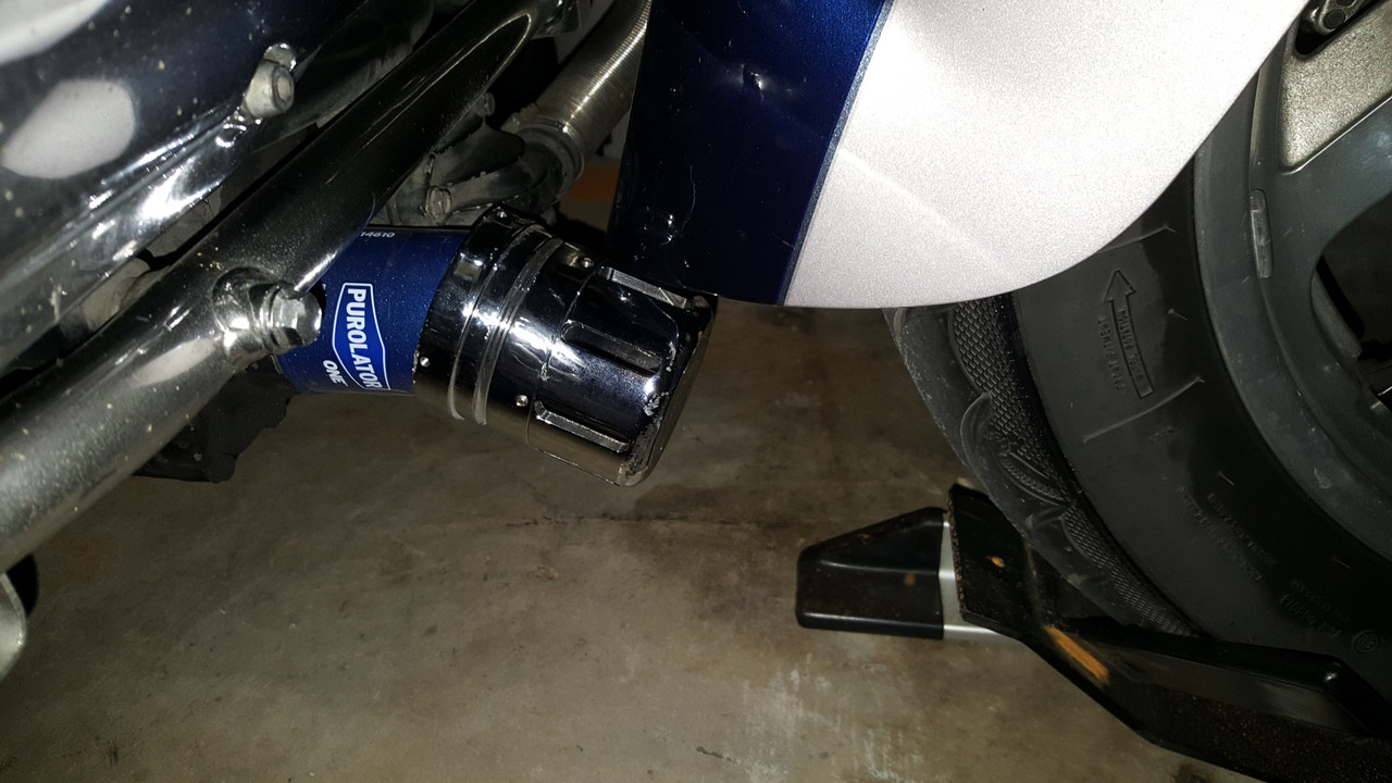

I just want to share a story about a very unusual experience I had a couple weeks ago while on a ride. I was following VRCC brethren Jerry Sheffer & Nick (Bronxboy) on the way back from a great ride to eat in Inverness. Thank goodness we were on a back road between Brooksville & Floral City in West Central Florida for those of you that know the area. We had come to a stop sign and made a right turn. When I reached 45-50 mph I felt a slight bump, heard a loud pop, then saw something chrome about the size of a coffee cup shoot out the front of my bike & off the left side of the road in front of me. I immediately stopped & went looking for the projectile. I found my chrome plated aluminum oil filter cover in the ditch. I looked at my filter, radiator hose, brake calipers and brake hoses. All looked fine with no visible damage or fluid leaking. As we resumed our ride home I could hear a slight whistling sound that was new. After 10-12 miles Nick & I pulled into the gas station & looked the front of my bike over good. The chrome filter cover must have come loose, slid forward & contacted the front tire before falling to the ground. The tire pulled it between the tire & the fender then spit it out the front of the fender like a slingshot. It destroyed ONLY the front fender. I feel very fortunate that it didn't blow the tire, lock up the tire, or destroy the oil filter, dumping my oil right in front of my rear tire. Evidently the 3 set screws which secure the cover to the filter became loose allowing the cover to become loose on the filter. The whistling sound was the tire rubbing the right front former of the fender where it pulled inward due to being deformed by bending to allow the filter to pass between he tire & fender. I bent it out with a wrench & it no longer rubs. If you use a filter cover please check your screws or add an adhesive for additional security.

Holy crap, that is one extremely unusual and unfortunate episode.
How does it come off, then bounce forward into the tire, and how does it actually make it all the way round inside the fender?   Have you closely checked out the tire too?
I have a Cobra cover that snugs on the block, and an old style Hog shock cover that snugs on the filter itself.  I've never checked them for tight, but they've always been tight on 6-8K oil changes.

« Reply #7 on: January 26, 2020, 05:09:15 PM »
I'm still having a hard time visualizing how it got up in there ?
Posts: 30975
« Reply #8 on: January 26, 2020, 05:35:48 PM »
When it came off, it had to bounce forward enough to get picked up by the spinning front tire, and lifted so the open or closed (narrowest) end of the cover was shoved up under the fender where the tire drug it around and out the front.  It went through end to end.  It could not have fitted up there sideways at it's wide point (it would have bounced off the fender and gone elsewhere).  It had to be a pretty tight fit, and the tire probably deformed a bit flat, and carried it through.  Residual dirt and road crud inside the fender acted as lube.
And remember, all front fenders have some rubber pad glued up under the fender, but that already came off one of my bikes.
I am thinking if there was no braking, then there was at least a throttle drop, enough to cause a perceptible slowing of forward speed, enough for inertia to initiate the last amount of (loose) forward filter cover movement, for it to come off the filter, hit the ground once, and bounce forward enough to get picked up by the spinning tire.
That or some kind of bump in the road made the suspension pitch it off, and forward.

Do you suppose if you had a fender extender it might of kept that from happening?  ???

On repair, I'm thinking new-used will be cheaper than trying to bump it out to correct again (with a bunch of filler).  You can always ride to a few shops for quotes.
Finding a nice blue and silver would be great (and hard to find), but otherwise new paint will be necessary either with a used or repaired fender.  And a pinstripe.
The old bullet decal isn't going to do it.
« Reply #12 on: January 26, 2020, 07:36:58 PM »
Nah just take the fender off and clear coat the way it is. The pattern it left is
Pretty cool.
Posts: 30975
« Reply #13 on: January 26, 2020, 08:08:38 PM »
OK, but since it's Florida a much better story than a filter cover would be running over a fat 15 foot long python, end to end.  With a big cat inside it.
Seriously, the pictures make it hard to see the extent of metal damage, except the big crease at the bottom.

The idea of a filter cover is not to add chrome, but to add protection to a thin-walled oil filter from a rock (or other) strike, sitting out there low in the front of the bike behind the wheel.  The cover in this post was pitched up under the fender, and pitching a hard object through the thin-wall filter is entirely possible. Even with a check valve, you would lose oil and have trouble.
Most of them are chrome, but that's not the main reason for one.
I would not use an equally thin-walled beer can which could also be penetrated, though it's better than nothing for adding strength to the filter.

I like the protection point of view as the oil filter is a little thin wall and exposed to all the elements. The SS kitchen shaker container from Meijer fits perfectly on the Bosch filter, the clamping method is my biggest drawback as far as the bling aspect of it. What happened to that front fender kinda scares the hell out of me as it could have been a worse case scenario.
