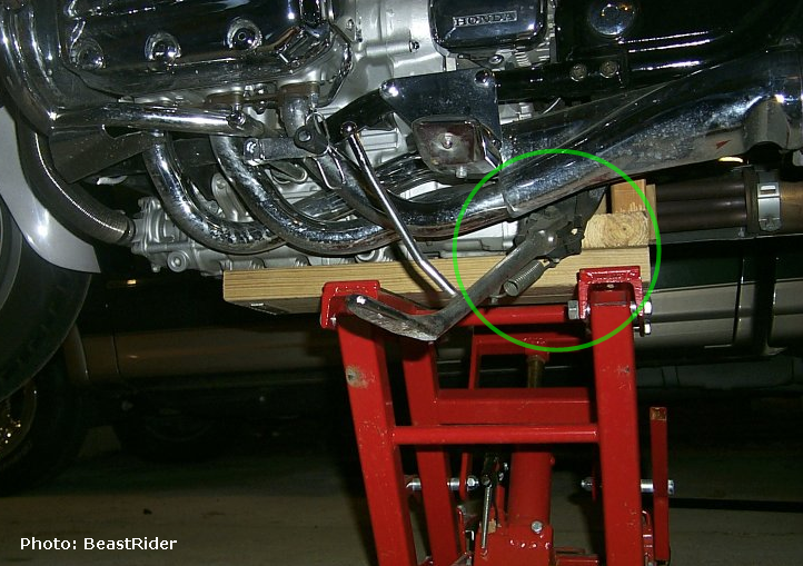

What's the best way to use a standard motorcycle jack to lift a '99 Interstate? Thanks, Coot

Hi Coot...
There's about three "easy to find" kinds of Valkyrie jack adapters.
I had one of these. It works great. I forgot and left it on there and almost
killed myself. Got rid of it.
https://www.ebay.com/itm/VALKYRIE-HONDA-ORIG-RIVCO-JACK-ADAPTER-PROVEN-TO-SAVE-YOU-MONEY-100S-SOLD/170854771001?hash=item27c7bce939:g:BFQAAOSwhcJWPUNx
Then I got one of these "stays on bike" adapters. You have to be finicky about
exact placement of your jack to avoid jacking your bike up on the headers
and to jack up the rear versus the front, but I like it fine, been using it for years.
https://www.ebay.com/itm/VALKYRIE-HONDA-LIFT-JACK-ADAPTER-NEW-1-MUST-HAVE-MOTORCYCLE-ITEM-Save/170943480226?hash=item27cd0681a2:g:m8YAAOSw9mFWJFI5
MarkT (a site sponsor) makes a "stays on bike" adapter, I bet his is good.
There's plans to make a wooden adapter that also works well...
http://www.herberts.org/wayne/valk/lowtechlift.htm

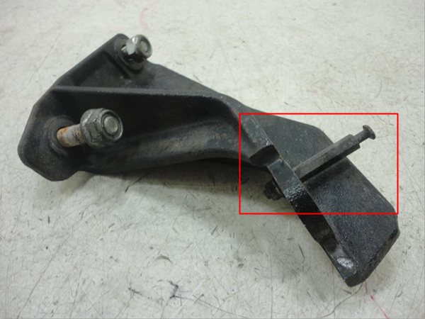

Btw, the best way *not* to mount the bike is to let the lift adapter hit the bolt for the kickstand spring. Real pita to replace and a broken spring bolt is a potential hazard. It doesn't break off right away either. The fissue gradually grows larger until the bolt breaks off and you join the club.

I use a Larin lift for my Tourer. I use a 3/4 inch thick piece of wood on the rear support and position that rear support under the rear of the engine. Lifts the bike up level and stable. Then once in position i strap the bike to the lift.
If I want the front up more then the rear than no piece of wood. simple and easy both ways.
