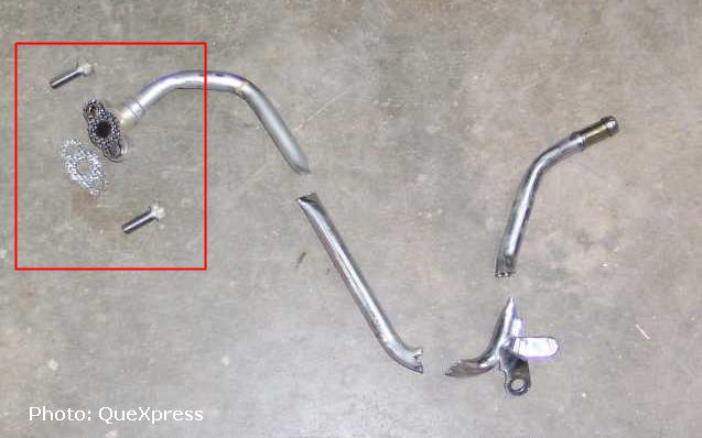

I got off work early today and pulled the tank back off. Finding out that you can spin the tubes was a real help, lol. I had 3 that weren't on very good. Got them all squared away and got everything back together. Fired her up and at first I didn't think it helped much. Still seemed a little sluggish so even though it's chilly and the roads are wet, I took it out. It seemed the longer I rode and got on it some, it was running better. (I put new spark plugs in it last week too) It was stored with Stabil in the tank like I've done for 20 years. When I did the desmog, my #1 air tube and the #2 air tube were both pretty much plugged solid. I should mention that it's a '98 Standard with 160,000 miles. Before I left, I dumped some Sea Foam in the tank and I've NEVER done that before. I rode for about a half hour or so and at the end it seemed to be running pretty good. A couple of questions I have are, were anyone else's air tubes plugged up like that? And did anyone else's bike sound A LOT different?  I have Cobra pipes, btw.

..... were anyone else's air tubes plugged up like that? And did anyone else's bike sound A LOT different?
If you mean the metal air tubes that attach to the underside of the cylinder bank, mines were almost completely gunked up. Like it needed draino to unclog.

Yup. Mine were a little worse, I think.   Undecided
