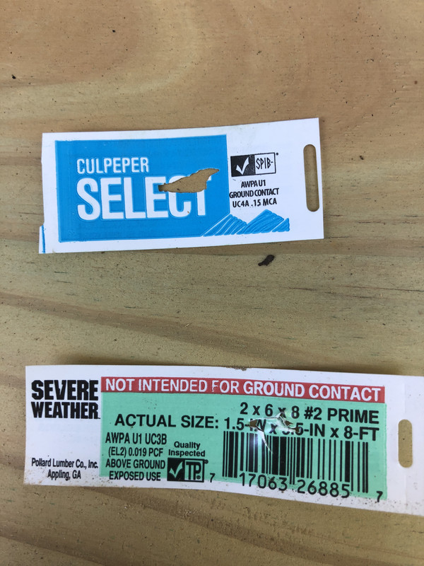

Don't have a Home Depot in my small town but have a Lowes.  All of the treated lumber in that store, with the exception of the 4x4s and 6x6s says not treated for ground contact.
If  remember correctly the labels are slightly different colors.  I have a couple labels and maybe one is off a 2x12.  I check again to make sure I was not mistaken.
I live in a smallish town, and we have a smallish Home Depot and smallish Lowes. None of Lowe's lumber
is treated for ground contact, other than the posts... I sometimes wonder if that is how they avoid

Ok,  checked some old tags from wood I used on my deck.
The wood purchased at Lowes is not rated for ground contact.  The wood I purchased at the local hardware store was "Prime Select".  Same basic dimensions but it is rated for ground contact.
I was not concerned about ground contact on the 2x6's for the porch decking but though the "select" might well be less likely to wrap and otherwise change dimensions.  Sort of but....
