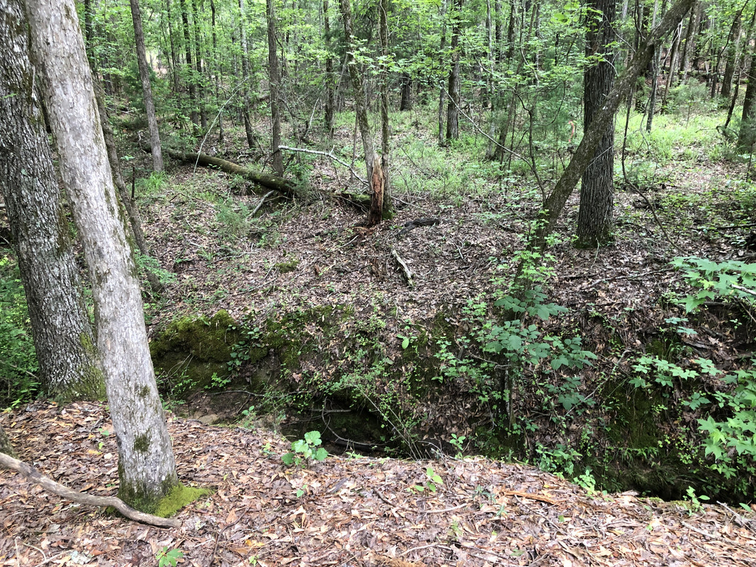

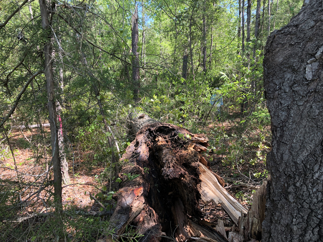

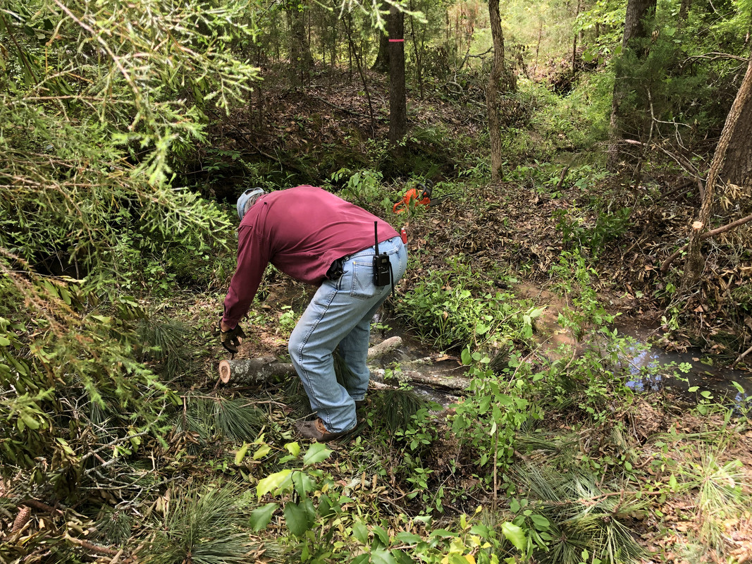

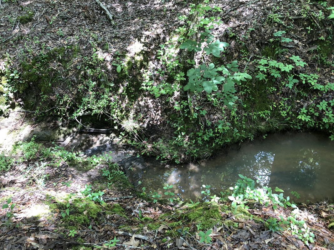

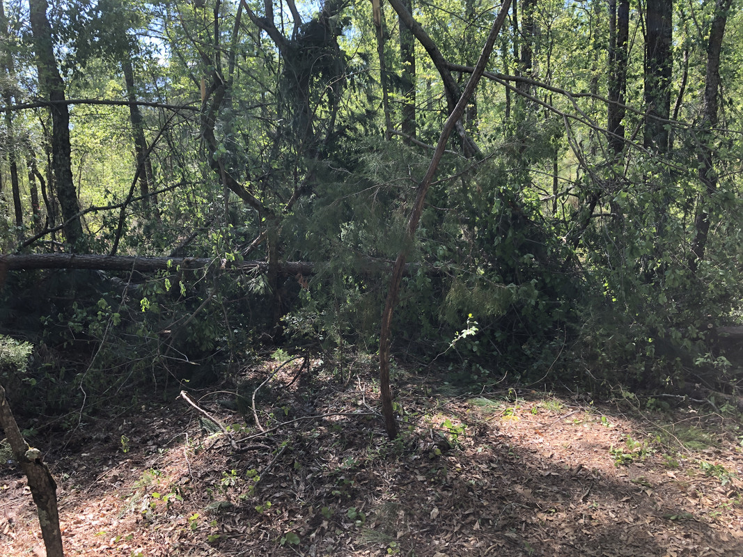

« Reply #12 on: May 29, 2020, 07:34:16 AM »
Regarding the tress and using them..  I will take a couple more pictures today to show the proposed location of the bridge.
And yes I have the chainsaw and the come along (well two actually depending on what distance needs to be spanned).  I sort of want to keep the trees as is.
A wind storm we had a month or so ago, felled several large oaks and a pine or two (casualties of the oaks being felled).
If you look to the left on the image above you will see an orange flag.  That marks the property line.  This tree was located on adjacent property by maybe 10 feet or so.  It fell onto my property.  Not a complaint just an observation.  I have similar trees that have felled due to wind on my property by the creek.
And after the image above after and during some cleanup.  This is the lower end of the creek where the banks are very low, about 300 feet from where I want the bridge.
« Last Edit: May 29, 2020, 07:40:37 AM by carolinarider09 » Logged

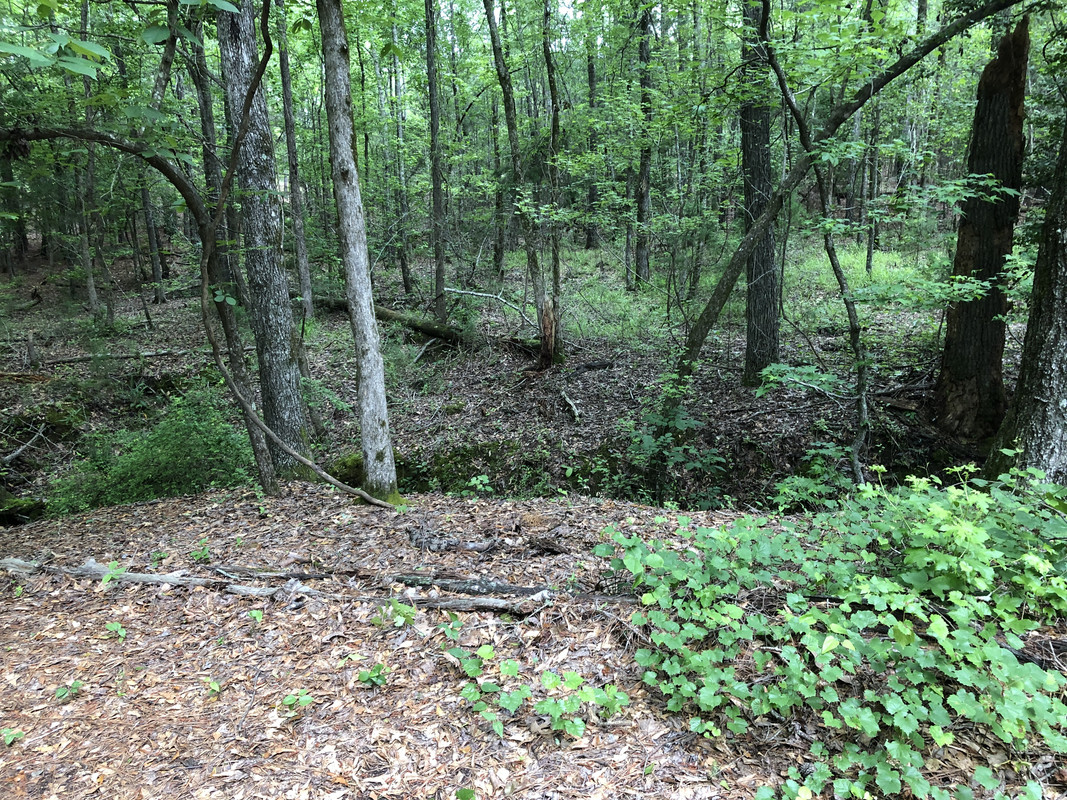

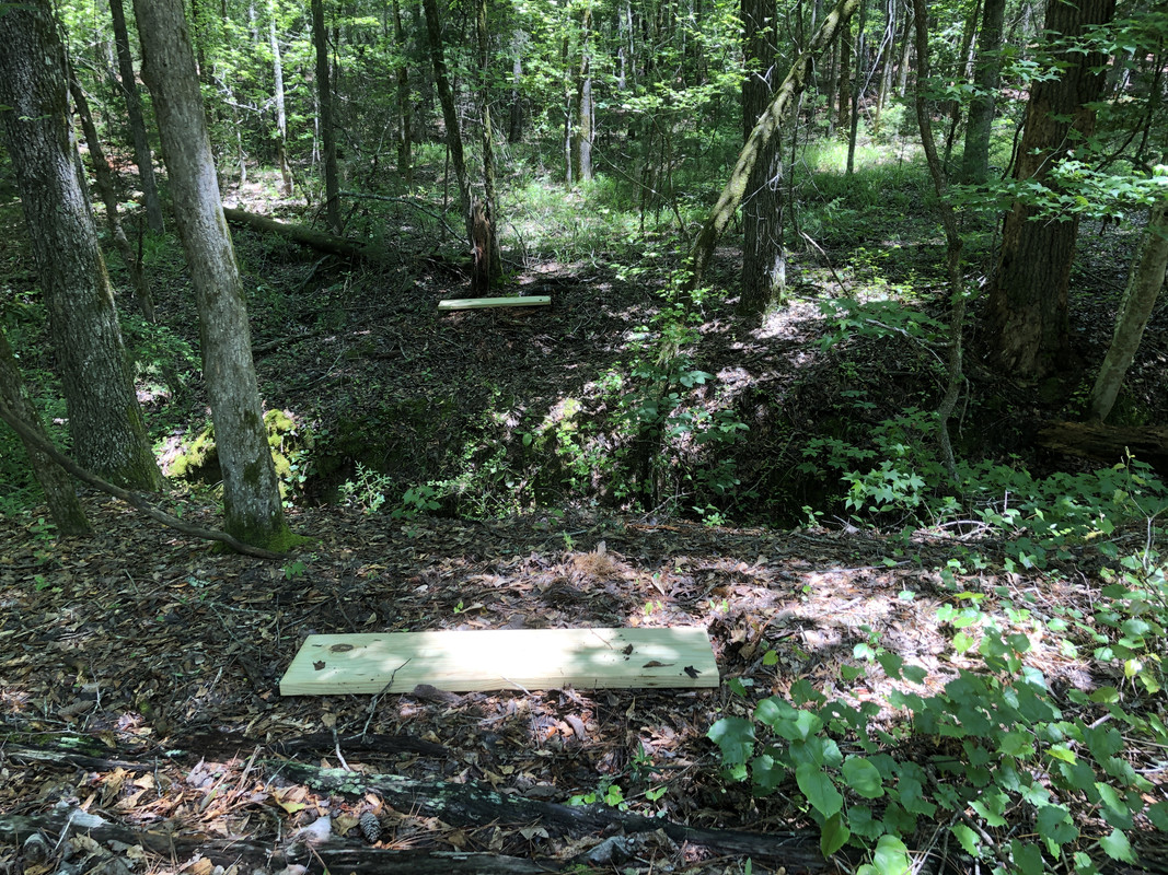

« Reply #13 on: May 29, 2020, 11:49:20 AM »
Here is what the proposed location looks like.  I looked around the area looking for support in the banks and clear areas on both sides with minimum possibility for trees falling on the bridge.
Looking down into the creek.
« Last Edit: May 29, 2020, 11:51:52 AM by carolinarider09 » Logged

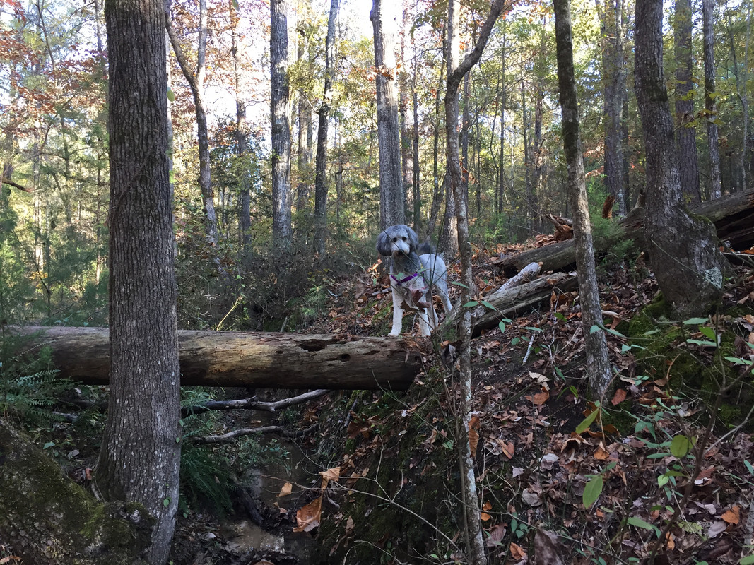

I shall keep the Wetlands Construction thing in mind.  But I wonder how they would feel about mother nature.
Zoe on a old pine across the creek.  By the way I call it a creek because, well just because.  I have walked across that tree many times but, when its wet with the wrong shoes its a bit slippery, and it is slowly rotting.

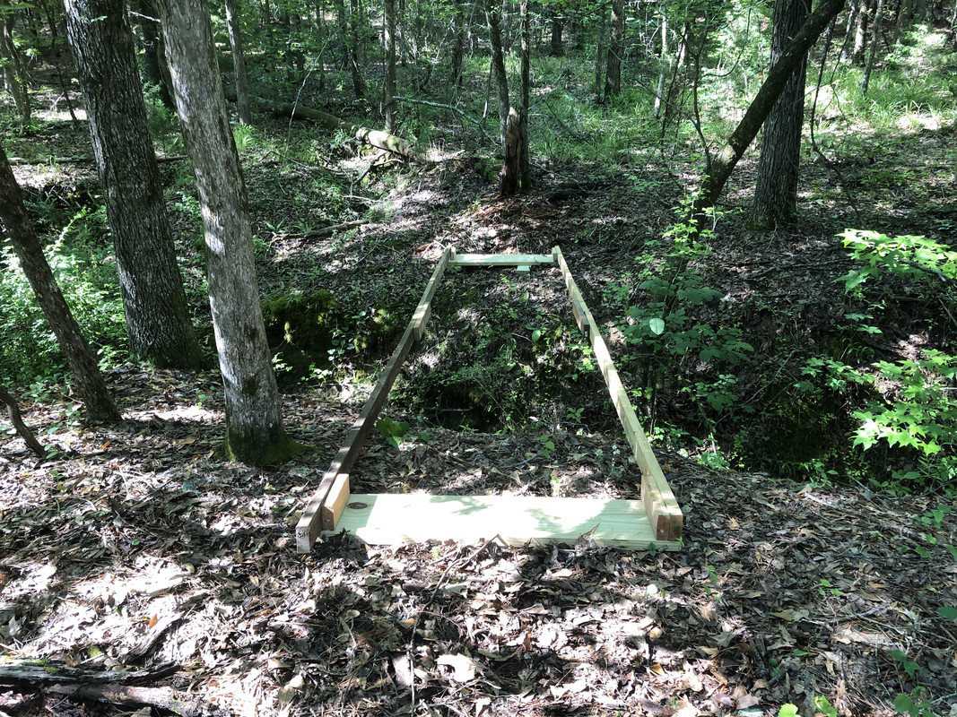

I am going to do some prototype work in the next few days to see what the layout will look like.  I have some 2x6 that I have set aside (was to be used in decking but they are too warped for my taste) and will see what the span might look like.  Just to get an idea of how it might all lay out.
Posts: 12585
« Reply #23 on: May 30, 2020, 11:10:57 AM »
Laid out a couple of 2x12's to see how it might look and the what the real span might be.  Anchoring landings will be an issue.  Thought about maybe burying some concrete blocks as landing points and filling the openings with cement for the anchor bolts.

Prototype just for planning purposes.  Its four feet short.  Used available materials just to see how it might work.

My neighbor Dan has a gully like that. He has always talked about cutting a
tree down to make a bridge over to the finger of land he has on the other side.
The other day I heard a bunch of chainsaw-big-tree-falling noises down
in the woods and I went down there. Dan and the kids were there making
the bridge.

I have no problem with the logs, and there is a large felled oak nearby.  The problem becomes moving the log.  I can try and use my tractor to drag it but it is unlikely it would be able to.
Its a 1998 MF1250.  Just the tractor no front end loader, while that would help....  I would still have to tow it over and then across and I can't get the tractor to the other side.
So, if we have another wind storm and a couple of trees are blown down right there across the creek, I'll use them.
Until then, while I like the 24 foot 8 X 8's, I still have to drag them down there and across.  Across is not  areal issue, but still a consideration.
What I am looking at now is the potential of using a laminated beam of 2 x 8's.  The only potential issue with them is that if I truly laminate them, the glue has to be absorbed by the wood which was be treated and probably still damp from the treatment.
If I did that I would use screws for initial assembly and then galvanized bolts for final support.
It has the advantage of being able to be built on site with 16 foot and 8 foot members.

...  What I am looking at now is the potential of using a laminated beam of 2 x 8's.  The only potential issue with them is that if I truly laminate them, the glue has to be absorbed by the wood which was be treated and probably still damp from the treatment.  ...
If you go this way, may I suggest glue, screw and clamp all the plys as you stack them. Try to avoid the joints lining up with one another.
Posts: 12585
« Reply #37 on: June 01, 2020, 03:09:31 PM »
Yes, I have used a tripod, pulley thing type arrangement for another project.  And I can anchor the pulley system to a tree, probably.
Regarding the plys/joints, my first thought was to simulate the 8x8 with 2x8's.  Since the maximum length would be 16 feet for each 2x8, I had thought to use a 2x8x16 for the center board and then fill in the 24'  length with a 2x8x4 on each end.
The rational is that the spot where the crossing is currently planned is about 16 feet from bank to bank.  So, on one side it might be in contact with the bank, but not the other side.
The logic is that I don't want the center of the span to have a joint except on tow of the five boards to be used.
