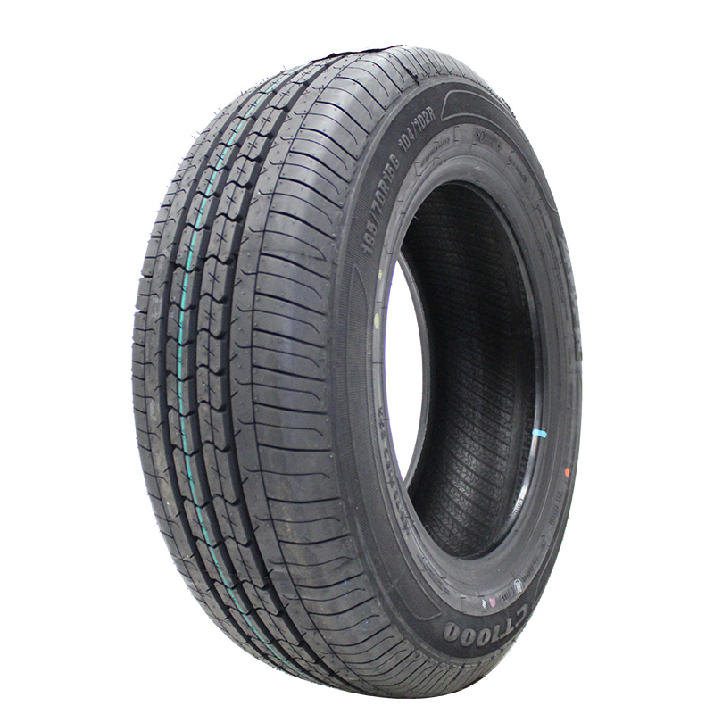

I just put on the Zeetec CT 1000 and love it, the bike seems to just float it's so smooth. Thanks Valkorado!!  cooldude and others for recommending this great tire.
Some observations:
- It tracks down the highway straighter
- Balance is easier when inching forward in traffic
- Two up twisties are a breeze, even a few 2nd gear super tight ones..
- The bike just 'feels' sturdier
- Slow speed ruts will pull the back end around slightly, but it doesn't bother me or feel unstable.. just different
- A little more counter-steering effort is required, not much, but it's there.
- Braking feels very solid
There are more, I'll just say I'm very pleased, and overall the bike feels 'safer', if that makes sense, just a feeling..
Anyway, that's my take on it FWIW  Smiley
