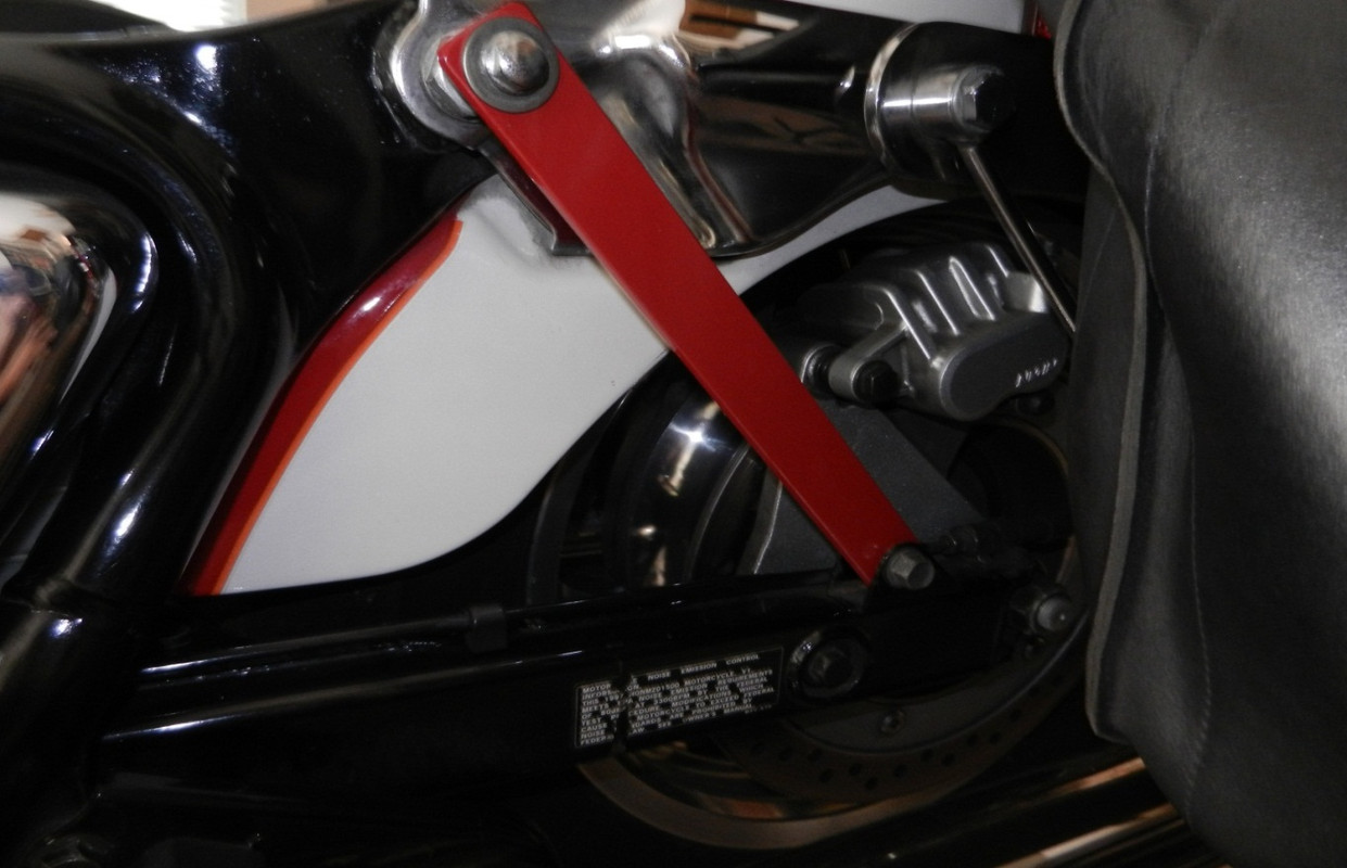

Is the thrust washer imperative? shipping is more then the washer!
There is no Honda motorsports dealer here in the town I live in but I can get OEM parts from the local power equipment dealer that sells Honda outboards and generators etc.  Their prices are the same as from the Motorsport dealer in the next town and the Honda online prices.  Big advantage as it is 3 minutes from my house and they often give a bit of a discount.
I have seen pics of guys using a turnbuckle in place of a shock or ratchet straps to lift the swingarm to get clearance to remove the axle with the exhaust in place.
« Last Edit: July 03, 2020, 10:09:23 AM by Madmike » Logged
Posts: 14898
« Reply #34 on: July 03, 2020, 01:26:27 PM »
Is this the correct bearing?
https://www.thebigbearingstore.com/5204-2rs-5204-zz-radial-ball-bearing-20x47x20-6/
And I would only need 1 for the left side? as the right side already has the double bearing right?
Turn buckles or just a flat piece of metal with two holes
