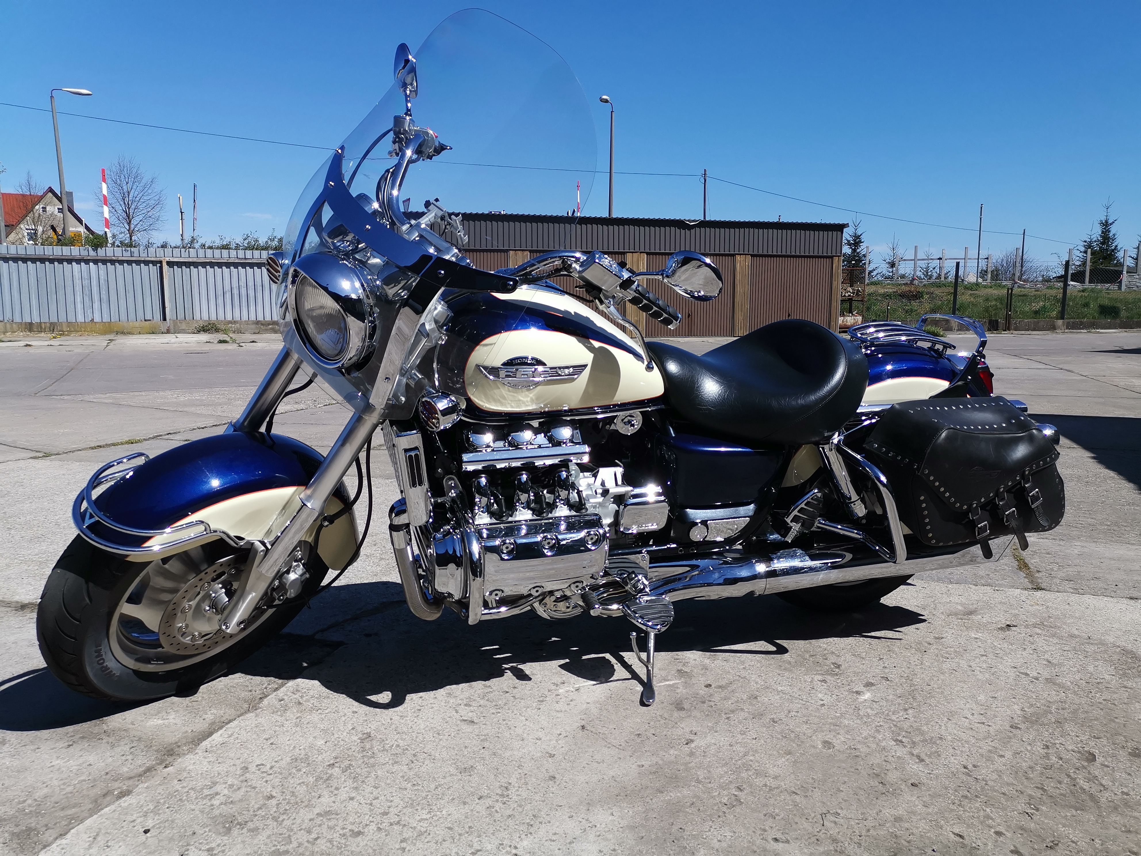

There's a button for currency choice below the price. $87,50 + $22,50 Shipping to US.
They are looking similar to the ones on my Phat Lady:
-mike-
Mike, can you do me a favor? Measure the distance these guards stick out from the mounting points.
I would appreciate it.
