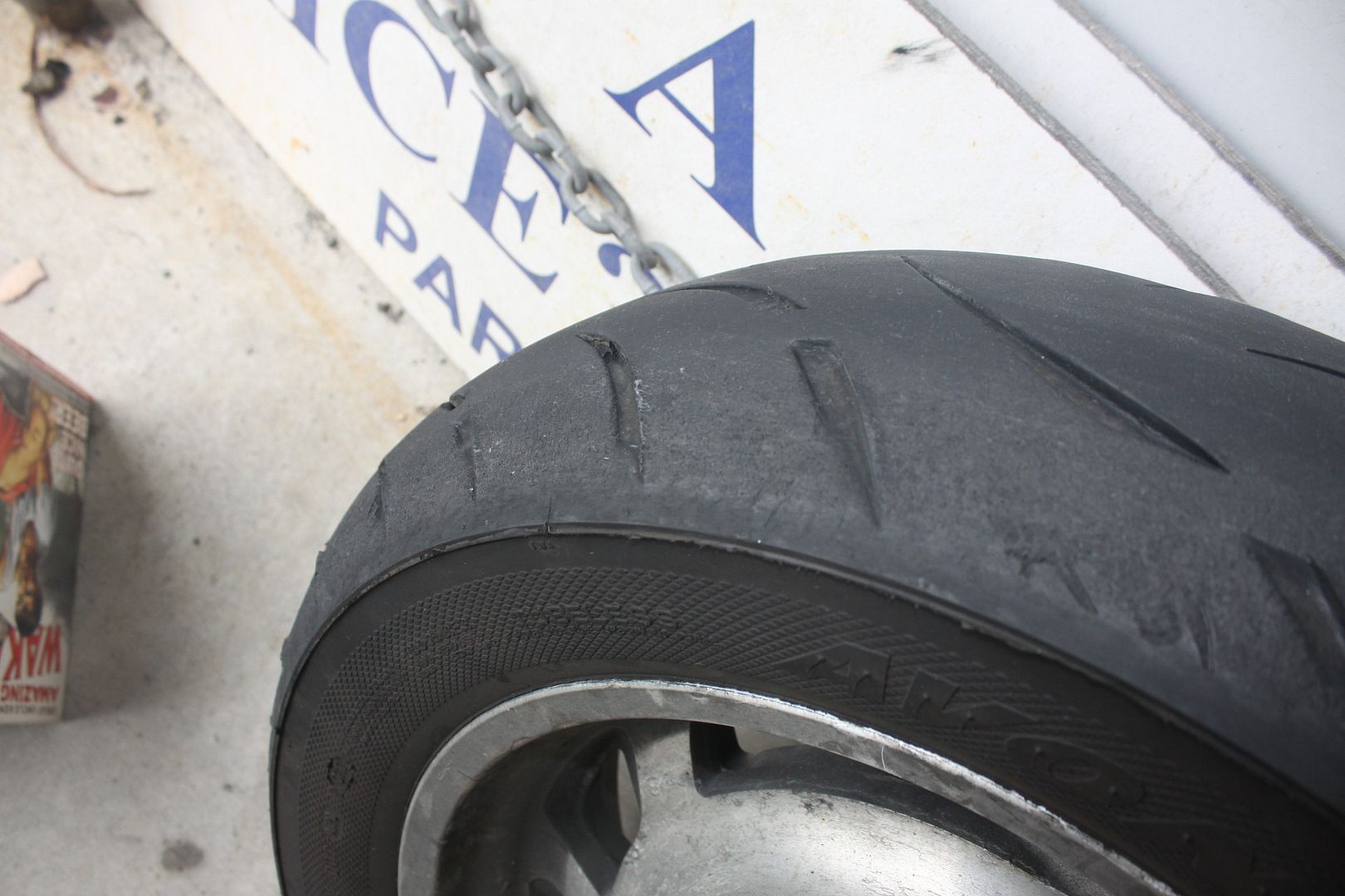

While I like the Avon Cobra I cut out the sides on the rear quite quick even at 42 PSI....feathers the edges. At some stage I will upgrade the suspension and that may help but for now its tire time again.... and I have friends running the Scorcher 32 on there big cruisers with good results but apparently mixing Radials and Bias Ply isn't a good idea & the Michelin Scorcher 32 front isn't available in 17
 Anyone running a front Bias ply, what size/brand
Before you say car tire for the rear.......that is not legal here in New Zealand
Typical tire wear I get (Less tread now)

I don't get cupping on the front, my issue is on the rear .... I have been told the sides are overheating hence the sides not lasting (most of the roads I ride are tight and twisty & I like to power through them) Suspension may take some of the heat out but until then I wanted to try a Bias on the rear, and apparently Bias rear & Radial front is not a good option..........hence looking at a Bias front
