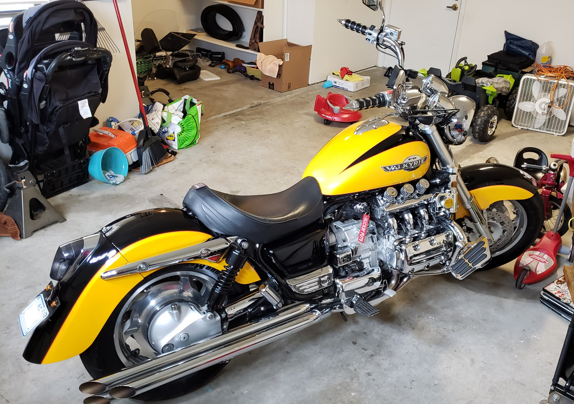

I got a deal I could not pass up on for this 97 with 18k miles. Within a couple of weeks that I've had her she already looks different. It recently died on me at half a tank and once I filled her up everything was perfect again. Any clue as to what would cause this? Thanks in advance.

I am even less (is that possible) mechanically inclined that Rams but....
Check if there is a fuel filter under the tank as they can cut fuel flow and also if there is a
kink in the gas line under the tank. These machines are gravity fed.
Nice Valk by the way and as a guy with big feet I like the highway boards
A clogged or kinked vent line could cause that.  Also if one has an inline filter with a line that doesn't go continually down it can develop a bubble and act that way.
Filling the tank increases the weight above the fuel line.  You can check for the plugged vent line by opening the gas cap and see if that fixes it.  Of course you may need two keys to do that.

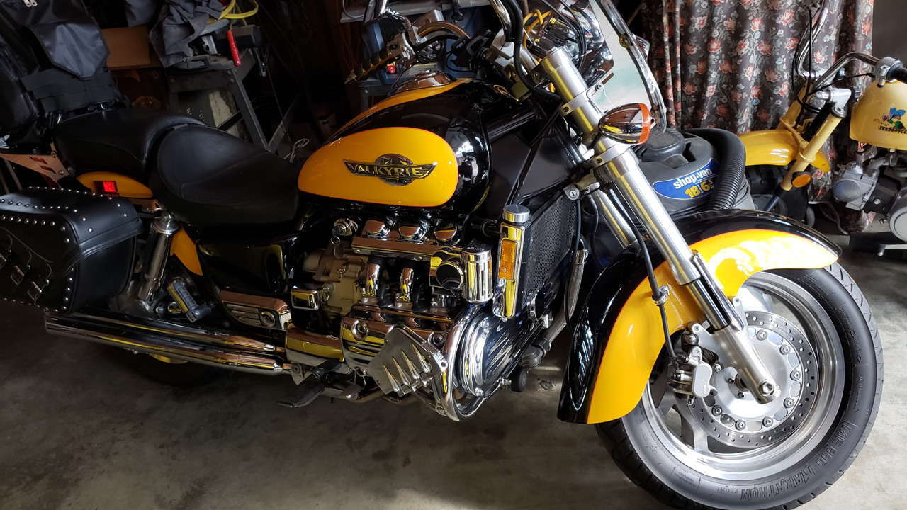

« Reply #6 on: August 03, 2020, 01:50:53 PM »
That's a clean bike and a good color  cooldude ... you got new shocks? What kind?
13 inch?

« Reply #7 on: August 03, 2020, 02:04:56 PM »
If this continues (for whatever reason) and you can't get it figured out right away, you can slip a thin ziptie in the gas hole and snap the lid closed on it, and that should stop it from not venting properly (building up a tank vacuum) while riding.
As a quick fix to get home or to the station when it acts like it's out of gas, but it's not.

« Reply #8 on: August 03, 2020, 02:07:30 PM »
I had that happen once. It was because I had the tank off to change air filter and when I put it back on it kinked the vent line. First clue when it quit was when I opened the tank cap and it made a woosh sound as air rushed in,,so I rode it home with the cap open and fixed it.
13 inch?
Welcome...
yes, new shocks and they're 11.5s. Got them from Ebay.

« Reply #11 on: August 03, 2020, 04:44:47 PM »
Great looking bike and welcome from Florida. I had that happen to me before when I had a tank off and it was a kinked fuel line , IN my case I shortened It 1/4 of an inch and no more problems.

« Reply #12 on: August 03, 2020, 05:21:36 PM »
+1 on the fuel line, also had that experience.  Welcome to the asylum!

« Reply #13 on: August 03, 2020, 05:27:31 PM »
I had that petcock issue and rebuilt the vacuum side of the petcock and replaced the vacuum line from #6 to the petcock. Just an FYI; The blacked out taillight lens is illegal in all 50 states as it’s a Fed DOT regulation.

« Reply #16 on: August 04, 2020, 05:04:48 AM »
Welcome. Nice bike!  As was said check for fuel line mods. They usually are the cause. Quick releases, extended lines, extra filters. If all is normal disconnect the fuel valve switch from the petcock and lift the back of the tank to see the vent line. If that’s not kinked then you probably have a bad petcock. Very common. I replaced mine with a Pingel and never worried again.

after reading up I feel like the pingle would be a good route.
Do what you think best but the symptoms you describe are easily fixed without investing in a new petcock.  If you do want to abandon the vacuum control the OEM can be converted to that but is not necessary.  If you do go to non-vacuum control you should add an electric fuel flow valve.

« Reply #22 on: August 04, 2020, 08:01:48 PM »
A small coin which you likely have on hand will do that too.
