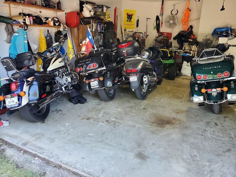

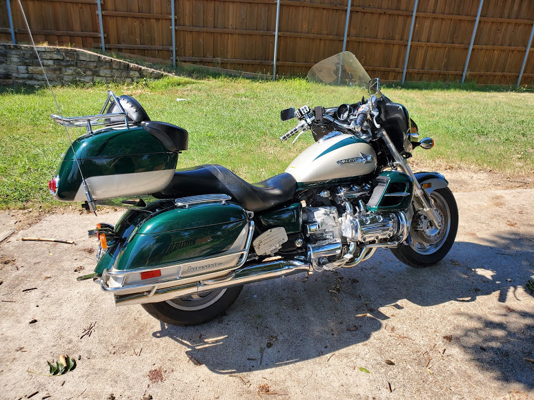

I just wanted to give a warning to folks with only one Valkyrie - it seems once you break the seal, they start breeding like rabbits (Or evidently 13 year olds, but we won't go there.)
I bought my original Valkyrie in 2000. That was my only Valkyrie for 18 years.
And then in 2018 I traded the spousal unit's never ridden ST1300 for 3FanForLife's black Interstate:
And now, as of today, it would seem that those two got busy in the garage and added Valkyie #3 to the stable:
Newborns (Even 21 year old ones) are so much work, I've gotta start farkling her, modifying her, (Registering, titling!) her, after I HOPEFULLY fix a minor problem with the clutch slave cylinder leaking... And then deciding if I need to keep 3 (I don't, says the wife) or not.....
Fun times!

That's an interesting pillion configuration.  It looks like an OEM saddle with an Ultimate passenger backrest.
It's also an interesting tie down.  I hope you never have to get good at trailering a Valkyrie.  Smiley
Because of a few issues I hope to take care of, the seller dropped the price to an embarrassingly low level, but one of his requests was the Ultimate seat setup was transferred to his new to him blue and ivory tourer (You and I know there was no such thing, but he has one, it's beautiful!) bike. Because the Ultimate Interstate passenger backrest had no place in his not a tourer tourer configuration, it stayed.....
Once I'm convinced this is "my" main Valk, my HartCo custom seat configuration will be moved over to it anyway.....
The tie down job, what you see was mostly the "Just in case" configuration. There were hard tie downs on the forward engine guards, rear guards and I learned my one lesson about towing a motorcycle - DO NOT have the kickstand down!!!. The other tie downs that were visible were mostly just to make me feel better.... Still I wasn't comfortable until I was in my driveway and had the new to me bike unloaded.....

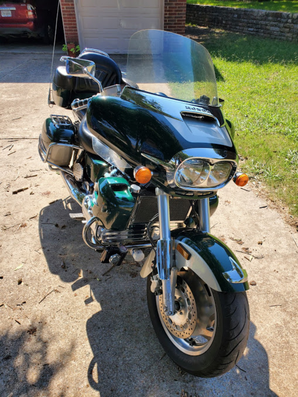

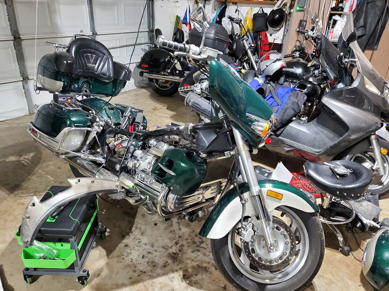

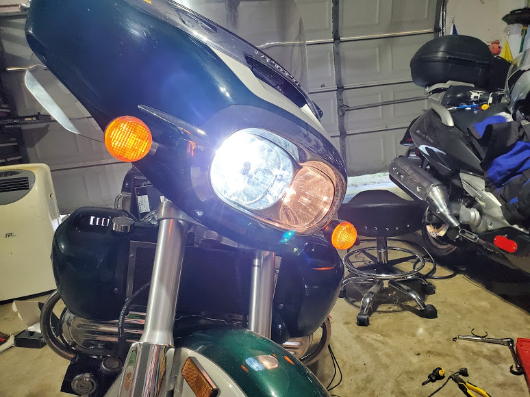

The joys of a 21 year old bike with an unknown history (Actually, I know more than most about the history from the previous owner, who only had it a brief time.)
I still haven't even been able to ride it yet, and now it's in pieces across my garage, waiting on parts to come in.... Fun fun fun!
I'm sure in her prime this bike was stunning (I mean, I know all Valks are, but even beyond that.) The original owner evidently liked green LEDs. There were hundreds of green LED's all OVER the bike. Most had stopped working, the wiring was flakey, some were just handling by their wire so I elected to trace them all down and remove 'em. Was kind of sad, like I was snuffing out someone's dream but it needed to be done.....
(Wondering if anyone knew the bike/original owner? I'm told the guy who put the green LED's all over it was out of Colorado.....)
So far I've:
Traced down and exorcised the green LEDs (Mercifully it looks like they were directly wired to the battery with an on/off switch, as far as I've found so far ALL the factory wiring is entirely intact!)
Removed the flakey air horn that was dangling below the radiator and stuffed an OEM "Pardon me" horn inside the right pod.
Oil change.
And replaced the headlights with LED.
I thought to take a pic after changing one bulb to LED and the other regular:

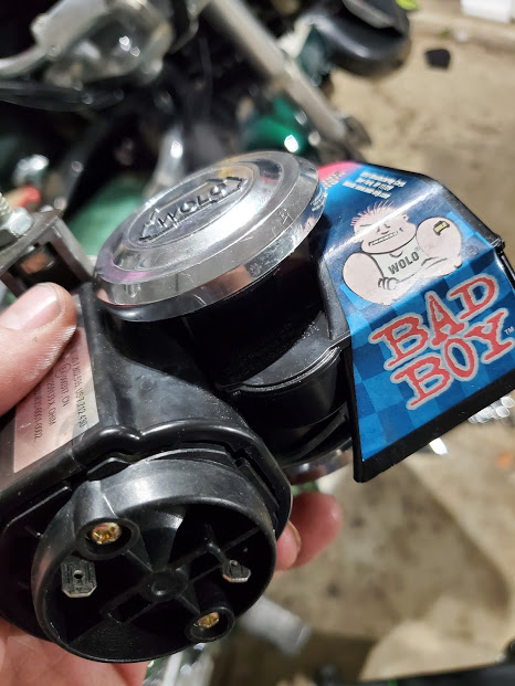

If you're going to hide a horn in the pod consider the Wolo Bad Boy.  It can be had for $30 - $40.  You should use a relay with the original horn wiring as input but the horn itself powered off the battery.

Yep I put one in my right side pod and it worked so well my buddy had to have one. I fabricated a small L shaped bracket and mounted it to the side of the radiator with an existing bolt.
Heh, ironically the air horn that was dangling precariously under the timing belt cover:
I tinkered with trying to get it in the pod but just couldn't get it to fit and was worried I'd break the pod as I was getting madder and madder at it.
And, there was no relay.....
So I just went into my "Parts I've taken off Valks over the years" drawers and dug up an OEM horn to put in there and move on to the next project...
If it works make another run at it when you have a chance.  You will need to fab your own "bracket".  If I remember right for me that was an aluminum strip with two holes in it.

Update -
I hate wrenching.
I hate wrenching so very very much.
I hate wrenching in 103 degrees even more.
But the replacement clutch master cylinder finally came in, as well as the slave cylinder rebuild kit, I've done the wrenching, and taken my first brief test ride around the block.
She's got a little hesitation at the lower end but I didn't give her time to really warm up, but so far the clutch is nice and crisp.
I'll let it sit for a while (I still need to get her inspected, titled, registered, etc, can't ride around TOO much without a license plate (Unless you're Steve Jobs)) and make sure the clutch slave cylinder was REALLY the problem, but considering the layers of funk if cleaned off from around the slave cylinder area, pretty sure that was it.
But after a week of ownership, I've finally ridden the new Interstate at least!

Hey Serk is that new led bulb safe on the housing reflector?
Posts: 22099
« Reply #38 on: September 06, 2020, 03:54:18 PM »
YMMV and all that, but I ran that same bulb on my prior Interstate for over a year with no issues...
larue
Posts: 1660
Clermont,FL
« Reply #39 on: September 06, 2020, 04:05:13 PM »
I ordered a set for my interstate. Thank you
