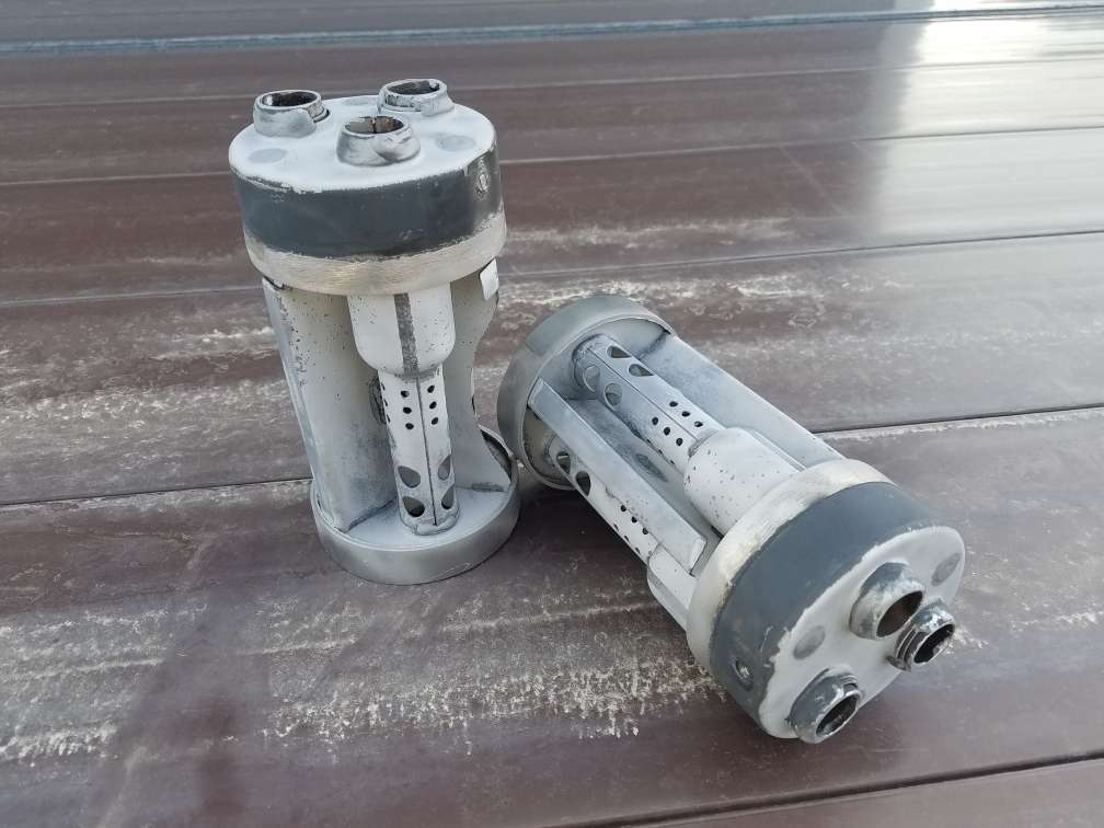

The "Ragnar cut" is a very bad idea and I've been saying that for 20 years.  It's an unreversible mod most will regret.  You can get the same obnoxious sound by cutting the back baffle section OFF at 7 1/2 inches, skinning off most of the outer surface, and have the resulting "SILENCERS" available to re-insert to return the sound volume to OEM levels by inserting them into truck stacks.  The Ragnar cut is unreversible without replacing the exhaust.  Unless you buy the same silencers from some one who has them on hand - like me - and a pair of truck stacks from any truck supply store so you can replace the back baffle section you butchered - they will fit just aft of the ruined exhaust inside 36" stacks.  This latter method results in more cost as the silencer cores cost money.
Here's a pair of Silencers I just made for a customer's pipe build - these will have Organ Pipes added for his build.  These were prettied-up by media blasting them so they almost look new, and the end cap paint removed so the Organ Pipes can be MIG welded on the openings.
