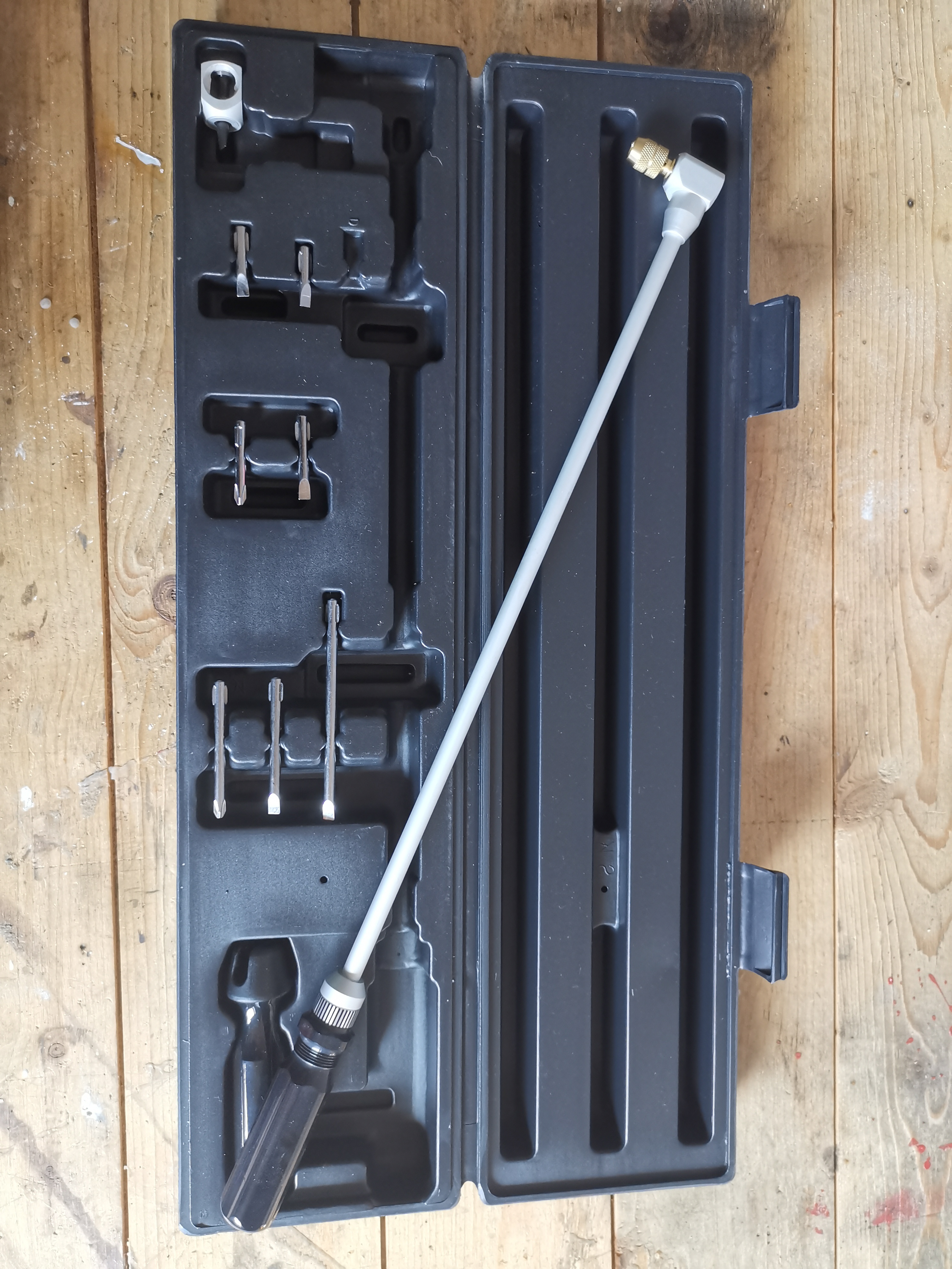

This works for me:
You'd need a stubby D-insert for US carbs, though.

The pit posse one you mentioned is the very same as mine. Only the stubby blade gear box (in the box pic upper left corner) works. The screw adapter is a tad too long to fit - that's right.
I have am European Carb, so the mixture screws are slotted, no D-shape.
