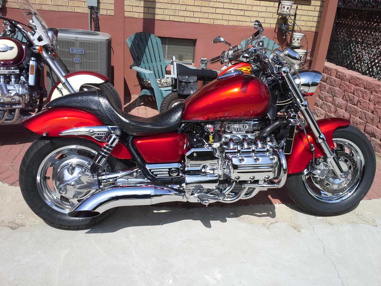

Mark, what shocks are on George’s old bike, they look short. I have a set of 11” shocks on my bike that I got used for a good price and I like the look, the ride is just ok, but with heavy duty Progressive front springs the handling has suffered some too. If I ever get the bike roadworthy again the rear shocks will need to be changed out again.
Posts: 5196
« Reply #5 on: October 18, 2020, 09:38:28 AM »
I have in my notes they are 444-4230's based on the spring embossed numbers but they have rotating collars like 412's, not the same as 444's with 8-turn top collar.  They were changed since GeorgeJ installed his choice 20 years ago - he was tall and the shocks are obviously longer in the old pics.  They are 11.5" now with 270/315 springs.  I turned the collars to minimum preload; they were too stiff and are still stiff.  The last owner is heavy set, more than me though I don't know his weight.
