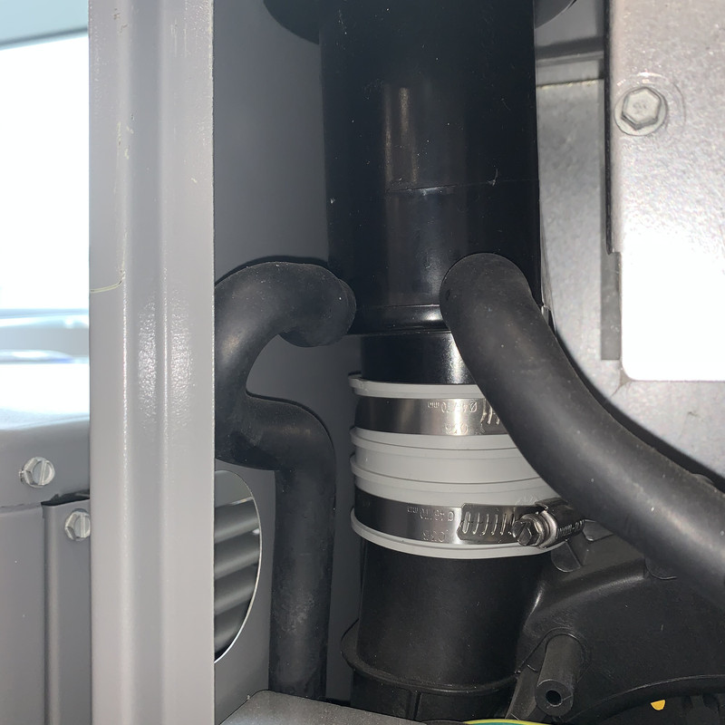

Here's a couple pix I took today that may explain the hoses better.
In this picture are the two hoses I was talking about on the vent collar. The one on the left can plug on the inside of the nipple it's connected to. The one on the right goes down to the collection manifold in the next picture.
This is on the bottom right corner and inside at the connection there is a filter. Just squeeze the hose gently and you will feel it. This can get plugged from guys doing a sloppy job cutting the vent pipe to length. Some guys use a resip saw and don't clean out the shavings before cementing the pipe and fitting together. Those shavings end up at that filter.
Anyway, the problem is going to be something stupid when discovered......

Thanks for taking the time to post the photos but I don’t have anything that looks like that. No rubber hoses or pvc piping.
My furnace has 2 removable panels, on the bottom is the main blower and circuit board.
On the top section is the gas valve, the pre-fan, the fan housing, the burners. There is 1 galvanized exhaust 3” or 4” leading out the top of the cabinet to the right to my chimney, to the left is the pressure switch. That’s is pretty plain and simple with the exception of some wiring.
No rubber hoses and no pvc piping.

Ah, so you have a mid-efficient furnace then. I assumed hi-efficient because that is all we have in Canada.
Crap this should be real easy to fix then. When your pressure switch shows up, let us know what happens. I would be putting in one that is a little less sensitive. Also take a look up you chimney to make sure a bird hasn’t died or built a nest in there to cause blockage. Wind can cause failure if you have a lousy rain cap or the chimney isn’t high enough. The problem is intermittent so those are possibilities.
