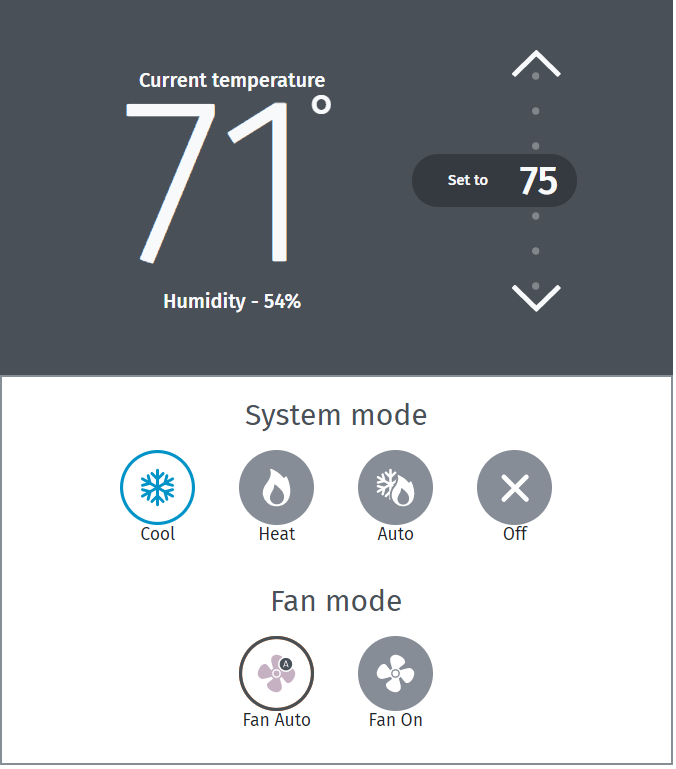

I have Sensi by Emerson thermostats, WiFi enabled, and use the WiFi enabled portion. I've not messed with them without the WiFi functionality enabled, but with it, I can "lock" the unit into cool or heat mode, or put it in auto mode and give it upper and lower temperature bounds and it will do what it needs to do to keep the temperature within those bounds.
(Here in Texas it's not uncommon to need heat and A/C in the same day)
I thought the WiFI was kinda a gimmick at first but wouldn't give it up for anything now. Wake up kinda warm, grab the phone, tappity tap tap and cool it off. Also easy to program it to set certain temperatures at certain times.
Edit to add:
This is my current upstairs thermostat. See the "System mode" area, that's where you can lock it to either cool, heat or let it choose:
Edit to add another thing:
Another nice thing, especially with kids, with the Wifi you can lock out the local controls entirely.
