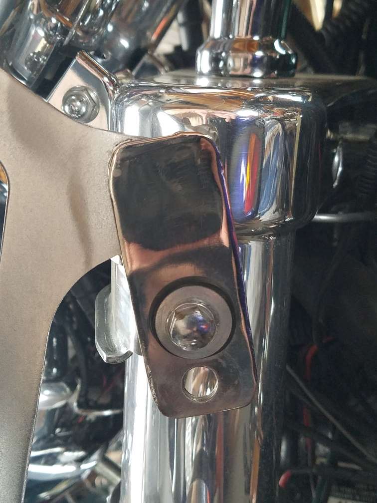

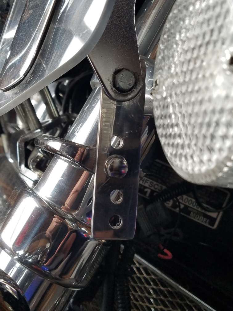

As others mentioned, tipping the shield has many benefits.  It's easy, just needs a couple pieces of metal strap with holes an inch apart on the Hondaline shield and also Rifle - don't know on other brands. It's reversible if you want to rollback the mod.  It lifts the headlight cutout so there's your vent feeding air into the vacuum.  It casts the gas filler reflection out of your sight.  It lowers the top so you look over it.  It increases streamlining so your bike gets less buffeting and better mileage & more speed & acceleration at highway speeds.  And it gets your head out of the turbulence even when you are looking over it.
I should add, I also have Baker wings on both of my daily riders, with this mod.  The uppers in closed position helps with the airflow.  I move the lowers open or closed with the season changes.
I wrote this up on my tech tips page about 20 years ago.
http://horseapple.com/Valkyrie/Tech_Tips/Windshield_Tipping/windshield_tipping.html
I did a more extensive mod with my new favorite daily rider, Jade.  Raised the headlight with extenders under it, and changed both upper and lower windshield mounts so I could make the shield very configurable on road trips - height and angle.  I did it because I can with my metal shop.
BTW this is a Clearview shield which uses Hondaline hardware - and I ordered it with the vent.  Which has NO EFFECT on the airflow (I open & close it with no difference) as I already have the vent happening with the headlight cutout raised up.
Another, lower view -
These show the tipping mod as I applied it to Jade.  On the return from Taos Inzane I decided I wanted to raise the shield and tip it more.  With this setup I had that done in 10 minutes at a gas stop.
The new lower shield mount:
The new upper shield mount:
Note streamlined angle.  Jade also has 4° triple trees so the fork angle is steeper than OEM in this pic.
