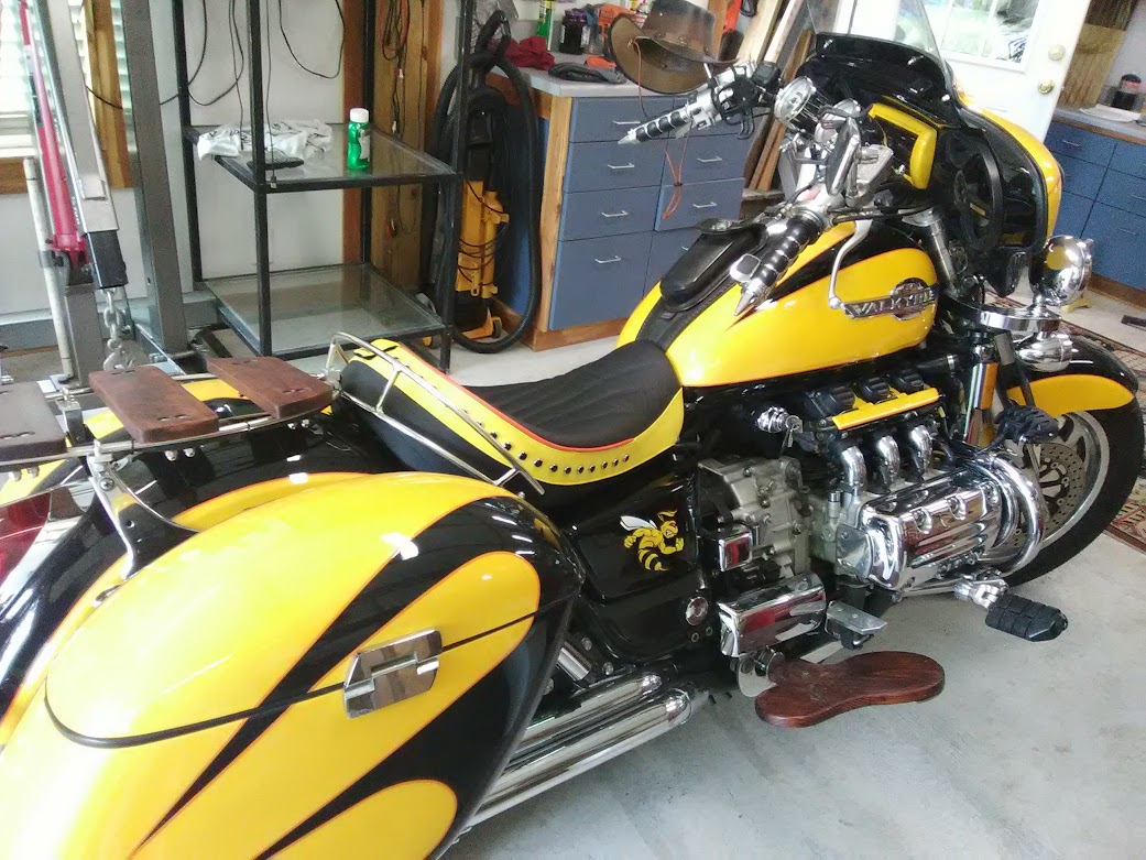

That is one sharp bike Pancho.  cooldude  I like custom work a lot, but I'm afraid I'd snap wooden floorboards off my first ride.  My Cobra boards have a built in pivot (up) in them, no spring holds them down, only gravity.  When I drag them (every ride I take), they tilt up (with my foot on them), though in hard turns, I tend to lift my foot off them an inch or so, so the pivot doesn't distract my attention forward.

[  I like custom work a lot, but I'm afraid I'd snap wooden floorboards off my first ride/color]
These boards fold up,,, I wouldn't ride with them otherwise, that would cause problems.  These were made to use as a form to sand cast aluminum ones, but I liked the wood so much I never have done it yet. Just need to add a bit of water to my casting sand mix and fire up the foundry furnace...    one day soon.
