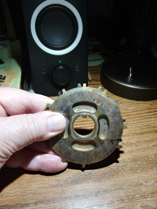

Had a freebee 4 deg. t/w sent a while back and today went about pulling the front apart to replace the belts and T/W on the trike. Got it all apart, pulled the wheel out of the package....lo & behold it's a 6 deg., not a 4 deg. Well nuts, since the trike is a converted I/S I'm not going to install a 6 deg. I know, I should have checked it before now but being a mere mortal....  Wink

This morning just for kicks I put the stock t/w and 6 deg. t/w together to see what the difference was. Here's a shot taken with the key slot tangs lined up, gives an idea of a 6 compared to OEM. The OEM is the one on top. Then if you line up the trigger tangs it gives you an idea of how much you have to grind off the OEM key slot tang to equal the 6. Sure isn't much, I'll wait for the 4 deg. and make the same comparison.

Got my 4 deg. T/W in the mail today, now if the weather will warm up a few hundred degrees I can put my bike/trike back together. I brought the new belts inside to keep them warm, they were so stiff from the cold in the garage it was difficult to bend them. I have some IR(infrared) heaters but can only run one off the outlet in the garage due to load. So, I split it up by running an extension from the kitchen circuit and another extension from the halway since they're not on the same circuit breaker. That gives me 3 of the 4 IR heaters I have available working to take the chill off. I back the car out & close the door, then let the heaters run for at least an hour. Seems to work fairly well if temps are upper 30s but with temps in the mid-low 20s I'm not real optimistic. I'm just hoping the wheel off my '98 Tourer will work on the '99 I/S trike.
