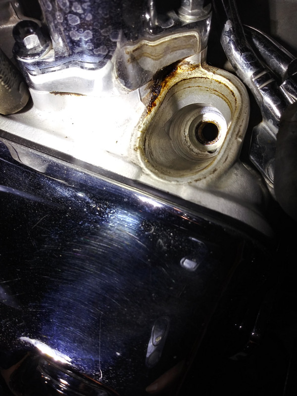

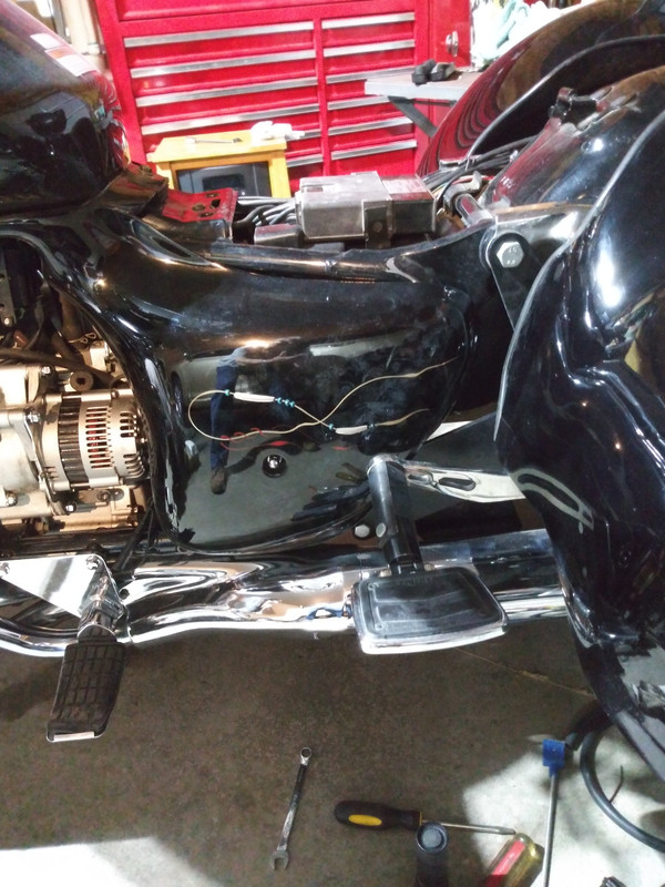

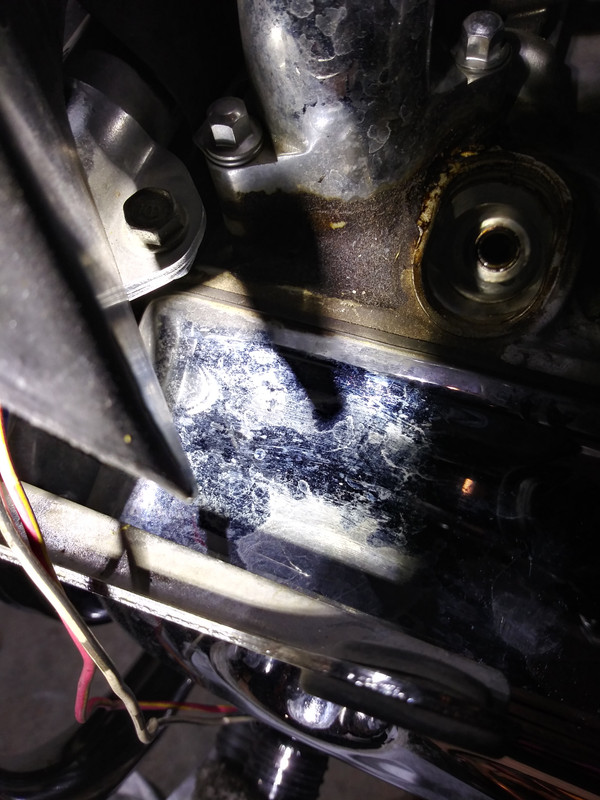

Next I decided to begin the process of replacing the belts and t/w with a 4 deg. wheel. Removing the radiator pods was a learning experience since they have the foglights installed. That's when I found the cobbled up wiring the PO did to the fog light switch. The switch had apparently failed so he just peeled back some insulation and wired them so they are on all the time. Due to splicing, etc., I'm not certain just how they're wired but I want them back to original so if anyone has a wiring diagram for the Honda fog light installation I'd appreciate a copy. Prior to positioning the timing after pulling the cover, I pulled the plugs...only to find they were only slightly more than finger tight. I put a torque wrench on one prior to removing it and found it and all the others were well below the specified torque setting which is 12 ft.lbs. if memory serves. Frankly, I'm surprised he didn't blow a couple out they were so loose. After removing the plugs, it was obvious there's a major leak at the union of the intakes and the cylinder head. Some worse than others.
#1 & #3...right to left.
#2
#6

Those intake runner O rings have been leaking for years. Remember to use Viton O rings.
