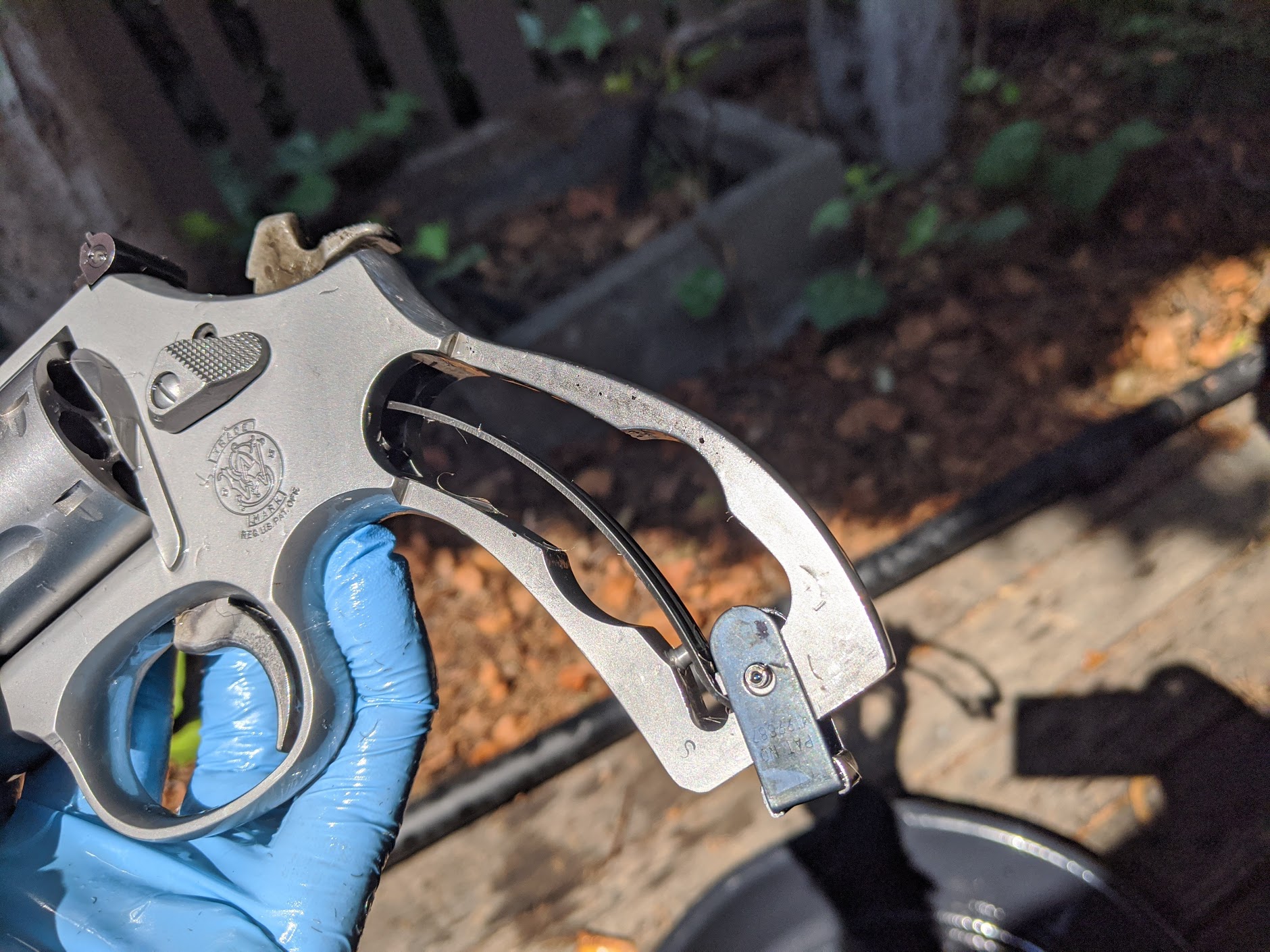

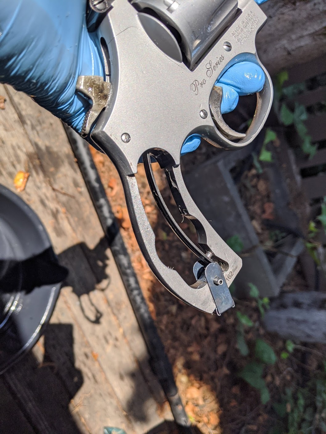

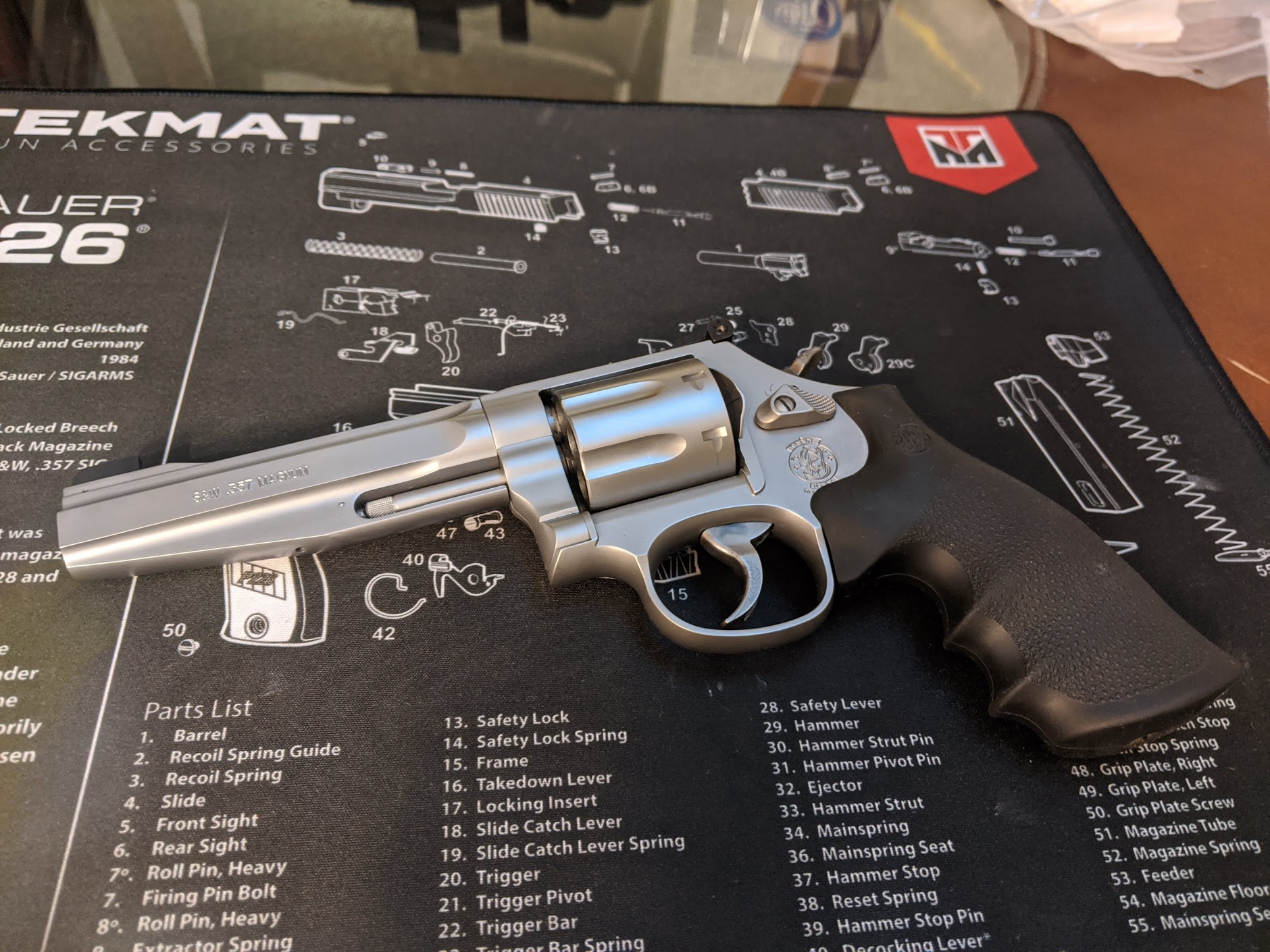

My firearms instructor used to joke that there are 3 main enemies to guns:
a) Lack of instruction: don't know how to properly and safely operate a gun.
b) Rust: decay comes to all things.
c) Ignorance: just talk to a politician...
I came recently to face one of the enemies: rust.

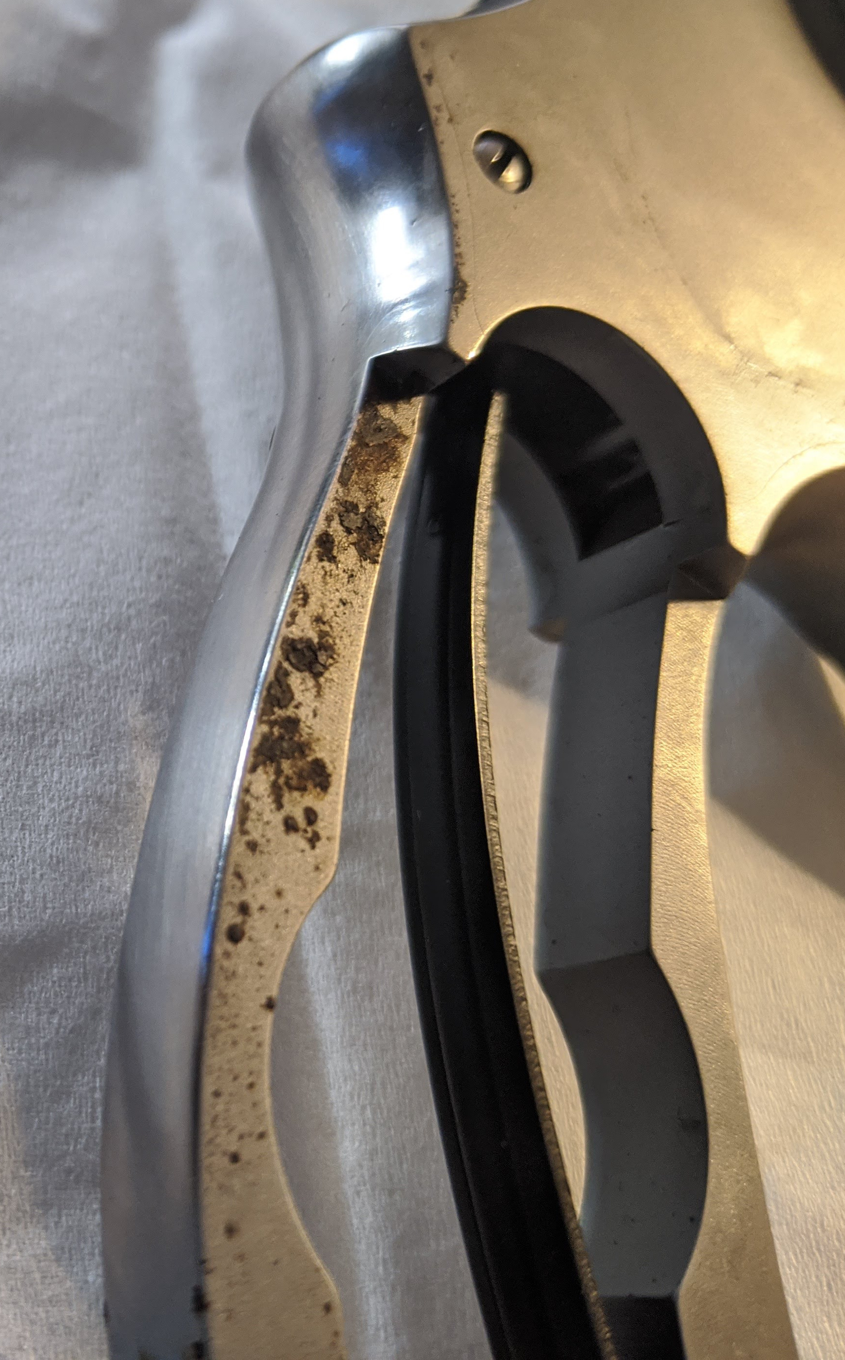

After a nice session in the range, I made the mistake of waiting a little over 1 week to clean the guns. Well, it turns out that not all stainless steel is the same grade: while the Ruger Super Redhawk made in the late 90's was fine, the new S&W 686 Pro made in the recent years was covered by rust (tiny red spots in the frame).
I decided to remove the grips and have a look and to my horror, it was actually flaking and had some bad pitting in the handle.
« Last Edit: December 13, 2020, 04:35:51 PM by Savago » Logged

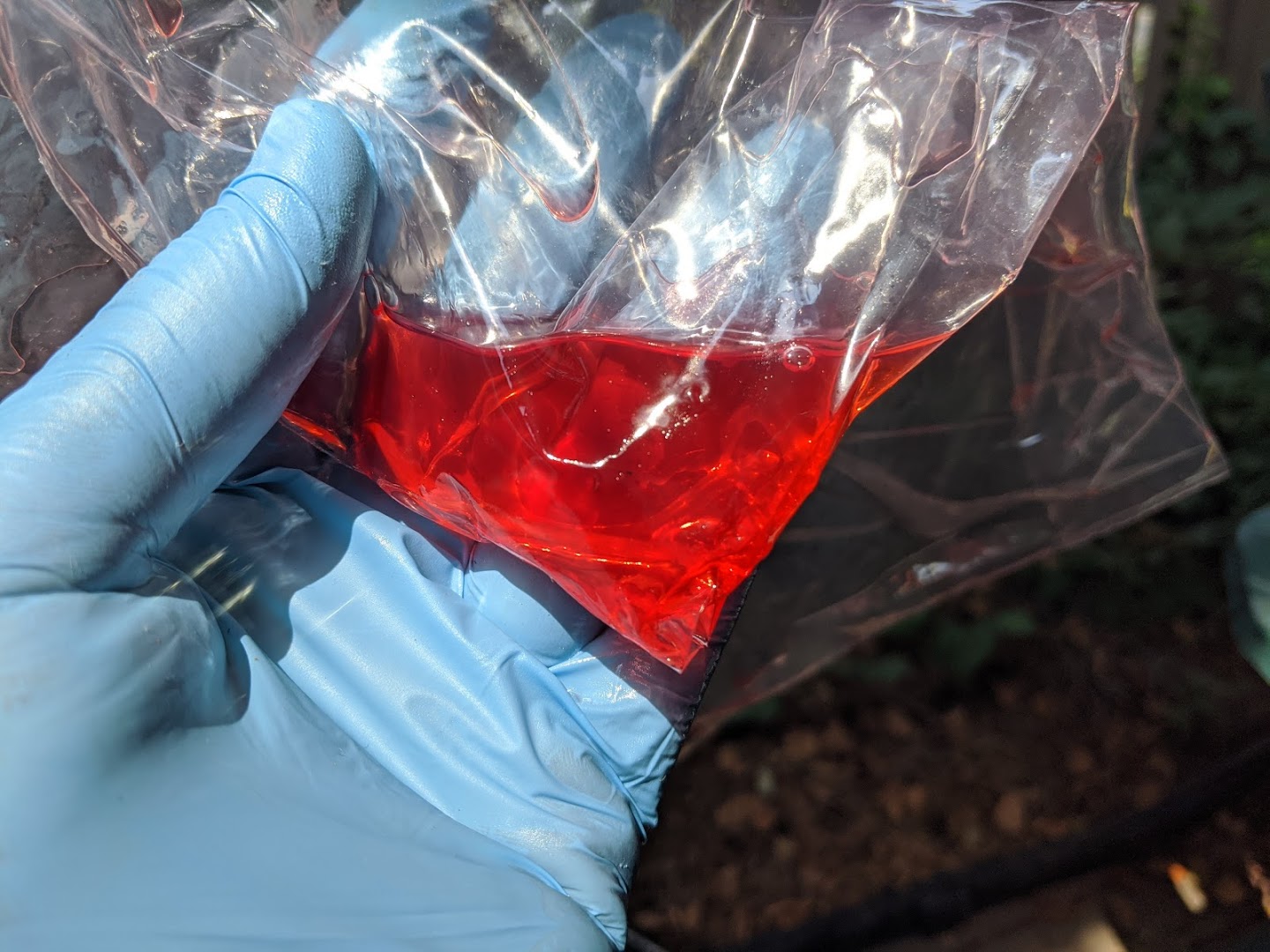

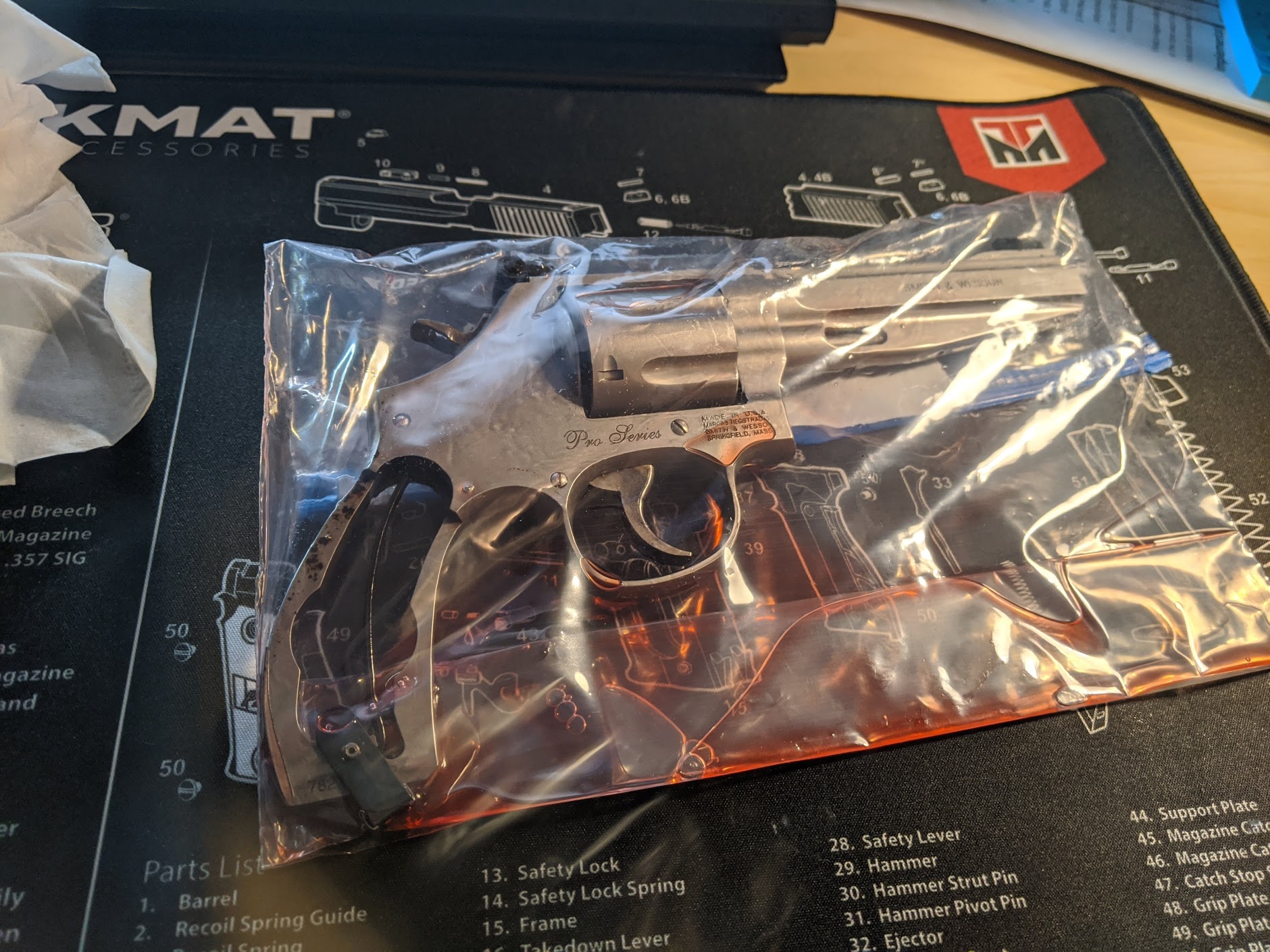

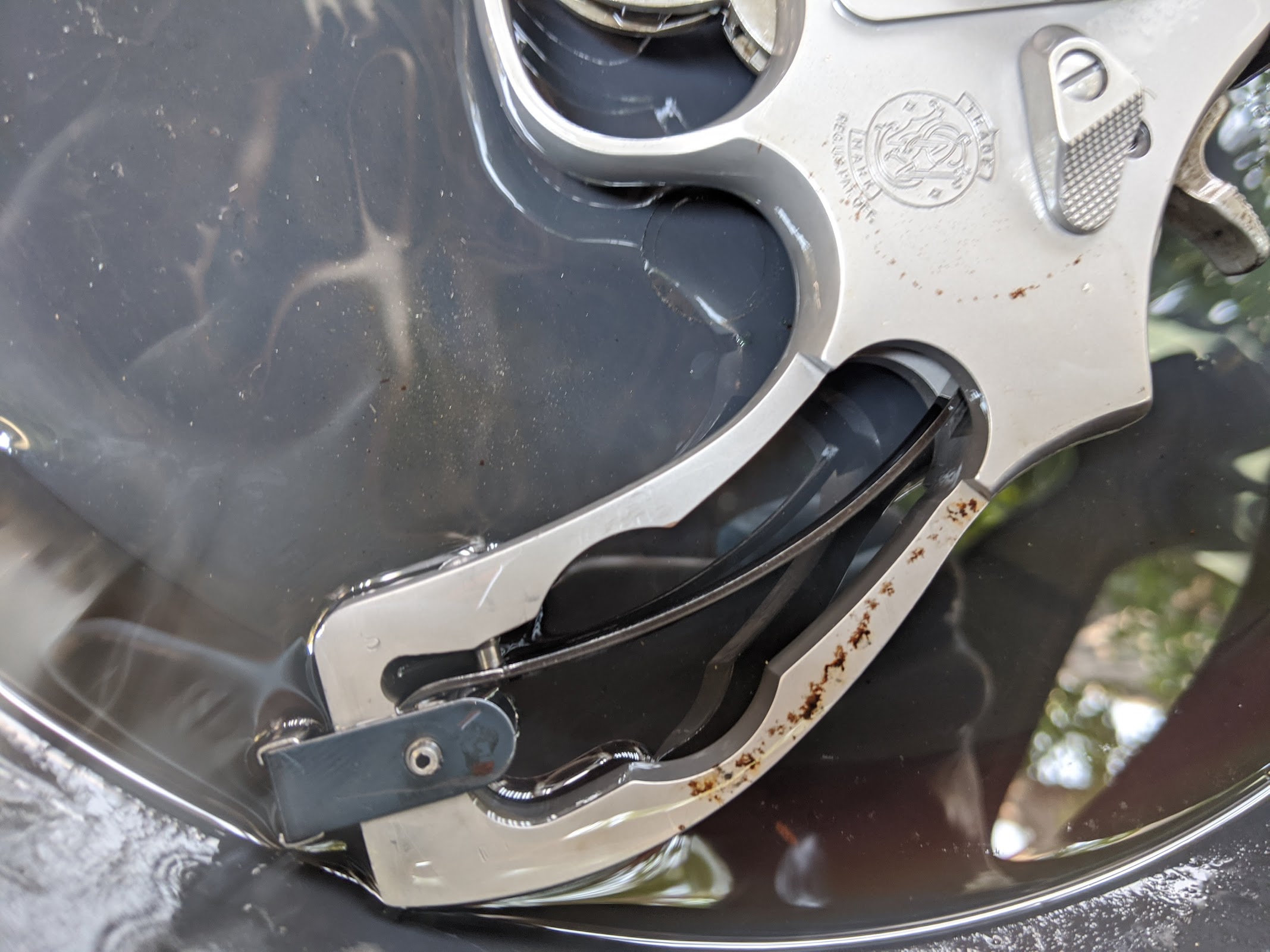

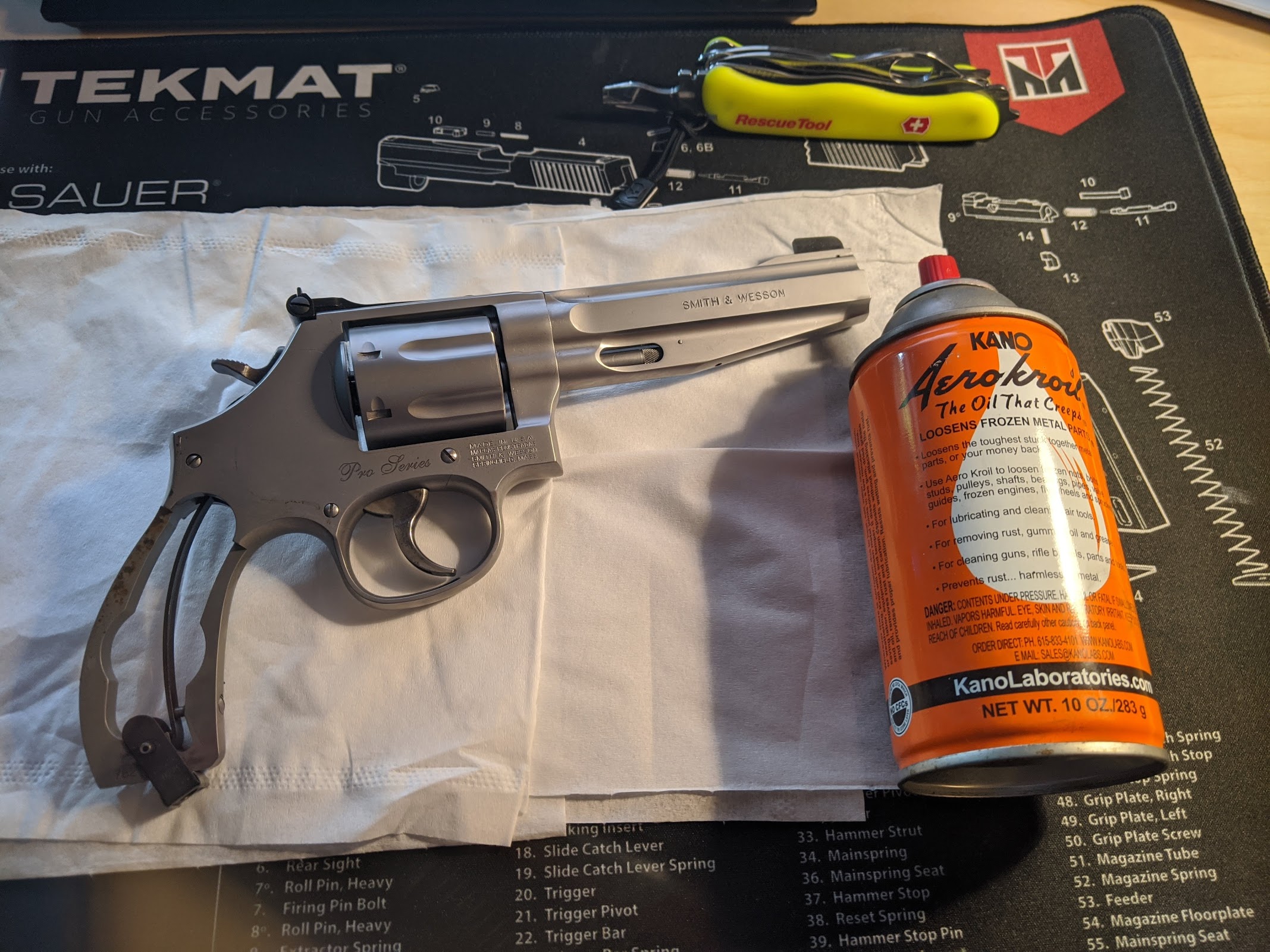

Before visiting the local gunsmith and getting a pro to try to clean the mess, I thought it was worth the shot (pun intended) to try to mitigate the situation by myself.
Some research in the web suggested that Aerokroil could be used to penetrate the rusty spots and break the oxidation free.
I decided to let it soak for a night inside of a ziplock and inspect the following day.

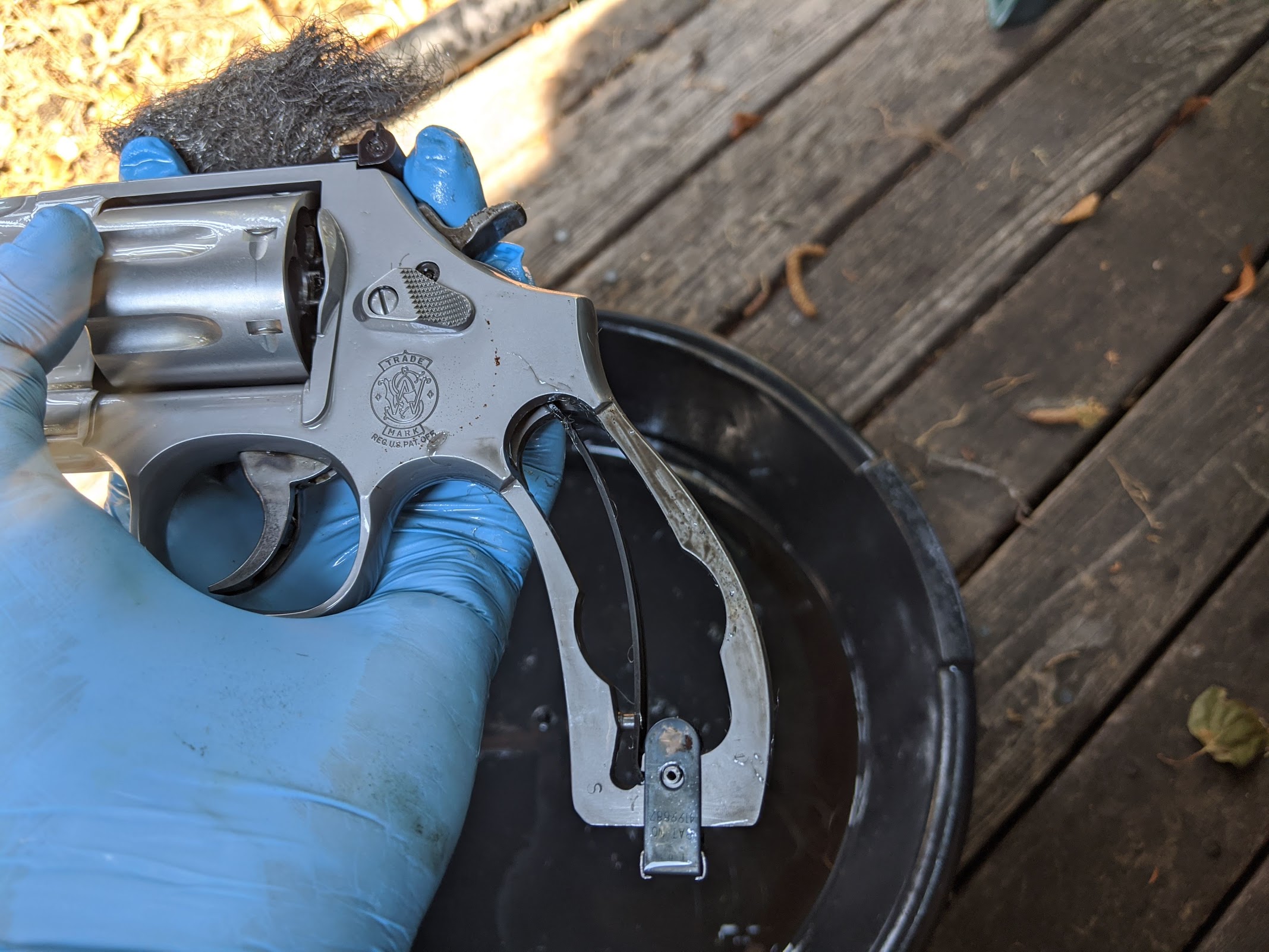

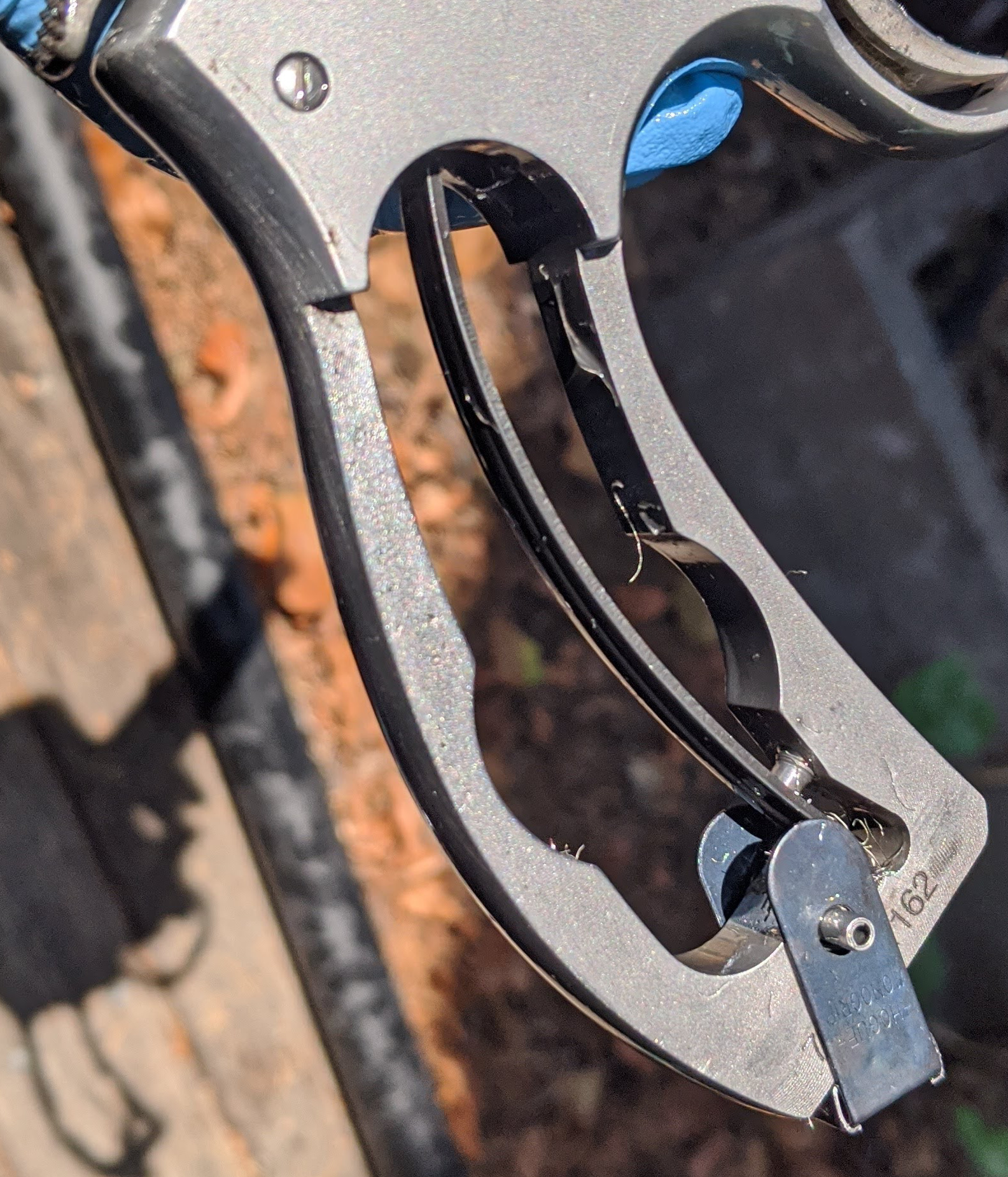

The following day some of the rust was gone in the handle (and most in the frame).
Decided to use a stainless steel wool in the handle and to my surprise the rust spots started to go way.
« Last Edit: December 13, 2020, 05:16:09 PM by Savago » Logged

Final results were alright, way better than how it started:

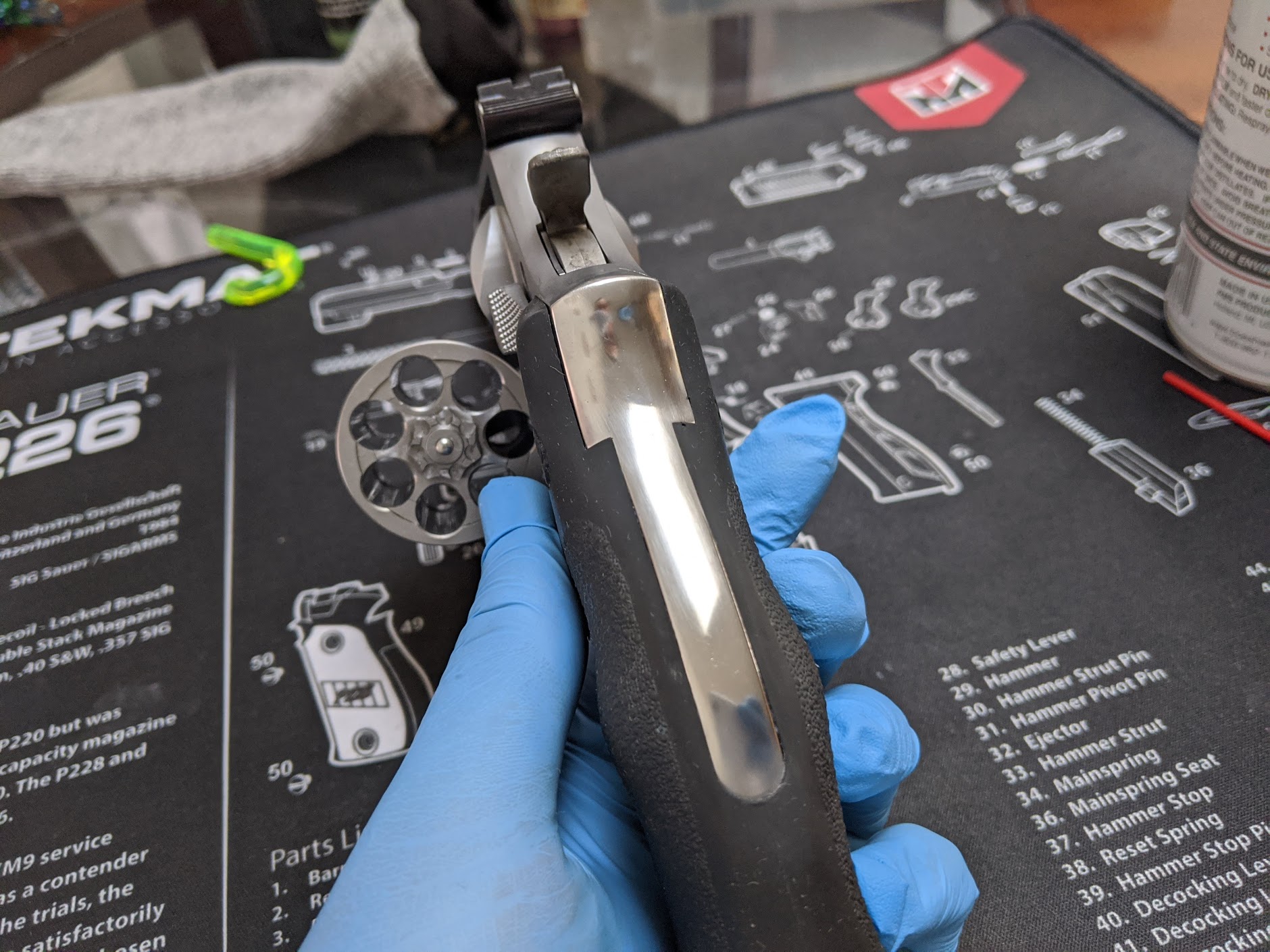

The removed rust from the back handle left some pitting, the solution was to polish the whole surface (I've used Flitz).
It looks different from the original sand blasted finish, but I kind like the little touch of shiny metal in the handle.

I have never seen or heard of rust (on stainless or otherwise) starting that quickly.  I assume it was indoors (not in a mud puddle for a week).
I must ask, do you have corrosive or acidic sweat?  I have seen, once or twice in my life, amazing and quick corrosion on metal things from a couple guys who did.  They were not unsanitary people (just some rare internal chemistry), but the damage it caused to metal things was quite surprising.  If so, you may want to get some tight shooting gloves.
My old police trade in Remington 870 shotgun, has two very distinct fingerprints in the bluing that could probably be photographed and put through a computer for matches.  I removed the light rusting, but the only way I was going to get those prints off was to polish the bluing (and maybe some metal) off, so I didn't.
Also, I think I'd wax the butt frame under the grips to help prevent that from happening. (or maybe the whole revolver)

You have discovered the universal truth "stainless will rust given the right conditions". That is not to say that it will rust like non-stainless. Usually it is minor and seldom and not easily done.
Areas of contact like handle interfaces are the most likely as they do not get the benefit of being wiped or of air circulation to dry.
The comment on checking the internals is very appropriate. Also every revolver I have seen that malfunctioned was caused be internal rust. Usually occurring on revolvers carried in pants where they were exposed to body moisture repeatedly over a long time. A light coating of oil will stop that.
As for removing the side plate, remove the handles and the 3 screws, note where each screw came from and return it to the same place (very important). Then hold the revolver in one hand (side plate up) and tap lightly and repeatedly with a wooden or plastic handle on the and of the handle until the plate rises from the frame. Vibrations not force will loosen the side plate. Never use force or pry on the side place. The top of the side plate is hooked under the top of the frame and comes out last with a downward motion.
When lifting the side place note there is one piece (the hammer block) that is loose and can fall out. Note its position as it must be in that position to reinstall the side plate. All other parts will stay in place unless something else is wrong. Clean and lightly oil what you can. While you can work the action while the side plate is off I would not unless you are familiar with assembly/disassembly. Working the action with the side plate off, puts stress on the pins while they are supported on only 1 side and parts can move out of alignment.
Reassemble, be sure the hammer block aligns with the side plate groove and is on its pin. hook the side place top into the frame and gently press it in place. Reinstall the screw in the correct holes and tighten  to snug. The test the action, noting the action of the hammer block thru the hammer opening.
Disassembly of the action is not that complicated but it does require some careful cautious work and is aided by 2 special tools. If you decide to proceed get someone with the tools and know how to assist the first time.
RP#62
Posts: 4161
Gilbert, AZ
« Reply #10 on: December 14, 2020, 08:08:04 AM »
The gap between the grip and the frame allows sweat/humidity to be drawn in and kept against the metal, promoting corrosion.  A good waxing or application of oil or corrosion preventative there should go a long way.  Regarding corrosion and stainless steel - some stainless alloys have to be passivated to retain their corrosion resistance following machining.  We used to have to do it on aircraft  (flap tracks come to mind) following repairs.  It basically involved treating the surface with a mixture of nitric acid and other nasty stuff that dissolved the iron regions/grains within the stainless that were exposed at the surface.

A close-in: before:
