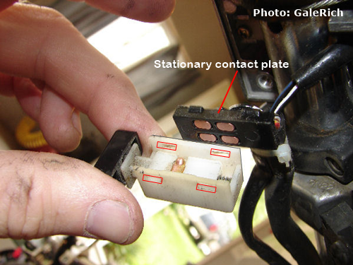

An option is to remove the new start button from the new housing and transplant it in the old housing. This fast tracks the operation until you
have more hours or need more info to work on things. Disregard if your kill switch was faulty. Oh, replace the start button with it's nylon box.
Just release the start button from the four barbs on the stationary contact plate (black thingie).

A Pencil eraser is great for polishing the copper!  Don't forget just a fine layer of dielectric to seal things from air and moisture.
Nice pictures!
