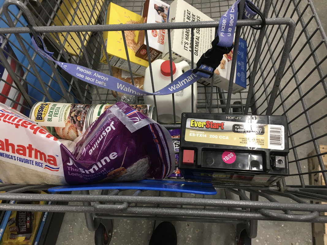

Ok so it’s COLD. I rode to church yesterday. No problem. Bike sat in the parking lot for three hours and when I went to leave it was a different story. I probably should have used choke (enricher) but I didn’t. First try on the starter no start. Second try kinda weak. Oh crap.
Bottom line I had to get a jump.  Ran fine restarted after that fine and still held 13V engine off but I just didn’t trust it
Gotta love Walmart sometimes. Lol.

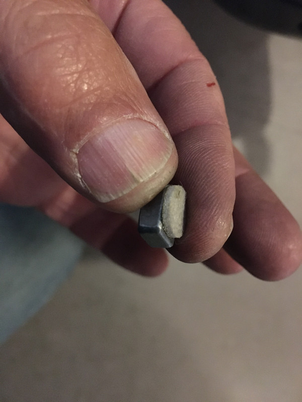

Ok, I never do anything special to the little square nut thingy but this time it wouldn’t start threading. I came up with a perfect fix. You know those little felt pads you stick on a door to make it quiet when it closes. If you stick one on the bottom of your nuts it lifts them up just enough to get them started first try.

I usually slip a tie wrap behind the nut. Pull it out when the threads engage.

I have some odd bits of clear small plastic tubing laying around so I just cut a 1/2" long piece and slip under each nut and leave it there for the next time. Been doing it for at least 50 yrs. or longer....probably longer.  Wink

The problem with the battery post and square nut is; gravity holds the nut in the bottom of the post channel.  If you have one or two cables or extra wires to thread on top the positive post (I think I have 5 or 6 because I'm too stupid to wire up a fuse block) then the screw does not reach down to the square nut in the bottom.
I've used foam earplugs, a small piece of vacuum hose, or anything small and spongy that's not metallic.
And use dielectric grease to fight corrosion.

The felt pad (pictured) is perfect because it stays. If you use it on the battery nut and not your testicles. That way if you have to disconnect the battery it will go right back together no matter where you are and you don’t need to find something to stick in there
