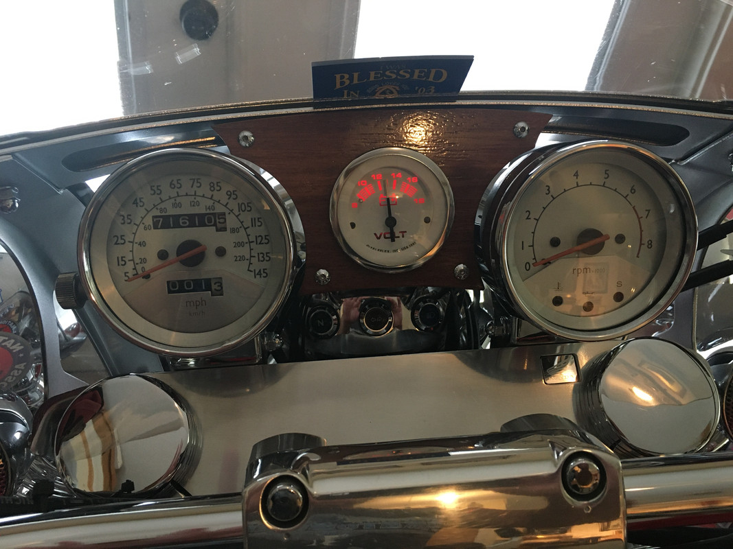

I bought a used marine gauge and bent some aluminum around it.
I ran a fused wire directly from the battery (same as the power source for my after-market horn) through a single relay triggered by the auxiliary power source. The only voltage drop is the wire and relay.

I too ordered a marine meter from Overtons and bent some wood around it and mounted it to the center bolt of the windshield hardware. I ran a fused hot lead to the battery and the ground has a switch mounted on the plastic neck panel on the left side so I can turn on the meter when the engine is off to check the battery.
Running
Not running
The switch

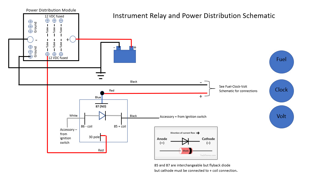

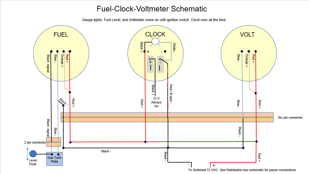

The wiring for a voltmeter is just + and - from battery (fused). I have a power distribution box setup to energize the accessories when switch is on. The clock of course is wired always on, but the light comes on with the switch. I included the schematics if you are interested in doing something like that.
There is a typo in my note. It should say "85 and 86 are interchangeable, but flyback diode
cathode must be connected to + coil connection."
