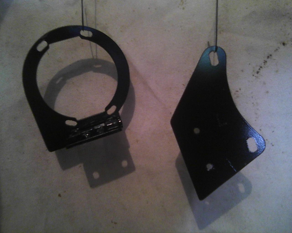

The Lights are sealed Fog LEDs trimmed with vacuum line cut in a jig. Lights are mounted in adjustable fixtures. The adjustments were made and tested for a number of miles before the holes were cut using a jig to properly locate them in the pods; you only get one chance to get it right. The light beam is set so it overlaps slightly in the center and reach well beyond the ditch.

Quote from: Avanti on January 15, 2021, 08:51:05 PM
They look great Avanti, do you have any pictures of how you did your brackets please?

Avanti
Posts: 1409
Stoughton, Wisconsin
Re: Fog lights install in 1999 GL1500CF
Reply #9 on:
January 18, 2021, 09:34:10 AM »
Go here to view the lights and how they function.
Using to large of a diameter light will change the fit and the trim you will have to make do to the curvature of the Pods.
https://www.theretrofitsource.com/universal-70mm-morimoto-xb-led-LF-UNIV?quantity=1
This is the direction l went because I wanted to have sealed and up-to-date LED lighting.
