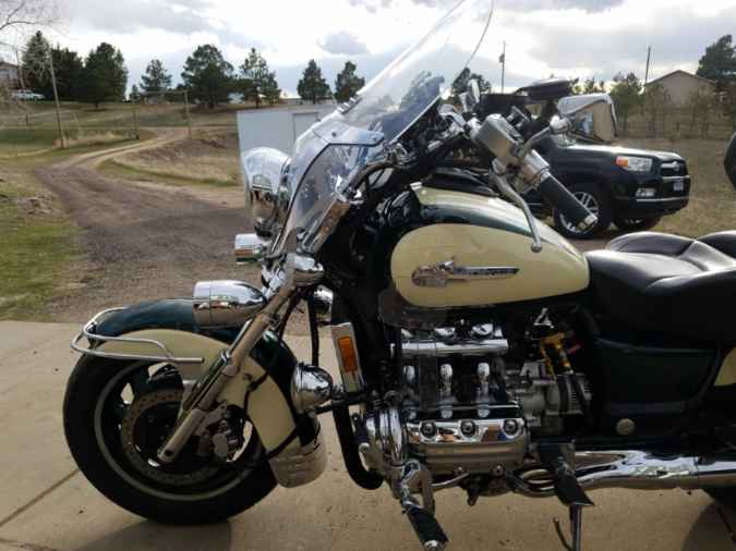

FYI - I fixed my buffeting problem by putting deflectors on the forks.
2001 Valkyrie Super Tourer
VRCC#34410
VRCCDS#0263
