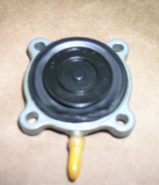

Any ideas, comments, experiences like this?
Take your petcock off and diagnose its problem. When you put the
new one on, it would be good to KNOW you have that problem fixed.
I fixed a Valkyrie that had a bad petcock and which leaked gas
down the #6 vacuum line and shot gas out the muffler and leaked
gas out of the weep hole with a "cover set" (OEM rebuild kit).
The former owner tried to fix it like this  Smiley
