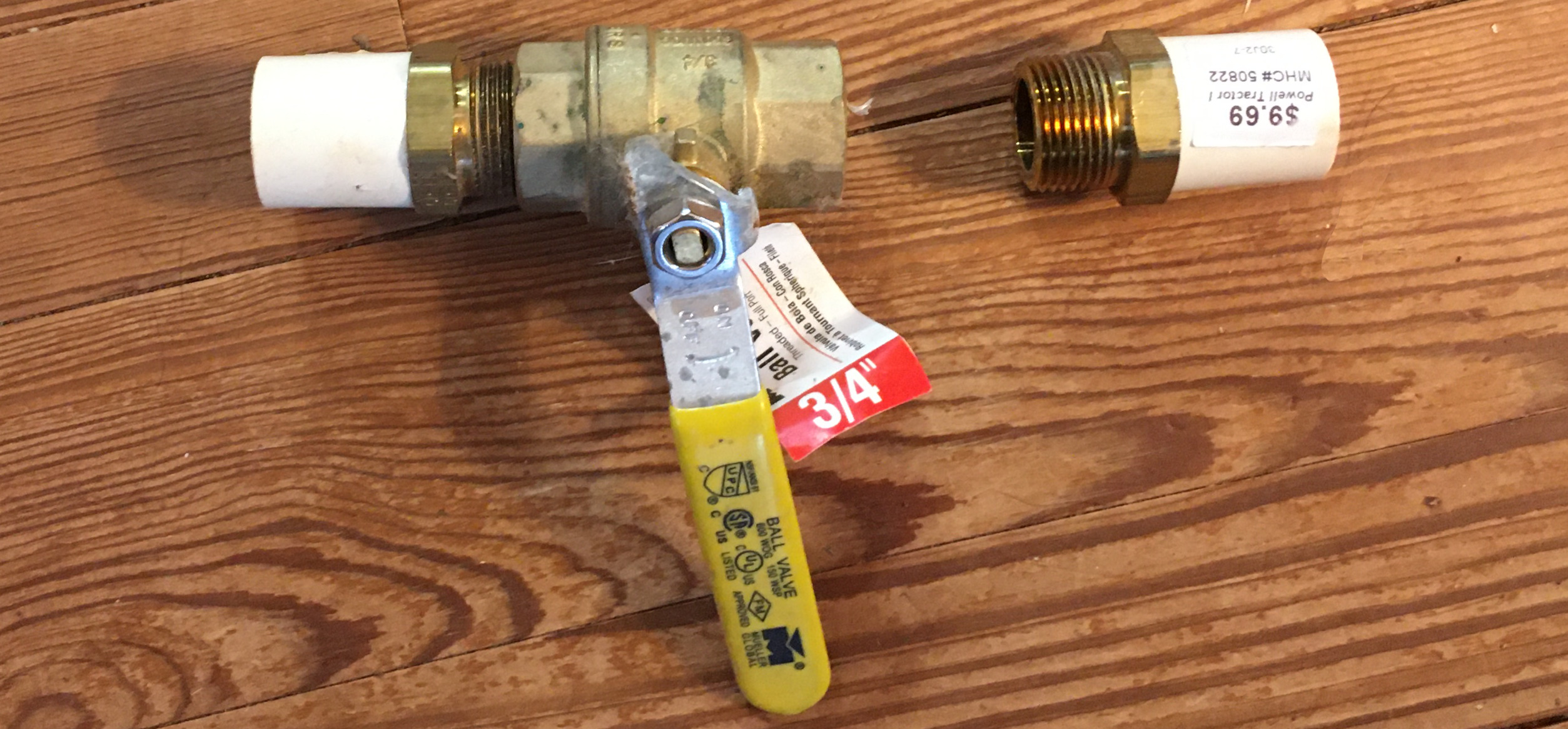

When I decided to give it up last night, I put a ball valve on the CPVC (in case my latest attempt on the fitting to copper failed again) so I could have hot water through the house (except the washer). Well, apparently I'm not doing something right
I'm not sure how you're doing it, but I'm the king of doing it wrong. NEVER use any pvc with threads on it.
Here's how I always do it easy and right now... brass ball valve and these kinds of transitions...

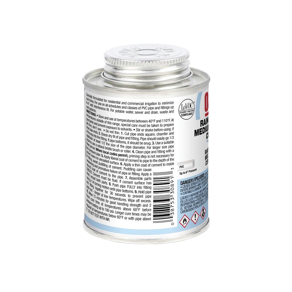

1. PVC cement should have 24 hours before putting pressure on it. I've gotten by with an hour before, but the 5 minutes I was giving it was for sure not enough, leading to blowouts of my joints.
2. Plumber used sharkbite, PEX and some PEX fittings. Took him about 15 minutes after he got back from a supply run. If I would have used that, maybe 30 minutes (instead of wasting over 8 bours of my time).

blue glue...
"allow 15 minutes for good handling strength and 2
hours cure time at temperatures above 60 deg F
before pressure testing up to 180 psi."

CPVC cement cures for use within 2 hrs. Actually 1 hr is just fine when applied correctly.
