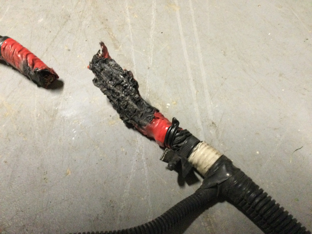

Cost me $1,000 yesterday. I had traveled 250 miles to my previous hometown to pick up a load of furniture my wife wanted to buy from a family member. On the return trip, about 150 miles from home, the truck started bucking and knocking and at first I thought was oh no I’ve lost a u joint. But I was loosing power and had to start coasting to the side of the road and ended up at the bottom of a exit ramp. By that time the engine had died, so I attempted to put the truck in park, and that’s when I knew what had happened. When the truck wouldn’t go into park I knew my exhaust going over the rear axle had blown out and melted the wiring harness again which causes things to short out and blow fuses, including the brake lights which powers the shifter interlock.
This time, it also got the wiring going to guess what, the fuel pump! So I knew I wasn’t going anywhere anytime soon. I had a trailer load of furniture and a dead truck. Google to the rescue, there was a Uhaul dealer about two miles away and they had a 12’ truck that I could use to pull my trailer home. So I hoofed it over there and upon arrival, she informed me that the truck in question had been reserved for the next day so it wasn’t really available. But there was another issue, walking pass the truck on the way inside, I noticed it had a 2” ball and my trailer is a 2 5/16”. She also informed me all there trucks have the 2” ball. So I was out in the parking lot contemplating my next move when I noticed that the 15’ trucks had a square hole in the bumper next to the fixed 2” ball, an opening the 12’ truck did have. Could it be that the hole is a 2” receiver? Sure enough it was as I got down on my knees to ensure there was a hole for the pin, and it was there! One problem solved. $200 later I was backing down the exit ramp to hook up the truck to pull it far enough forward to get the Uhaul in front of the trailer. Then it was on to how to get the truck home. After numerous calls, I found someone with a rollback willing to come and take the truck to Richmond for me. $665 later the truck is loaded and on its way.

Ordered stainless exhaust today. Also had to order a complete new chassis harness. It really cooked the wires this time. The plastic wire loom covering completely melted into the the harness wires. I could work a couple of days trying to get them apart and it still might not work. The is no slack to speak of to help with the process either. $200 harness will be a much less complicated process and more reliable.

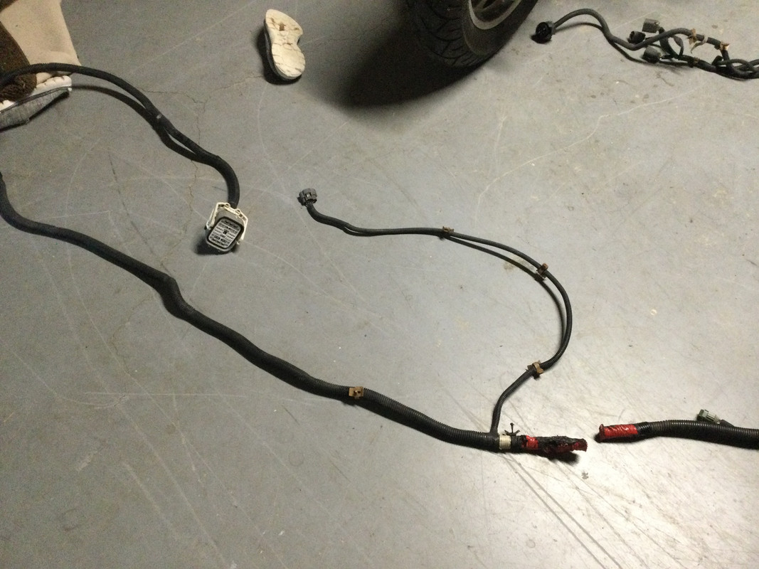

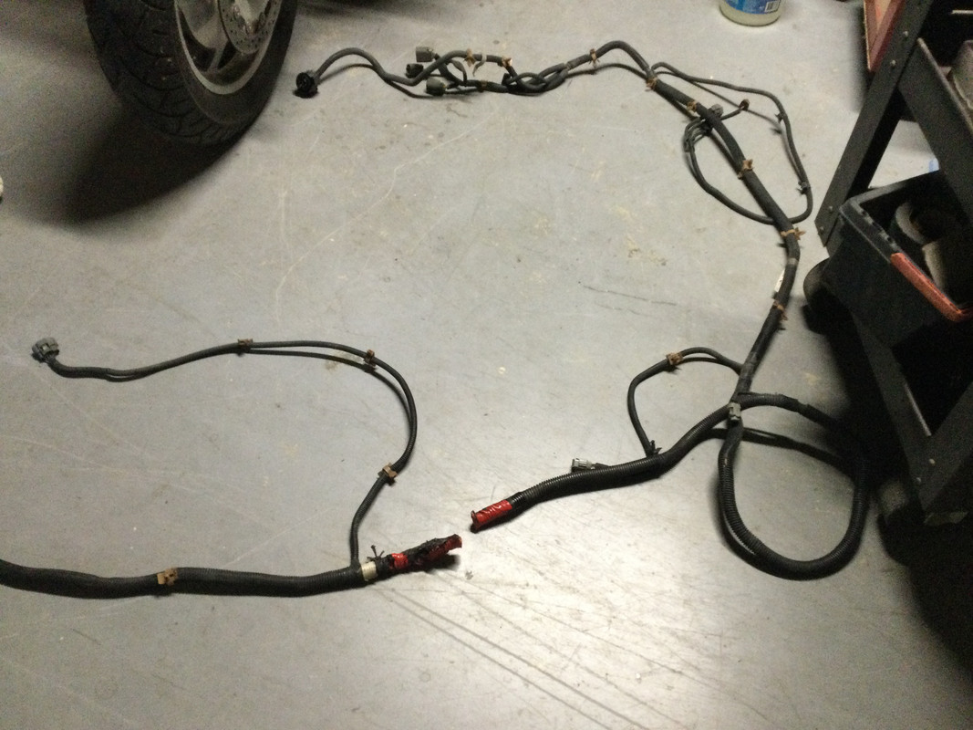

The damage that cost me the $grand.
All this was a one piece harness.
