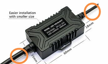

The only drawback I found: These driver boxes do produce some HF noise that will swamp your radio recepition and may play havoc (not that I have experienced any issues, though) with CDI boxes and similar control units.

After installing additional supressors (3.5mm sized) radio noise was considerably better but I decided to get better produced LED inserts for my car.

Where did you install those?  On the headlight cables?
-mike-
Posts: 225
Germany
« Reply #13 on: June 04, 2021, 07:26:32 PM »
A picture is worth a thousand words:
Position marked in orange.
-mike-
