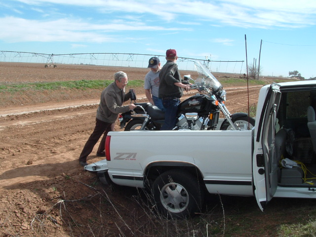

The angle where the ramp meets the truck needs to be
obtuse enough to make it unlikely that you'll drag your
Valkyrie right where the hollow cross-member is. These
guys loaded my Valkyrie when I bought it, people here
hated this picture, but my cross-member was not damaged...

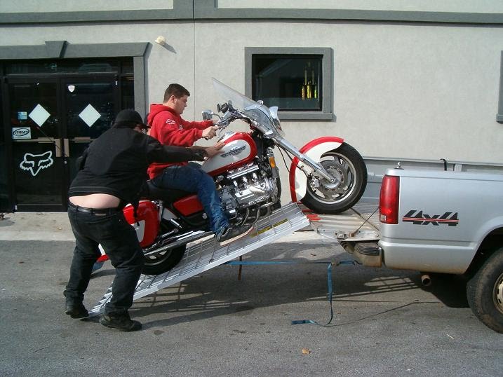

Loading like that is precisely how my kick stand bolt got broke.   They should have reduced the angle by backing into a ditch or up to a curb.  Never again.

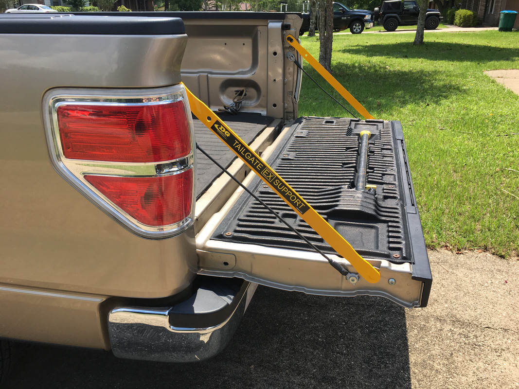

Finally found the picture. I too was concerned about those skinny cables so I got these. No more worries. They are the perfect length so with no weight on the gate the cables take all the load. As soon as you load the gate and the cables stretch just a hair the bars take over. It’s a beautiful thing  smitten
Posts: 11722
« Reply #28 on: May 12, 2021, 07:36:34 AM »
good idea to get the tailgate supports.  Those cables can easily SNAP loading up a 600-800lb. ATV with near 300lbs. of rider.  My guess is 1000lbs. max on those cables, if that, before SNAPPING.  I have loaded up my ATV weighing over 600lbs. with me 275ish at the time with my very heavy duty 2000lb. OHIO STEEL 7 ft arched ramps and always worried me the tailgate cables would SNAP, but did not on a 1/2 ton truck.   A valk weighing 800lbs. and me pushing 300 would not be good on just the truck tailgate cables.
Thanks Jeff, I have seen these around, also I have some good news regarding taxes, the California Franchise Tax Board sent me an estimated amount due versus what I really owed. The FTB makes the IRS look like choirboys, I was threatened with leins and or wage garnishment if I didn't pay within 14 days..

Question: are those ramps supports vehicle specific?
Yes they are, they need to clip into the latching mechanisms

Actually, I believe they simply lay on top of the tail gate.   Notice the tie straps shown that in the pic go down to the receiver hitch to keep the ramps from sliding back off the tail gate.   This, is a good idea.
I could be wrong but, I don't think so.

The most common cable used for tailgate support cables is 3/16” stainless wire
rope (¼”with vinyl jacket). An individual cable has a breaking strength of about
4200 lbs. and a safe working load of about 840 lbs.
I've always replaced the cables on my used trucks with new OEM ones. If I needed
those bars that Jeff uses, my old Tacoma's tailgate would fold up like a taco Wink ...
Don’t know what picture you are talking about. These bars hang from the latching posts and the other end locks into the latches.

Sorry, my mistake, I thought you were talking about the ramps, not the bars on the side.

safe working load around 850lbs. sounds about right on the tailgate cables but snapping/breaking at over 4000lbs. seems very very HIGH know they will SNAP well before 4000lbs..   800lb. valk + 250lb. person is over 1000 lbs. but then again all 800lbs. of cycle is NOT on the tailgate all at once only 1 tire at a time on the tailgate.  And here I worried a smidge having five 5 gallon buckets on the tailgate all at once guessing 40lbs. tops each bucket so 200lbs. on tailgate plus me at near 300lbs. worried about snapping the tailgate cables at 500lbs. on them.  Roll Eyes
I like those tailgate supports on each side by the cables if going to load valks, lawnmowers, etc. more than 1-2 times per year in the bed of the 1/2 ton truck,  good investment LONG term.
