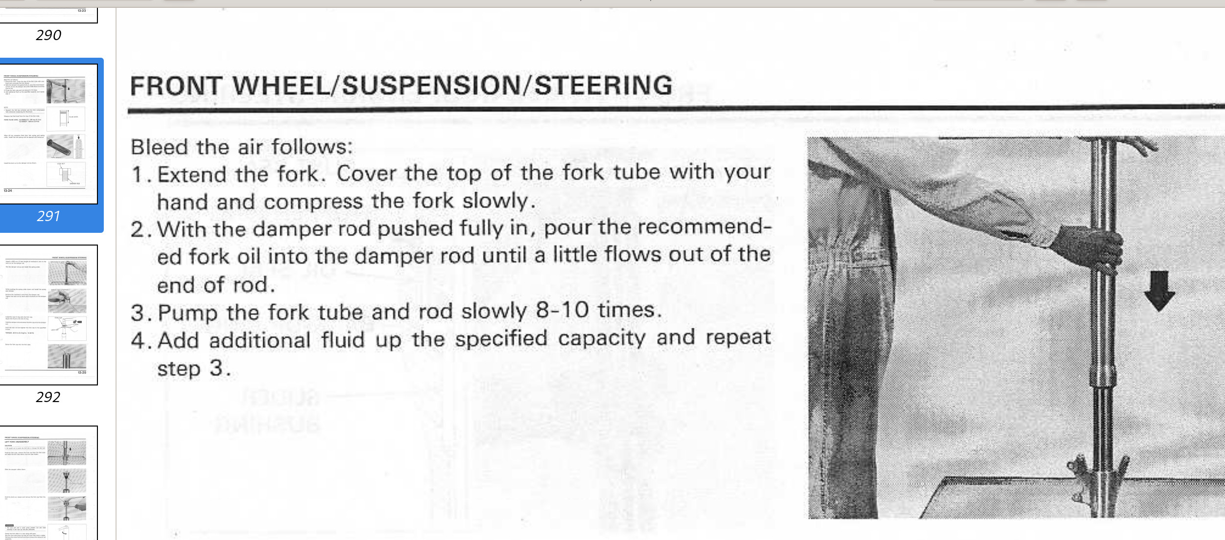

« Reply #11 on: May 11, 2021, 05:53:12 AM »
https://postimg.cc/gallery/7ZQt2pj

For everyone's reference, here's a post from the old VRCC board by Chet.  It quickly and concisely explains the procedure, with all the shortcuts.  I've shared this dozens of times and still get asked for it.  It's now 15 years old!
