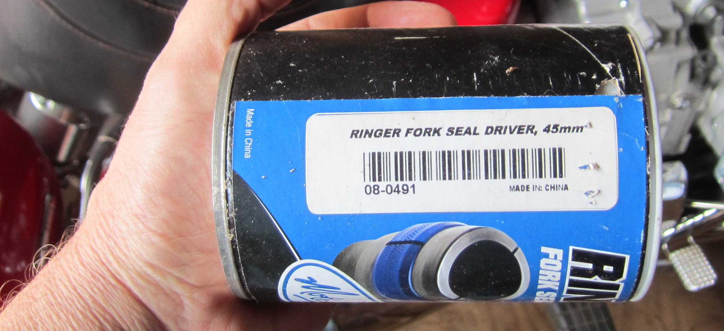

I just used # 21 on both bikes. I used that method for the most part but protected the new seal by putting electrical over the sharp edges before sliding the new seal on the fork tube. Also broke down and bought myself a seal driver. Money well spent for me because I am always working on bikes.
Posts: 5196
« Reply #9 on: May 19, 2021, 08:16:00 AM »
+1 on the seal driver.  I tried to cheap out making the DIY one from PVC pipe.  No go with Balls seals.  Bought a seal driver on ebay.  Not used often but when you need it, you got it.  If you have a local Valk group, probably good to have one to share for the group.

The seal driver is 35mm right?U
I'm no gynecologist but hey I'll take a look!
Posts: 16804
« Reply #11 on: May 20, 2021, 09:25:31 AM »
