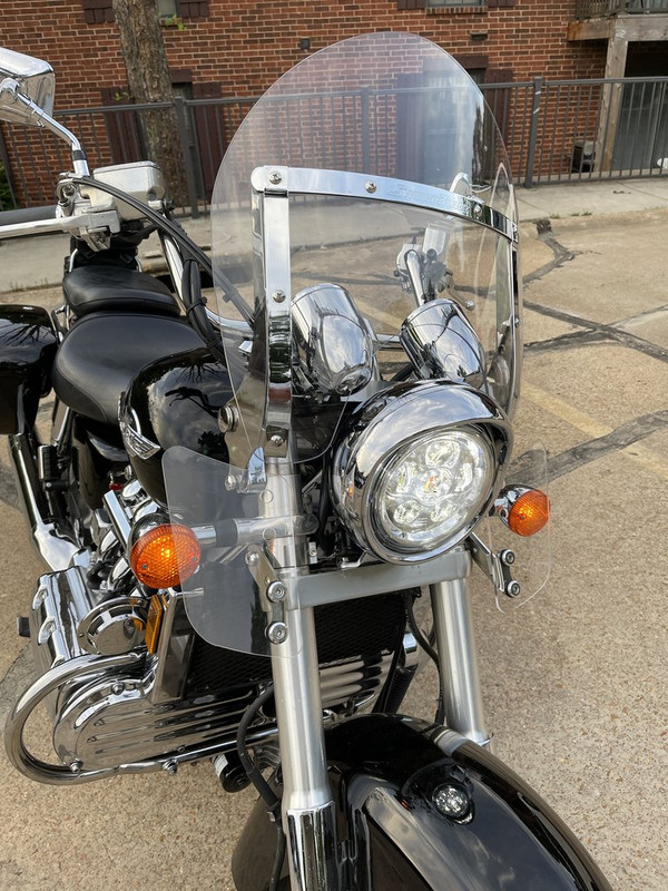

Posting a pic of my '99 Valk, hope this works!

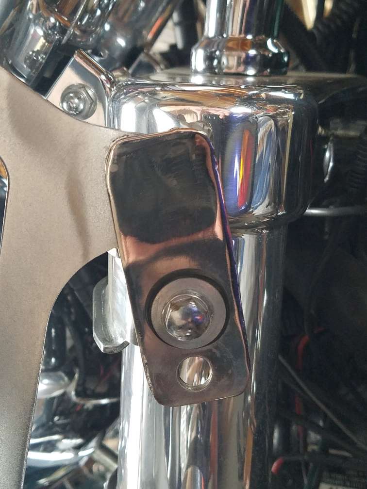

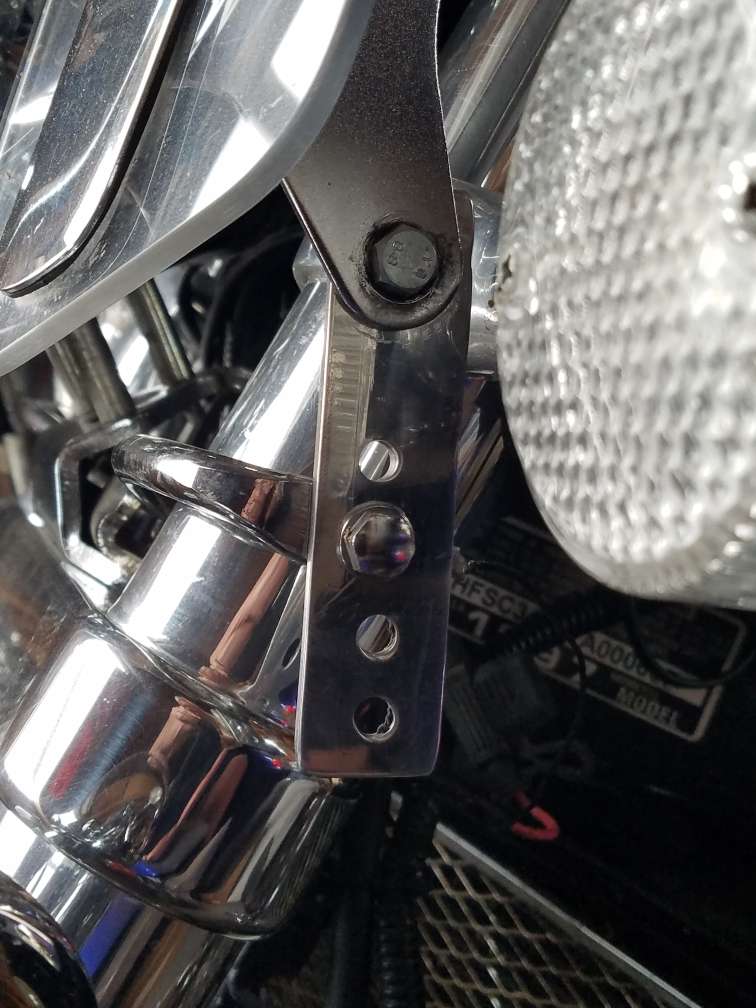

I installed a set of Memphis Shades lowers and it made a HUGE difference. So much that I probably won't be taking the windshield off this season. I was having to avoid 65+ speeds because of the pounding I was taking and now that doesn't happen.
I had to get creative with mounting, there was only one place where the brackets could go and clear the turn signals and triple clamp. Also ended up redrilling the holes in the clear plastic so I could flip them 180 to have the curved end up and make a better intersection with the windshield. I'm going to contact Motosport to see if I can get a set made without the holes pre-drilled and then I do my own to make a better fit and not have the two extra holes.
I do have more heat hitting my thighs but I can live with that. Thanks for all the comments, all of them were spot on.

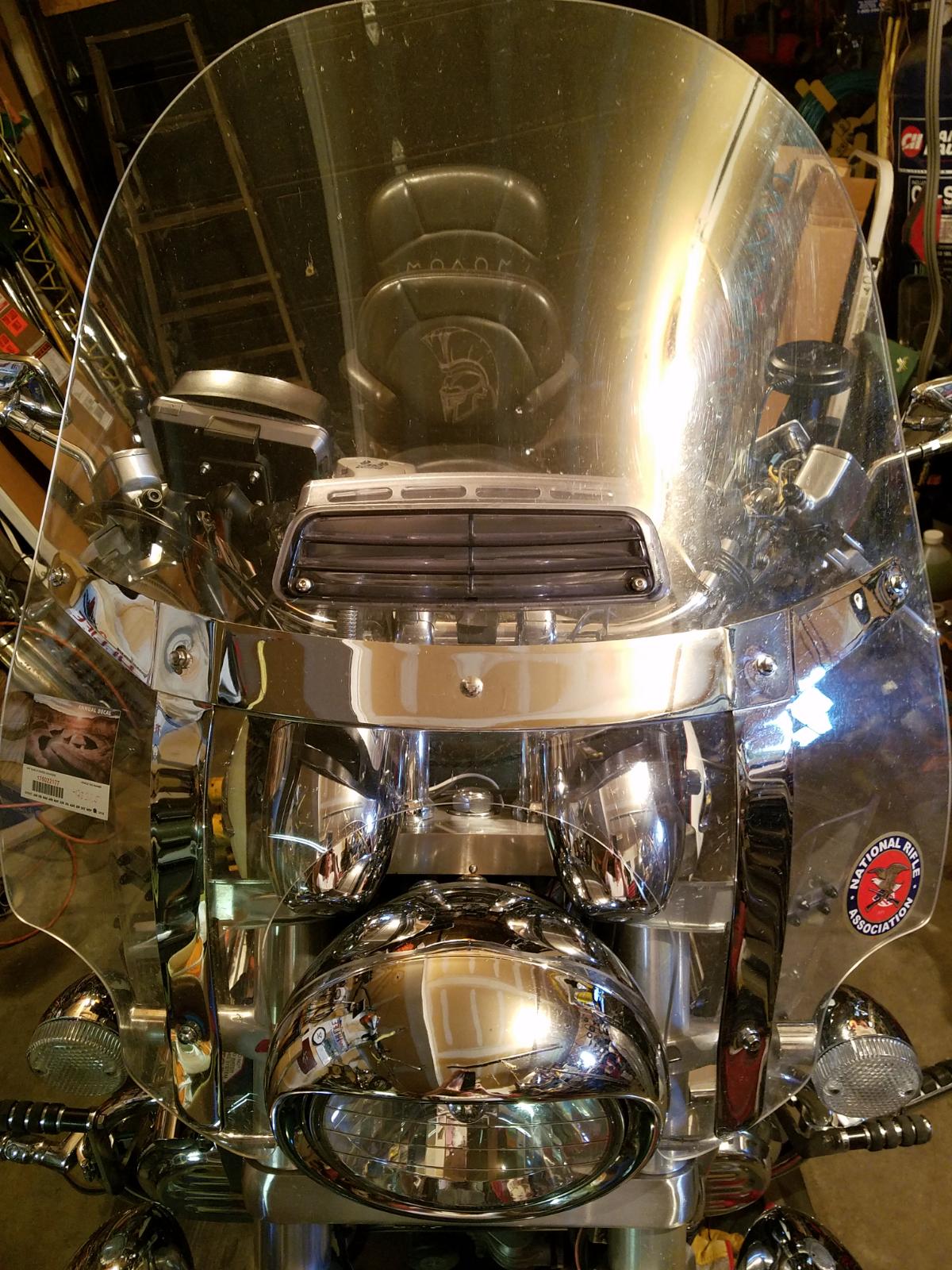

I too bought a Switchblade, because I prefer the look of my Valkyrie without a screen. I only use the screen for long, high speed trips. I chose Chopped because I don't want to look through the screen. Like you, I also experienced uncomfortable buffeting (I'm 6'2", but with most of my height in my legs). In researching it, I noticed almost all other screens have a flat top. So I cut two inches off the top of the screen (measured from the peak), and no more buffeting.
1998 Valkyrie with Cobra exhaust and optional two-tone paint
Posts: 14897
« Reply #15 on: June 19, 2021, 01:08:12 PM »
Looks like to me some buffeting may be caused by how high the shield is mounted. That’s a big hole over the headlight for air to be forced through and attack you. Maybe a taller one so you can put it down where it belongs.
Posts: 5196
« Reply #16 on: June 19, 2021, 04:21:14 PM »
The way mine works, the air coming in over the headlight actualy HELPS buffeting of your head, as it fills air into the vacuum behind the shield so air behind your head doesn't try to fill the vacuum and batter your helmet.  I have deliberately lifted my Clearview shield (with OEM hardware) and tipped it back for streamlining to make the hole bigger.  And added a vent when I ordered the shield - but it's superfluous - don't need it with the shield raised.
