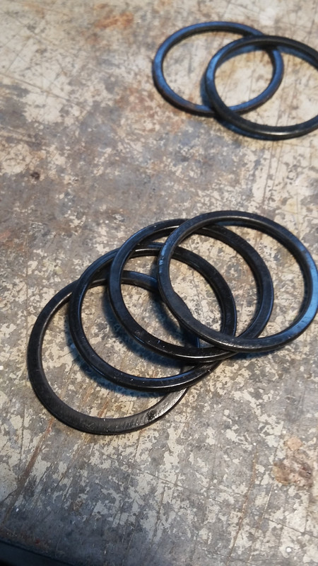

If one is bad, the others aren't too far off. Mine where hard from cooking.
Look how flat mine where. Try to twist them, and they broke. No more sealing, not soft, but rigid.
If you have any kind of staining or wet spots, then you need new o-rings
