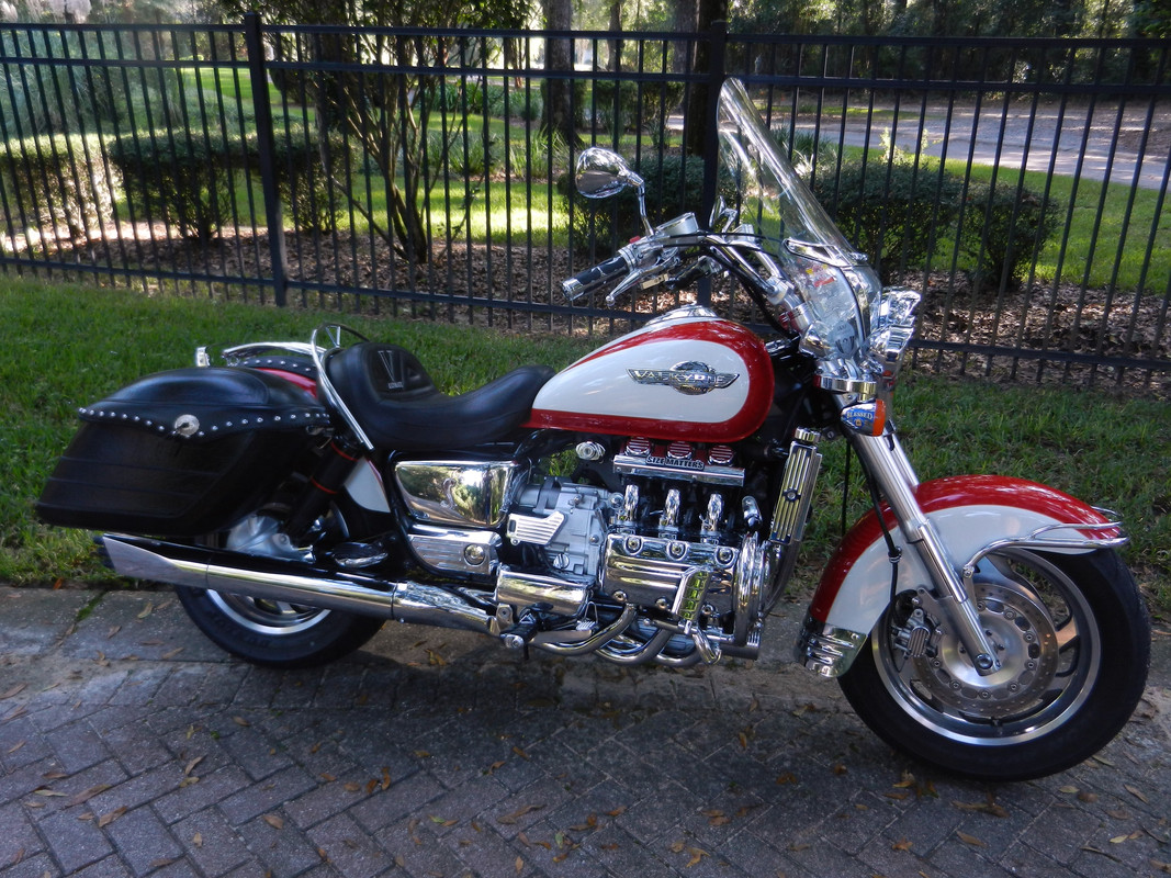

As for cleaning & detailing, I'm really impressed with Chrisj CMA.  Your bike looks better than showroom with 180K!  Unfortunately my Valk was neglected for so long (guessing it hasn't had a bath in about ~10 years) that some surfaces may never clean up.  So far, I've given it good cleaning with S100 & my electric pressure washer at 1,600 psi.  That was a good 1st step to knock off heavy crud.  I've also removed the right side bag, and about half the R/S exhaust to really get into polishing the chrome.  Working on the wheels (still on the bike) and that process is tedious to put it mildly.  Mostly using OOOO steel wool with Mothers Mag polish but even that doesn't remove the build up & oxidation.  Tried my tapered cotton buff on electric drill too.  That helps but still not enough.  For now, I'll settle for the "brushed" look but eventually I'll  Scotchbrite & sand them up through all the grits until I get to a mirror polish.  For now, I just want 'presentable' so I can get out & actually ride.  Adding it to my insurance coverage tonight after work!

Thanks  cooldude  ya she gets pampered quite often

Jeff my engine block is as clean as yours. You told me so 2funny 2funny but alas mine is just north of 130k Tongue

You have a very nice Bee that’s fer sure!!
