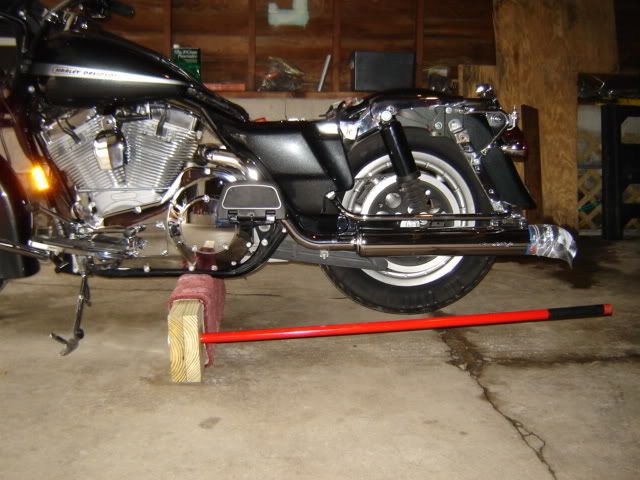

« Reply #6 on: June 04, 2021, 02:42:51 PM »
it's safe to use the borrowed GF lift. just stack something under the crashbars.
Not my pic. Another forum members' bike.

« Reply #7 on: June 04, 2021, 02:47:43 PM »
They might have jack stands.....so I can just put those under the crash bars like the picture shows?

« Reply #9 on: June 04, 2021, 03:00:02 PM »
Absolutely, you can use those under the crash bars to hold the front up.  But the trick is in the balance part while getting the bike high enough.
If your plan is to lift the bike with the car scissor jack and keep it up with the jack stands, I'd suggest getting help to balance the bike while lifting.

« Reply #11 on: June 04, 2021, 03:07:25 PM »
Using a floor jack or car scissor lift where do I put it?  I see the picture uses a a block of wood.....do I support it on the oil pan?

Posts: 6731
« Reply #13 on: June 04, 2021, 03:26:57 PM »
When I want to just lift the front end, I use a floor jack with a block of wood between the jack pedestal and the bike oil pan forward.
I set two jack stands near the crash bars, set the floor jack up in place where I can reach it while sitting on the bike, and jack it up while balancing it.
I'm able to reach around and set both jack stands in place and release the floor jack.
Takes some practice.
Been doing it for over 20 years and still am comfortable in the process.

As far as jacks I have this one.
https://www.harborfreight.com/1500-lb-steel-atvmotorcycle-lift-60536.html
I had my Interstate on it for about a month straight (lifted it then Put jack stands under the crash bars)
Zero issues stable as a rock.
I even jacked my standard for a year or so before I knew about the adapter just lifted it under the engine. Had no problems but do like the adapter better.
I am now about to purchase a J&S lift (pricey) because the one from HF is not very stable lifting the Goldwing.
Do you do this so that the rear stays down and is more stable ? I’m not sure I’m that flexible to reach down and pump the jack.
I am slightly taller than you Smiley
As stated, I do this with a floor jack when wanting to just lift the front wheel leaving the rear tire on the ground.
3 point.
But, before bike lifts became available, I would lift the front, install jacks, then lift the rear under swing arm with a 4x4 block, install 2 jacks in rear.  Works with tourers or IS.

you better stick to just the front wheel doing it without a lift jack.
Anyways, to pull the rear axle you have to get the rear of the bike above the mufflers. That'll take a stable jack. Or, you'd have to remove the mufflers to pull the axle.
Nope...only need to lift the rear tire 2-3 inches off the floor to pull the wheel. I used my centerstand to do that but a bike lift will do the same for you. I then slip a floor jack under the swingarm and pull the shocks loose. Then you can lift the swingarm up/down at will. I also remove the back half of the rear fender so when the wheel comes loose you just roll it out, don't have to worry about sliding it sideways and then dropping it 20" or more to floor level. I don't like having all that weight nearly 2' in the air. To reinstall the wheel I just roll it in and only have to lift it an inch or two. Then slip the axle in place clear through to the left side without the spacer and brake mount. Then you don't have to lift and fight the weight of the wheel while meshing the splines...it just slides to the right and into place. Then pull the axle out slightly to insert the spacer and brake mount and bolt it all down in proper order. Never have to touch the exhaust.
  • I then slip a floor jack under the swingarm and pull the shocks loose. Then you can lift the swingarm up/down at will.
Agreed. I wasn't meaning to lift the bike 2-ft in the air. Just state the general idea for Malkozaine's level.
I use a scissors lift under the swingarm. Use to use a ratchet strap.
Anyways, removing the rear wheel has enough of it's own quirks.
Malkozaine, I suggest you start a new thread on lifting the rear wheel ..... with or without using a regular lift jack.
