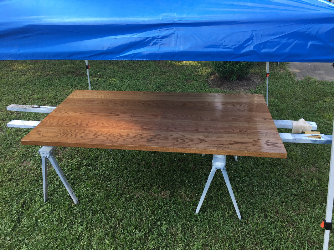

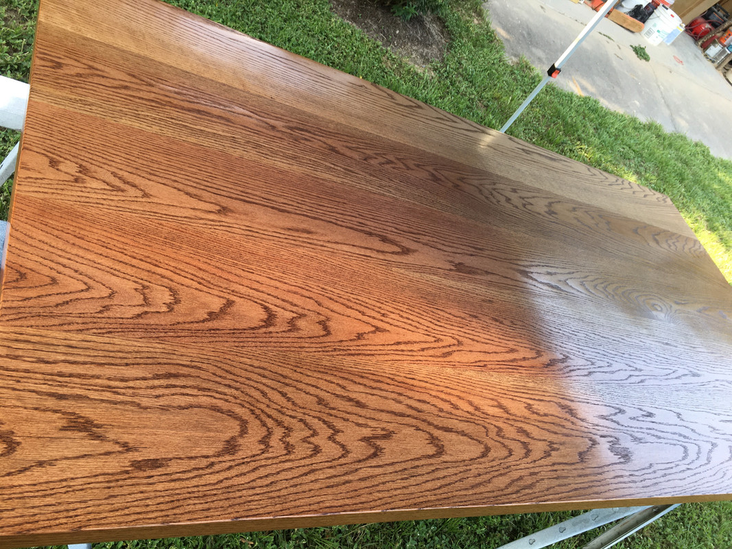

I keep getting these orders for huge and heavy stuff. An 80”X42” solid red oak table top. Weighs about 300 lb. there’s no planer big enough so it’s hand sanding. I’m covered like an abominable snow/sawdust man.

What kind of hand sanding? When I glue up stuff like that (not
that big) and sand it with my random orbital sander the top is
nice but "not all in the same plane"...

« Reply #2 on: June 11, 2021, 12:01:30 PM »
A random orbital after a very aggressive angle grinder sander and a long level to keep checking for high spots.

« Reply #8 on: June 11, 2021, 12:22:11 PM »
That's going to look beautiful when finished.
Oiled or stained?
Posts: 14933
« Reply #9 on: June 11, 2021, 12:40:16 PM »
Oiled or stained?
Light stain and a few coats of hand rubbed tung oil

What did you do to join the pieces?
I cut captured 1/2” grooves the entire length of each mating surface and made long spline biscuits out of 1/2 plywood and 5 gallons of glue. I think it’s pretty strong.

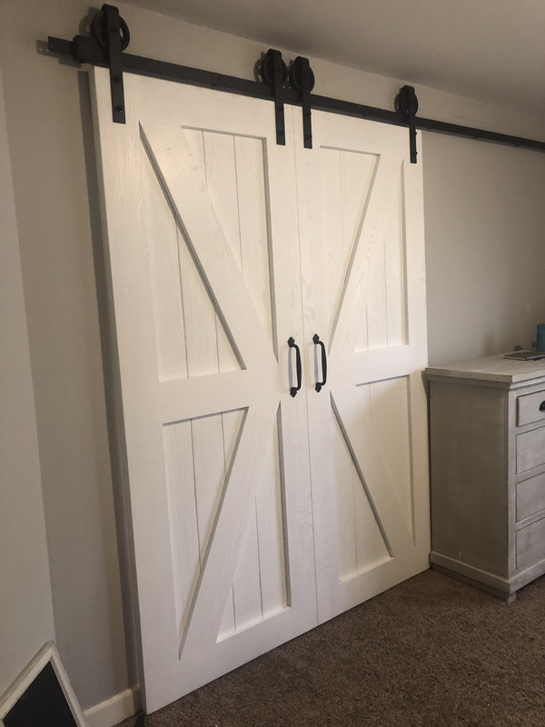

Ya, Bretshim I made one of those big heavy doors last time. This is one door made to look like two. Was a beast!!!  Solid Ash. The frame was solid 1 3/4”. Hand cut lap joints weren’t fun.
5 gallons of glue  Grin
That's a nice looking door! I like that style.. I'm partial to big wooden doors, beams etc., and I like the look of iron along with it  cooldude
Bet that one weighed a few pounds  cooldude

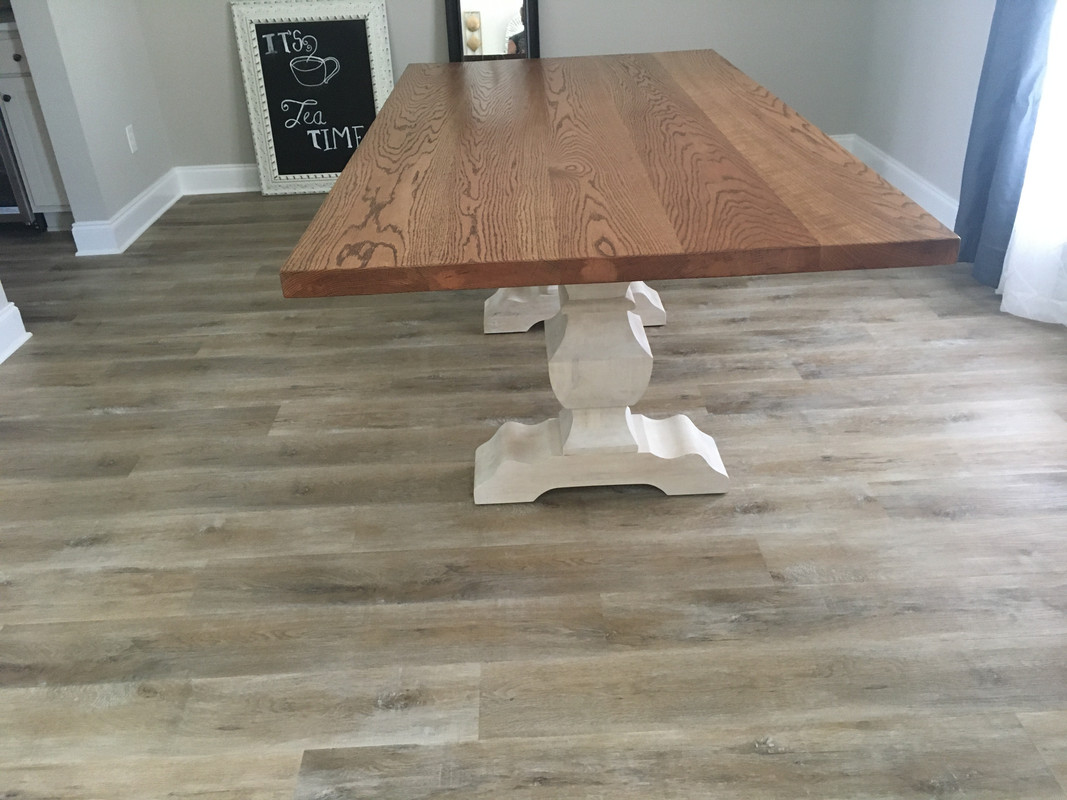

« Reply #17 on: June 18, 2021, 04:23:47 AM »
Stain and hand rubbed tung oil complete. Now I just need to put a whitewash finish on the two pedestal bases.

« Reply #18 on: June 18, 2021, 04:58:18 AM »
Beautiful! Nice work!

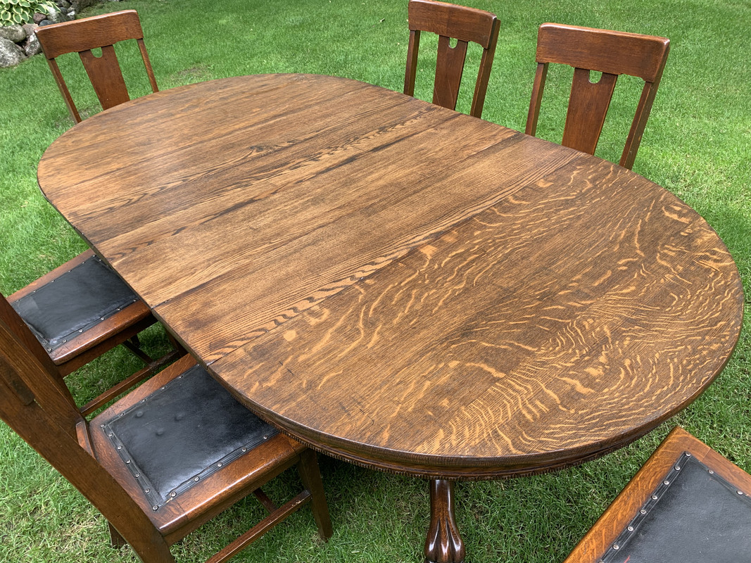

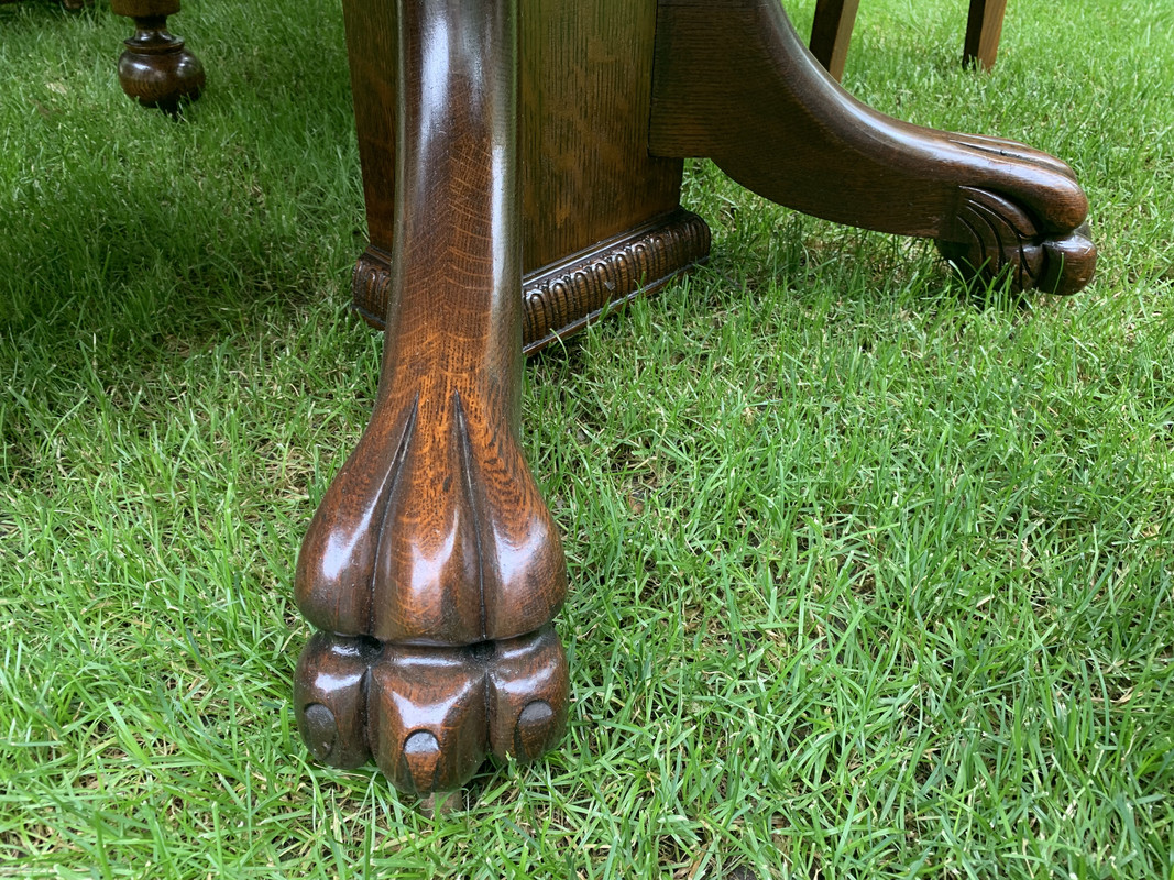

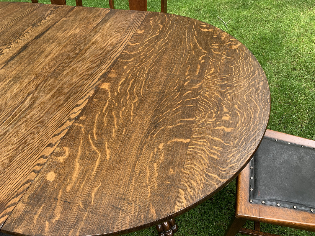

Well, I do not have the talent for creating furniture. . . I can restore it:
Just finished, 100 + year old oak
« Last Edit: June 18, 2021, 05:07:17 PM by Oldfishguy » Logged

Nice, I love that “tiger” like grain
Thanks, but those of us that do this kind of stuff know there is a big difference in talent from creating to restoring.  I have a neighbor friend that was a finish carpenter for a decade or so and he has done for me absolutely fantastic creative work over a few decades now.  I am a butcher carpenter compared to folks like you that make stuff from scratch.

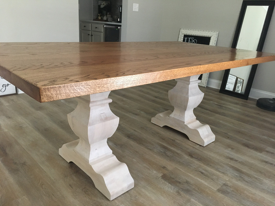

I finally got the bases for the oak table project. They will get whitewashed and a light coat of low gloss polyurethane. I’ll send more pics.
They are a bit fancy but I didn’t choose them

« Reply #28 on: July 12, 2021, 02:11:50 PM »
Ok so bases are whitewashed and attached. Table delivered. Customer happy. I’m exhausted. lol
