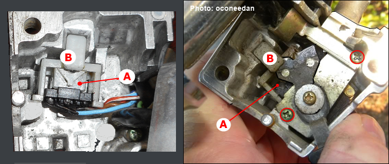

Only thing I"ve ever messed with on that circuit is the turn signal switch itself, cleaned it and re-lubed it.
  • It does kinda catch when I hit left signal.
I don't know if you took the movable contact apart (A). Just pluck it out of its holder (B). There are divots molded into the holder (red dots). The ball on the movable contact drops into the divot accordingly. The ball is sprung and should have free movement.
You have to remove the thumblever plate to get to the movable contact (bottom right pic). IMHO, you're suppose to push the thumb lever in to cancel. Push in.
 Could the switch itself be grounding out somehow?  If I take it back apart would I see obvious sign it is shorting out?
