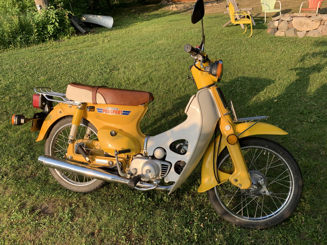

Yes, and then . . . no.
I rejuvenate old Honda’s from time to time and therefore have a love/hate relationship with carburetors. I picked up this 1981 Honda C70 Passport a couple weeks back; I’m guessing it was parked 30 years ago in a nice dry storage someplace. I did all the normal things one does when resurrecting a machine. I did my normal tricks on the fuel system as well, twice actually . . . and it ran great, then not, then great, then not . . .
So, I ordered a new Chinese knockoff carb for $28, and then it ran great again. Then not.
The new Chinese carb is running great now.

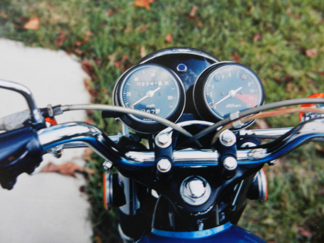

I bought a 1973 Honda CB 175 in 1999. Ok the add said great condition does not run $200
I had to go look. So visually it only had two issues. One spark plug wire was buggerd up and the tail light lens was cracked. So I took it home. Surprisingly the tank was spotless inside and the spark plug wire just needed a half inch cut off and reconnect the boot. They were the old type with a spike inside and you jam in on the wire. Bought a new battery and tail light lens and off I went. But I only got one mile.
So there was a pile of Honda dealers receipts from day one for the same problem. This bike never went more than one continuous mile in its whole life.
I checked everything I could think of and the more I took apart the more I was amazed. This was a brand new bike. Everything was fresh and clean, no rust, no messed up screws. But at the end of a couple days it still would go past one mile with out dying. I rode with the tank open. I was not going to give up so I removed the carbs again.
That’s when I found the problem that eluded Honda dealers for over 20 years. These old carbs have a hole drilled into the side with a metal tube stuck in it it. Just looks like a post. But it’s actually the vent.
So I got a mirror and looked in from inside the carbs and I found both holes were clogged with the metal sliver created when the hole was drilled. I used a curved dental pick to remove those slivers and the bike was fixed.
Now here’s the part that fixed itself.
So I get this little beauty out on the road. It runs great but has no power. A slight headwind and I have to downshift. So I recheck timing, valves. Cam chain. Add some gas treatment. No improvement. However, after a couple more days I feel an increase in power. Every couple days a little more power.
Then it hit me. This bike is almost old enough to be an antique and it’s just now breaking in.
Finally it reached full power all by itself and I rode it every chance I got. To be honest it didn’t feel as small as it was and I didn’t care if I looked silly. It was a fun bike.
I ended up selling it when I bought the Valkyrie, a friend begged me to sell it to him so I did for $600. It’s the only bike I sold that I regret selling.

Great story!  And an even better fix it story!
Just to make you feel worse about selling the machine . . . Low mileage original machines like that have escalated in value recently, like a lot of toys.  In todays market I'd say it would bring $3000, more if on either coast.
