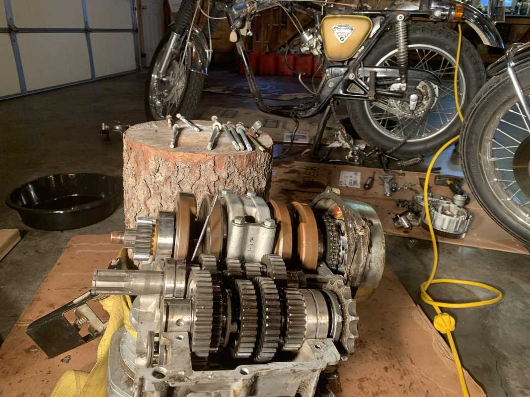

I spent a few weeks last winter inside a 1971 Honda CL450 transmission.  I moved it in to my house workshop from here and played with it for a few weeks diagnosing a problem (bent shifter fork).  The fork was probably only bent 1/4 inch but that was enough to cause it to pop out of 1st when I got on it.  The shifter forks sit under the gears shown and move the gears from side to side depending on what gear the rider selects.
I could sit and run through the gears on the bench; fun to play and learn from it.
That is cool, I love the tree stump!
The engine is strapped to the stump, upside down. And the bolts are laid out in position of removal. Sometimes one just has to make do with what is on hand; I do not plan on ever being in that transmission again. Hopefully.
I long for the day when I can have my own shop on a big enough property where I can build whatever buildings I need or want. That stump in the photo really reminded me of what I don't have living in plastic banana land among the rich and not-so-famous in California.
