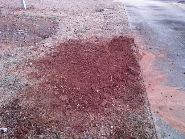

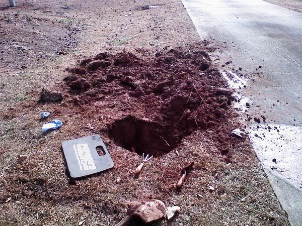

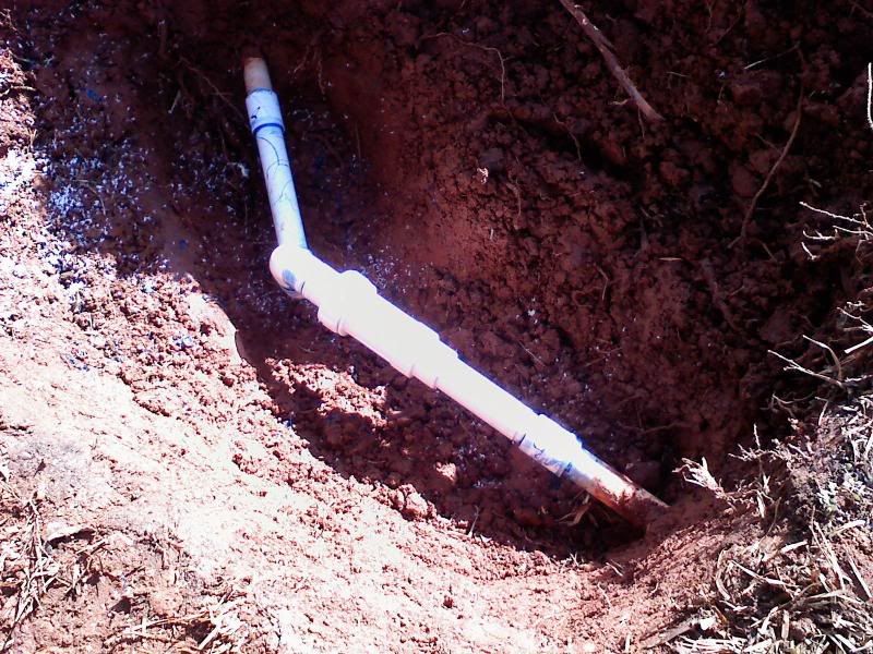

We had very little snow last night as a cold front blew through Georgia...some areas around North West Georgia had a little snow.....and ice.....we had a few icy spots here in Athens.....

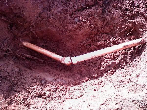

As I was backing out of my driveway to go to work, I ran across an icy patch and then noticed an area about 6'x6' was bulged up almost a foot off the ground.....with water running across the drive.... Sad......it was 25 degrees and I knew that I had a leak in the waterline somewhere??....Hummmm....I cut the water off at the meter, cut the power to the hot water heater, told the Wife NOT to use any more water, and then headed in to work to spread de-icer on entrances to the County Govt. offices before taking the rest of the day off to come home to fix the leak.....normally, if the ground hadn't been frozen, I'd have had an easy time finding the leak....unfortunately, I knew it was going to be a royal PIA to find the broken pipe and I wasn't wrong.....I started in the most likely spot and then began following the "water trail".....I'd dig a while, turn the water on long enough to keep following the water trail....8' later, I finally found the actual leak as muddy water blew out all over my coat and pants...the temps had fallen to 20-22 by then....

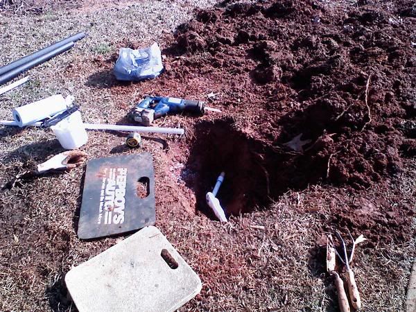

I had bought some new Christy's Hot/Blue PVC glue on the way home...I use that stuff for my irrigation projects..it's a lot better than the stuff you get at Lowes....well, I also bought some replacement parts and pipe and started fitting it all back together...waited a couple of hours for it to dry, then covered it all back up....I am keeping my fingers crossed that it doesn't break again....Last weekend was the broken heater, and now the water....I'm ready for a little of that Global Warming...you guys up North and West can keep your cold to yourselves.....pretty please??!!.... cooldude

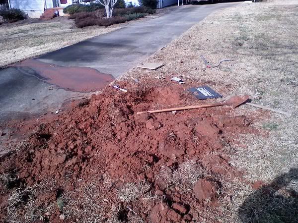

It wasn't too hard to dig in since the water had been running into the ground for a while....only the uppermost portion was frozen since we've been in the 20's for lows all this week....if the ground hadn't been frozen in that upper couple of inches, it would have most likely have been leaking right above the broken pipe....
The waterlines here in Georgia are usually copper coming off the meter for just a couple of feet, and then PVC up next to the foundation where it goes back to copper pipe.....it makes it a LOT easier to repair that way....and most are only buried about a foot deep, like mine is....this house was built back 20 yrs ago in 1989 and as far as I know, this is the first time it's ever broken.....this is the longest "cold" spell we've had in as long as I can remember....We just don't normally get low temps in the teens and low 20's for this long of a stretch.....
I was lucky I was able to fix it myself...a simple repair once you actually FIND it.....it still cost me 6 hrs of my vacation time since this is the week we started back on a 5 day workweek.....I just had to get it fixed so that the Boss can take her 1o minute shower tonight..... cooldude.. Cheesy... Grin

Water under pressure hates to go through a multi-piece
coupling like the busted one in Stanley's picture.
