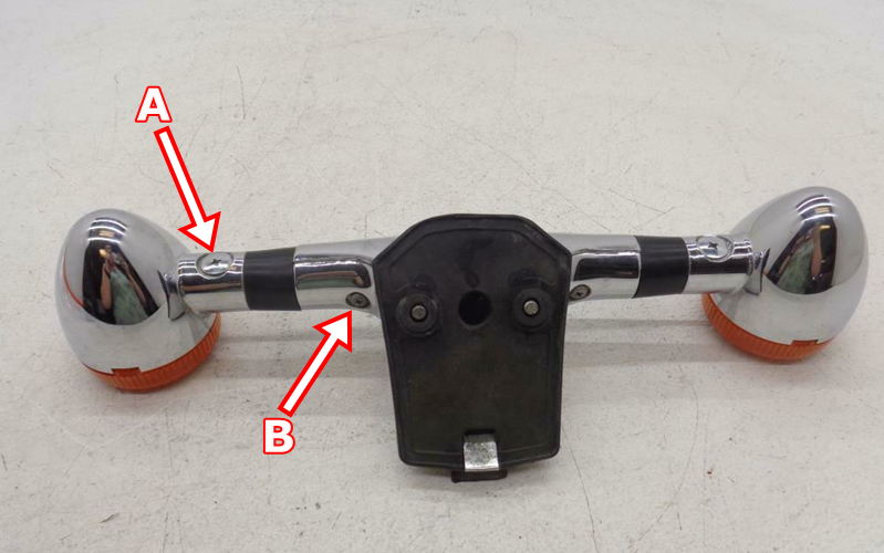

are we instead talking about Screw A or Screw B, below?
Screw A is only on turnsignals with a two-screw lens cap, older version. It's a special extra wide pan head with a shoulder on the threads (second pic.)

« Reply #5 on: August 22, 2021, 10:26:36 PM »
Screw a.
