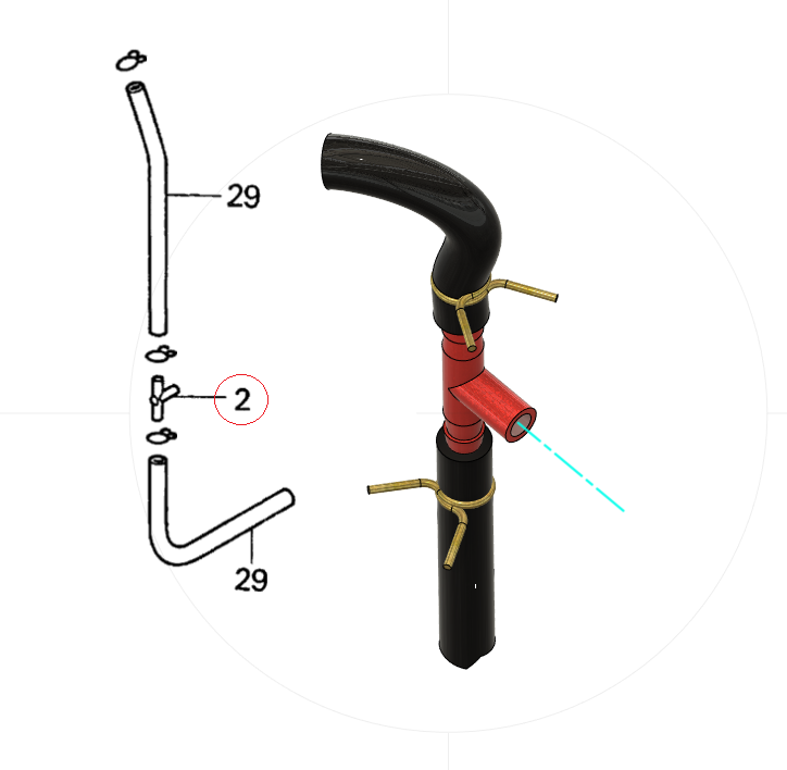

Seriously, though, it should be hooked to a long hose that runs behind the center cover (in front of the battery) and exits near the side stand.  It has a plastic "T" in the center that prevents rainwater from being drawn upwards.

« Reply #2 on: September 04, 2021, 12:06:37 PM »
Here is a parts diagram pic of it. Parts 2, 28 & 29.
Free download of Service manual here:
http://www.valkyrienorway.com/download.html
Download the service manual, and you can search "Fuel tank breather Tube." You will find 9 references and drawings showing routing.
The Tee is hard to find in the manual, but as mentioned earlier it is critical to keep water from sucking into the tank when riding in the rain.

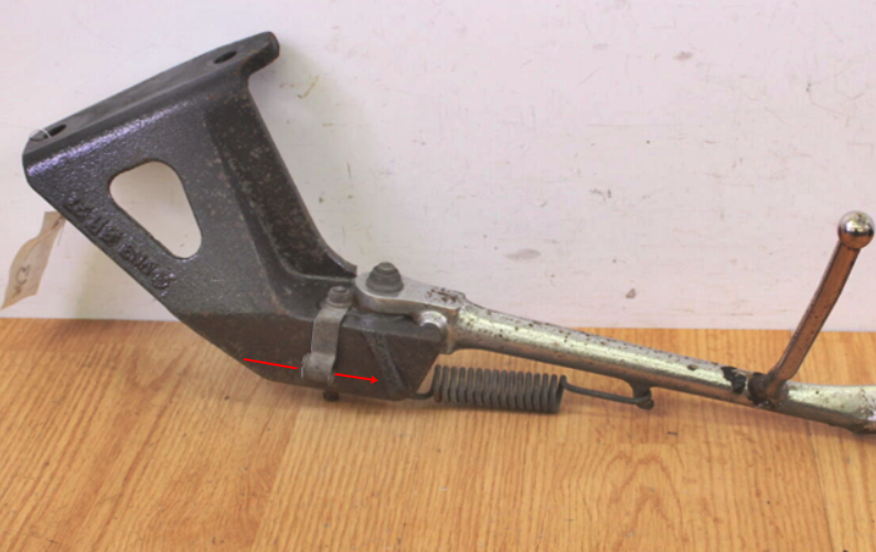

« Reply #6 on: September 04, 2021, 04:13:21 PM »
As said, leave the T open. The end of the tubing gets clipped to the kickstand bracket. The clip is on the *front side* of the kickstand bracket.
****[edit] the vent tube gets routed like this.
