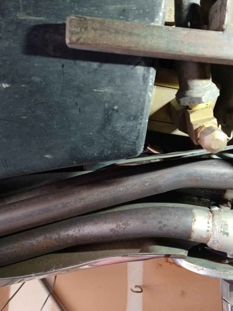

I wonder what R&M actually delivered.  It's supposed to be a 3 gallon std belly tank.  But measuring the fuel actually delivered, it's 300 oz, 84oz less than 3gal.  That's 2 gal 1-3/8 Qts. or 2.34gal. - 22miles short of what I paid for at my avg of 34mpg. Total fuel is 9.24gal including the Interstate tank. I NEED lotsa fuel when pulling my Timeout camper; mileage is tanked. I think I got screwed by R&M; guessing they had only a Cobra-compatible tank so "forgot" to tell me what they substituted.  Josh, what's the width measurement of the front of your tank?
But on the other hand - maybe not.  Here's the left side of the tank next to OEM exhaust (actually with my M2W mod - but the headers are the same.)  Some space on this side, over to the headers.  That might be enough space for 2+ more qts.

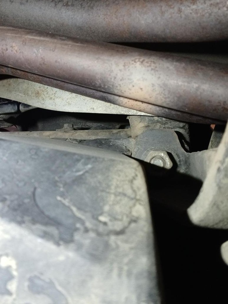

and the right side.  Less space here - note the heat shield I added to protect the fuel pump.
