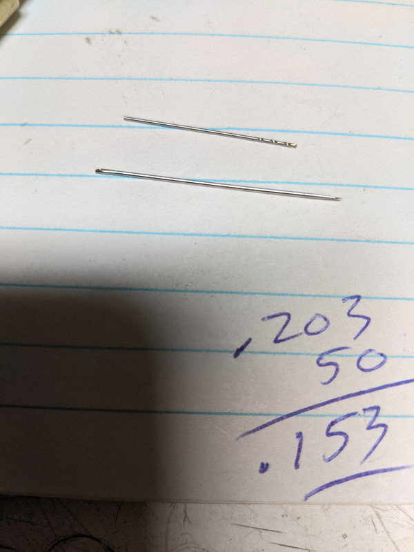

I hate ordering $hit!!!!!!!! My restrictor came today and the orifice is supposed to be .0185.....and it is .035, plus the blister pak had been opened, mutilated and taped back together.....ARG!
Bagger John - #3785
Posts: 1951
« Reply #34 on: October 14, 2021, 03:43:43 PM »
I'd be filing a claim with the vendor. Curious why that one got through, but given the quality of staff these days nothing surprises me.

« Reply #36 on: October 15, 2021, 08:03:59 AM »
I bought it from amazon....die a return because the wrong part was shipped and amazon said they will refund my money and to not bother to ship the part back.... So, yippee, I have a part I cant use.  So went to  autozone and and they have the same part....035 size orfice...think I will just go get some jb weld and find something about .020 in diameter and see if I cant make the right size orifice.  Glad I am retired.. 2funny
Get a Dremel, a small number drill (80 through 83 or so), a piece of brass rod that'll fit snugly into a 3/16" or 1/4" double-male barbed fitting and make your own.

« Reply #37 on: October 26, 2021, 04:50:54 PM »
Well.....finally decided to follow Bagger Johns advice and make my own. Piece of 3/16 brass rod, a .108 drill to drill in from both sides and leave about a 1/8 inch section to drill through with .0185 (#75) drill bit. Buy at least two of those little buggars.... crazy2   Length of the brass piece is about 1.4 inch.
Hope to get some time to soon to do another vacuum video before and after.
Here is a pic of the .0185 drill and the smallest needle from my wifes sewing box....

Here is the final restrictor installed with a .018 orifice....a bit smoother than the .027 orifice.....
