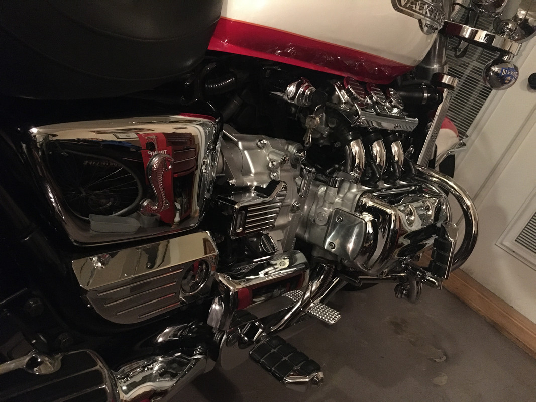

Put the bike up on the lift to do a good cleaning. Well, every time the bike is up in the air I check the rear wheel bearings. Always good but good to check. Not this time. Click click click. So it’s tore apart and I’m at autozone renting a slide hammer. Here we go. Hope it goes better than last time!!!!

Finally got the bearing changed. It was quite an adventure with the tools. They didn’t work and was broken. So I had to fix the bearing extractor and find an alternate way to tighten the jaws but I adapted and overcame. Now just to put the bike back together. That’s the easy part

All back together just in time to ride tomorrow to help with another Valkyrie. Complete rear end service all three Orings drive shaft oil seal thrust washer, final drive oil and most importantly no more tic tic tic!!

But the adventure is over and it’s off the lift ready for service again
