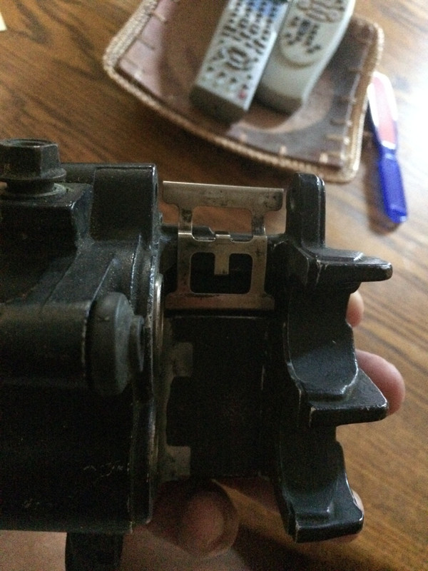

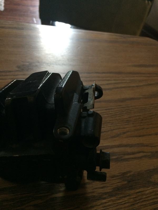

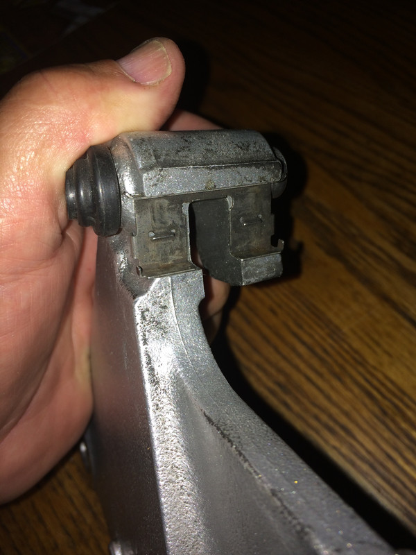

Posts: 14918
« Reply #7 on: October 11, 2021, 03:20:29 PM »
Ok three pictures

« Reply #8 on: October 11, 2021, 03:40:39 PM »
Wow, thanks now I understand. The clip I hVe is flat so it is either bent or the wrong one. Thanks for the pics.

Posts: 14918
« Reply #9 on: October 11, 2021, 03:43:05 PM »
If your spring is flat and a bit smaller it goes on the caliper plate. Would you like those pictures?
Posts: 14918
« Reply #10 on: October 11, 2021, 03:49:20 PM »
Two pictures
I have installed this spring without removing anything. Let me know if you need help. It can be done
