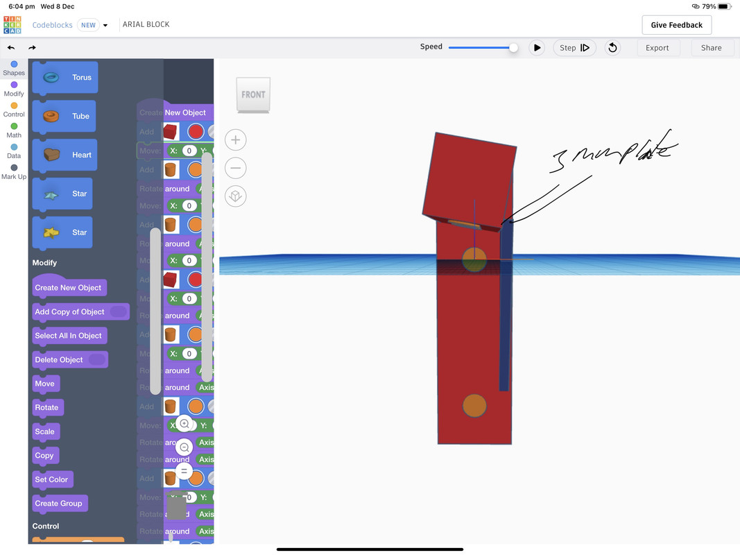

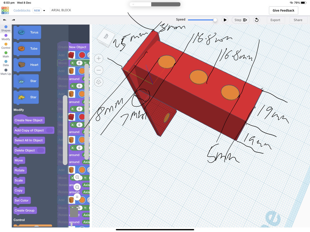

Grey Wolf, where you gonna mount your antenna when you super valk. I’m thinking about that too… wondering where to put the mount and what mount to use.
Hi Spurliner
On the back right of the sissy bar mount screws
Using the original arial trunk mount on to the bracket that i am getting made out os 316 ss
The standard arial mount to the trunk base covers the three holes on the top
See mock up
“ edit “
I made a few changes and corrected a couple of transcription errors from the mark up
« Last Edit: December 08, 2021, 01:42:54 AM by Grey wolf oz » Logged

What sort of antenna are you going to use with that setup?
FWIW, Clarion (Hondaline) offered a Standard/Tourer CB antenna kit which uses a non-removable but foldable center-loaded whip and a mount which fits up exactly to the right side OEM sissy bar/rack hardware. The antenna is the same as used on the GL1500/1800 'Wings:
Just the standard trunk mount !! As it will bolt straight on top of the three holes.

« Reply #12 on: January 03, 2022, 11:54:06 PM »
Hi Spurliner
See mock up
“ edit “
Finished
Arial mounted

« Reply #13 on: January 06, 2022, 07:11:42 AM »
That's a nice, clean mount.
Can they be produced in quantity and another made for the opposite side of the sissybar? I've an idea for this...
Grey wolf oz
Posts: 163
« Reply #14 on: January 07, 2022, 02:25:09 AM »
Hey John,
I made this out of scrap,  i dont like the angle i have ended up with so will remake it and get it chromed
Also i think its simple enough 3/4 square tube and 1 inch by 1/8th flat bar
I will however update the measures as the 3/4 tube is shorter than intended
