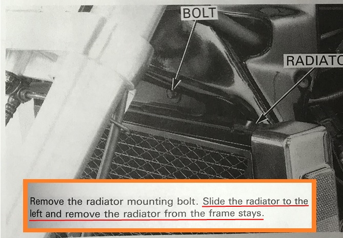

Hey there, I’m a new Valk owner, 03 standard black and chrome so far it’s been a beautiful ride. Upgraded from a 96 Magna (very fun and nimble bike). Been doing some work on her checking things over (new fluids, tires [ME888s])

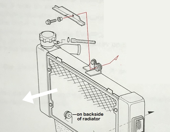

I’ve noticed my radiator is crooked and upon further inspection it seems there are pins on either side at the bottom of the radiator that slide into a bracket on the frame. Neither of these pins is in the bracket and the only other thing I can see holding the radiator on the bike is a small bolt up top. I’d like to see how this is all put together and a shop manual seems to be the way to go.
I’ve seen people redirected to ValkyrieNorway for the pdf manual but the site seems to be down. Does anyone have a copy they can send me via email or something? I’d like to have the factory version of how things are supposed to go, torque values for everything without having to scour the forum or bug everyone with another post every time I have a question

The manual states the radiator is held on by a single bolt on the top of the radiator as you assessed ..... in addition to two stays on the bottom back edge of the radiator. It's a similar situation to my other bike's radiator. I haven't fumbled around with the Valk's radiator.
Two stays on the bottom back edge of the radiator lock the radiator to the frame.
